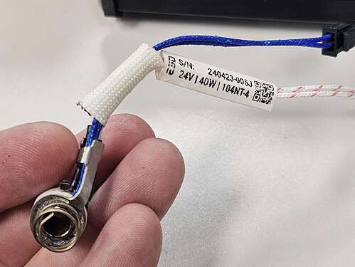

The new nozzle has been installed to the Hermes printer, though it seems that it’s having issues heating up the nozzle. I’d recommend troubleshooting the heater if anyone wishes to dive into it before I try again.

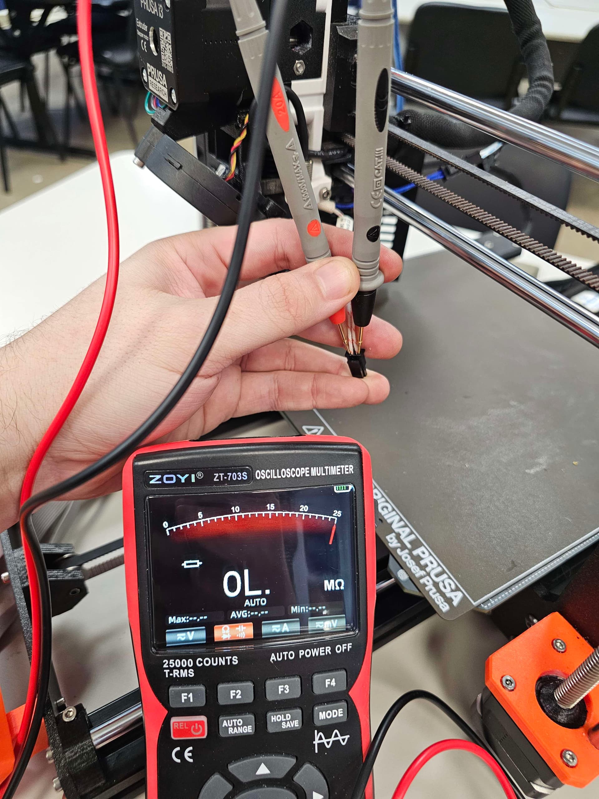

Tested the heater at the connector and it reads as zero ohms, when it should be close to 14.8 ohms, I removed the hot end from the machine and tested at the heater pads and still found zero ohms, which means the Revo heater core is dead and it’s unfortunately not just a failed wire or connector.
