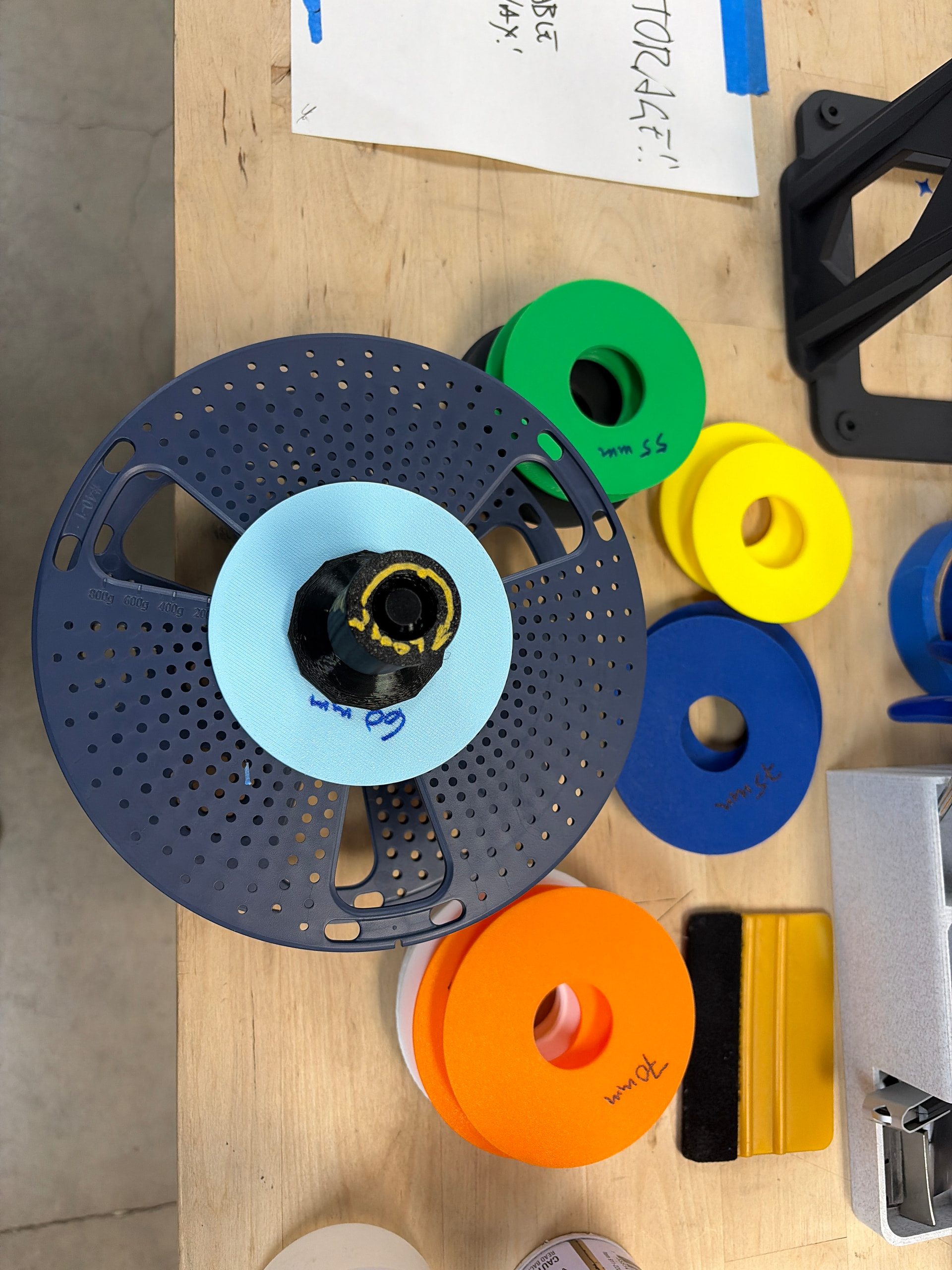

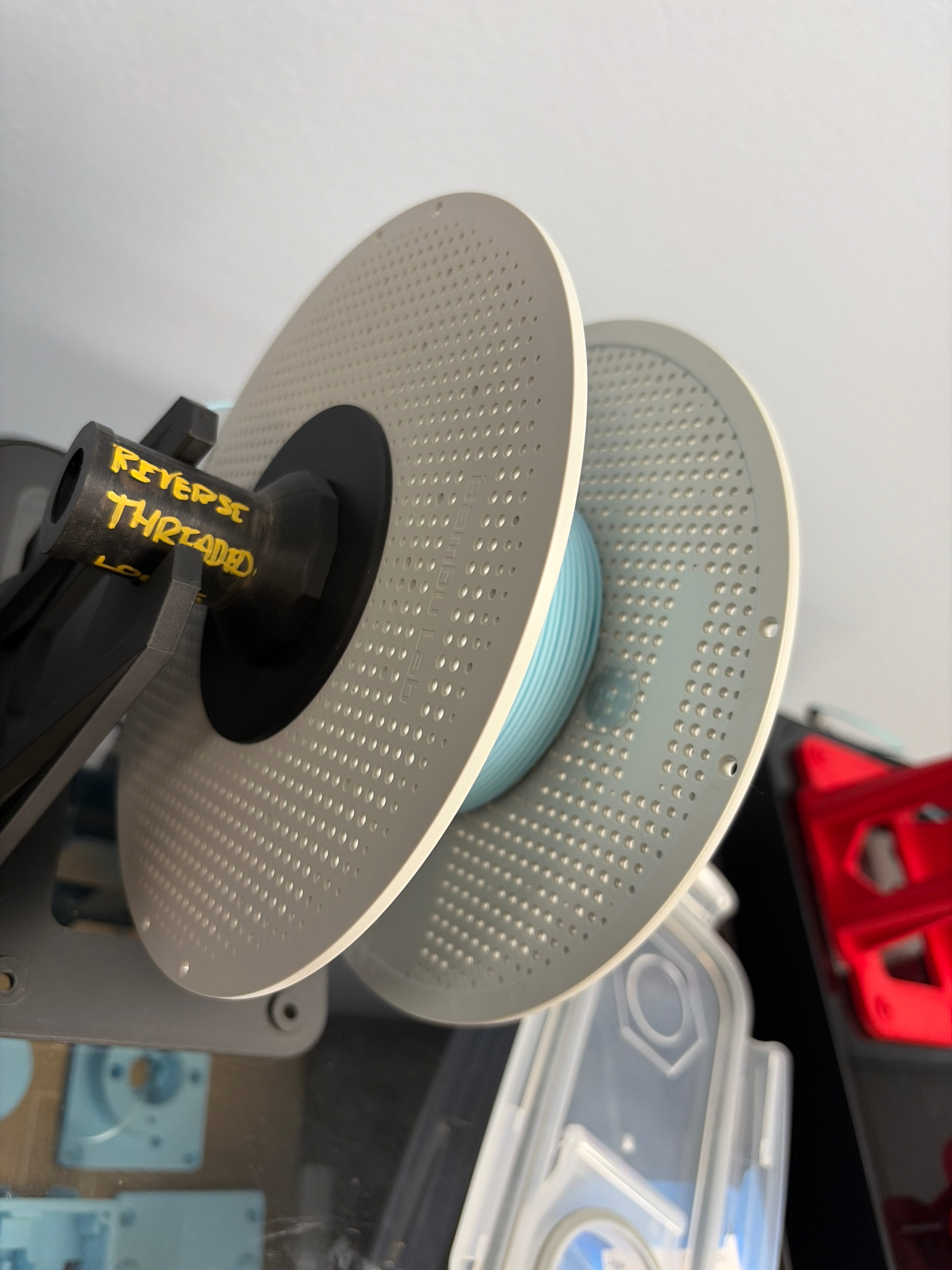

If you’re using the spool holders, please be aware that the screws on them are reverse threaded so that they don’t come loose as the spool rotates. You can snap the axle by over-tightening it (ask me how I know).
Also, they’re designed to use different sized spool centering discs depending on the spool you’re using. Bambu and PolyMaker spools use 55mm discs, but other manufacturers use different sized holes. There are a variety of sizes on the respooler table.
