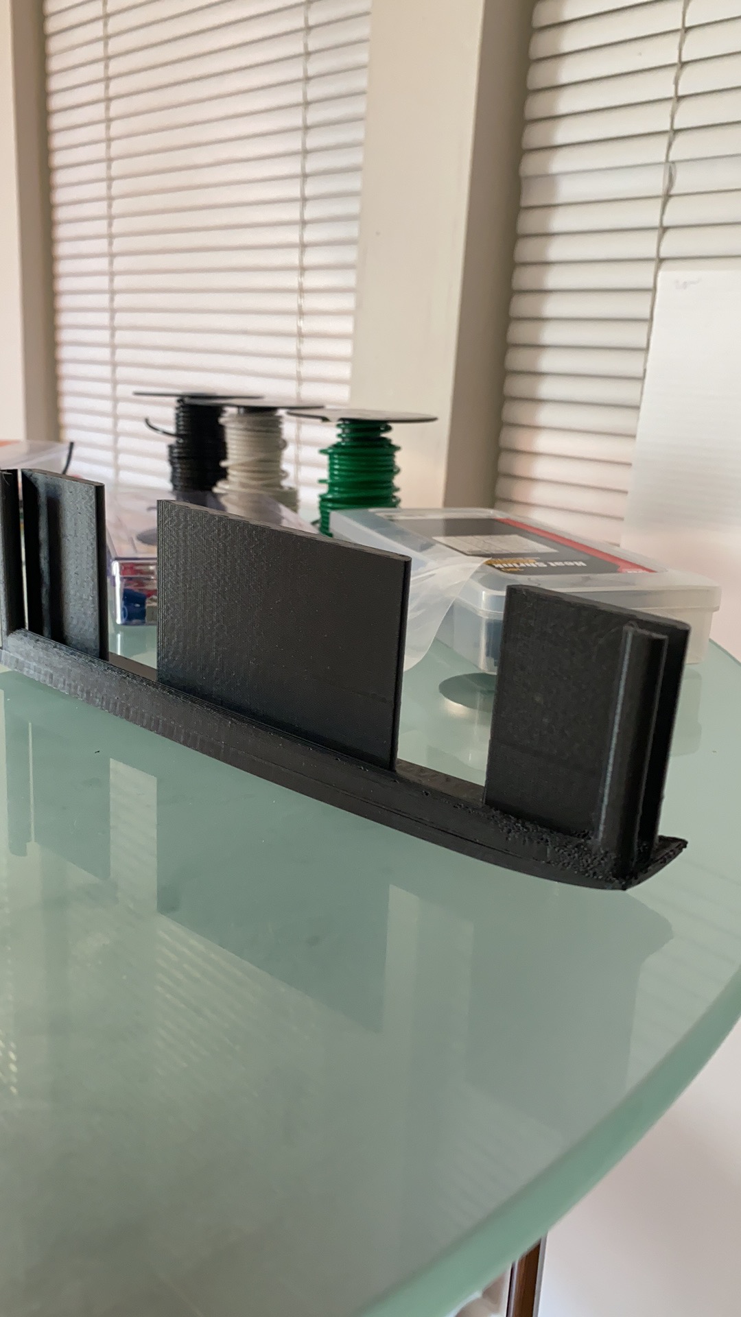

Notice the right side is not on the ground. The first layer was only half sticked on the plate. I did several print on it; no success. I think this is SunWuKong Prusa 3D printer. The Prusa on the most left of the cabinet didn’t print at all after loading the code( it kept calibrating itself). The one in the middle did terrible first layers that was deformed on the surface.

What material is this?
PLAs; The black rolls that are already in the cabinet
Looks to me like the bed might just need to be cleaned, and given the pointy corners you might want to consider printing with a brim or “mouse ears” to prevent warping.
@pearlgreymusic do we recommend isopropyl alcohol to clean the beds?
More generally, it looks to me like you may have some minor underextrusion issues as well.

Cleaning the bed before a print is a pretty standard practice, especially in a community shop. Not sure there’s much to look into other than cleaning them and trying your prints again, maybe checking your print settings to make sure your flow rate isn’t wonky.
IPA is my favorite way to clean off printer beds. It does a great job of handling garden-variety oils and residues, and it has a much lower risk of killing electronics if it splashes somewhere it shouldn’t, and it dries itself up almost instantly.

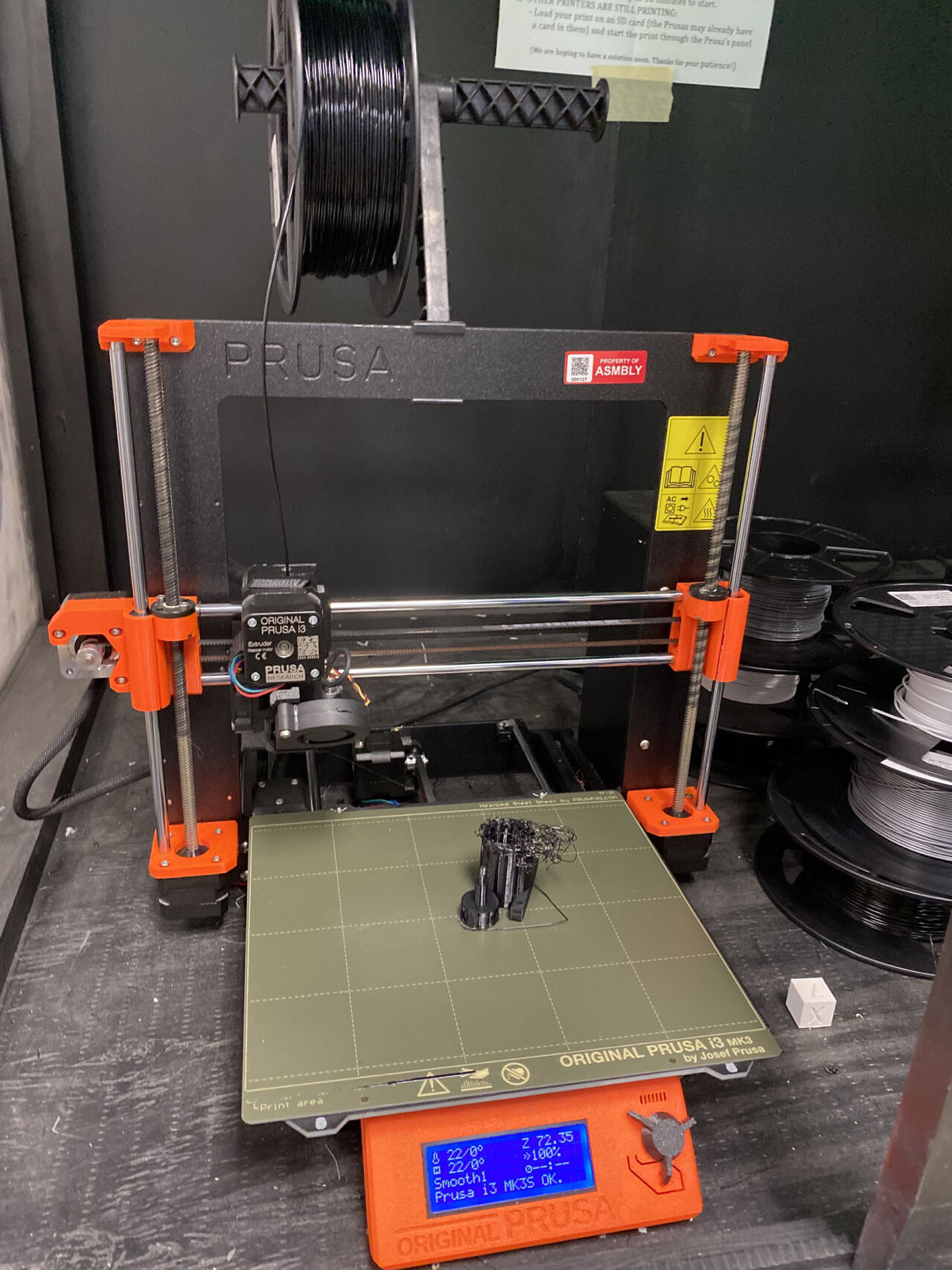

Is this yours? This was the same issue I had with Apollos last week…
Your other print with Hermes looks like is a success.

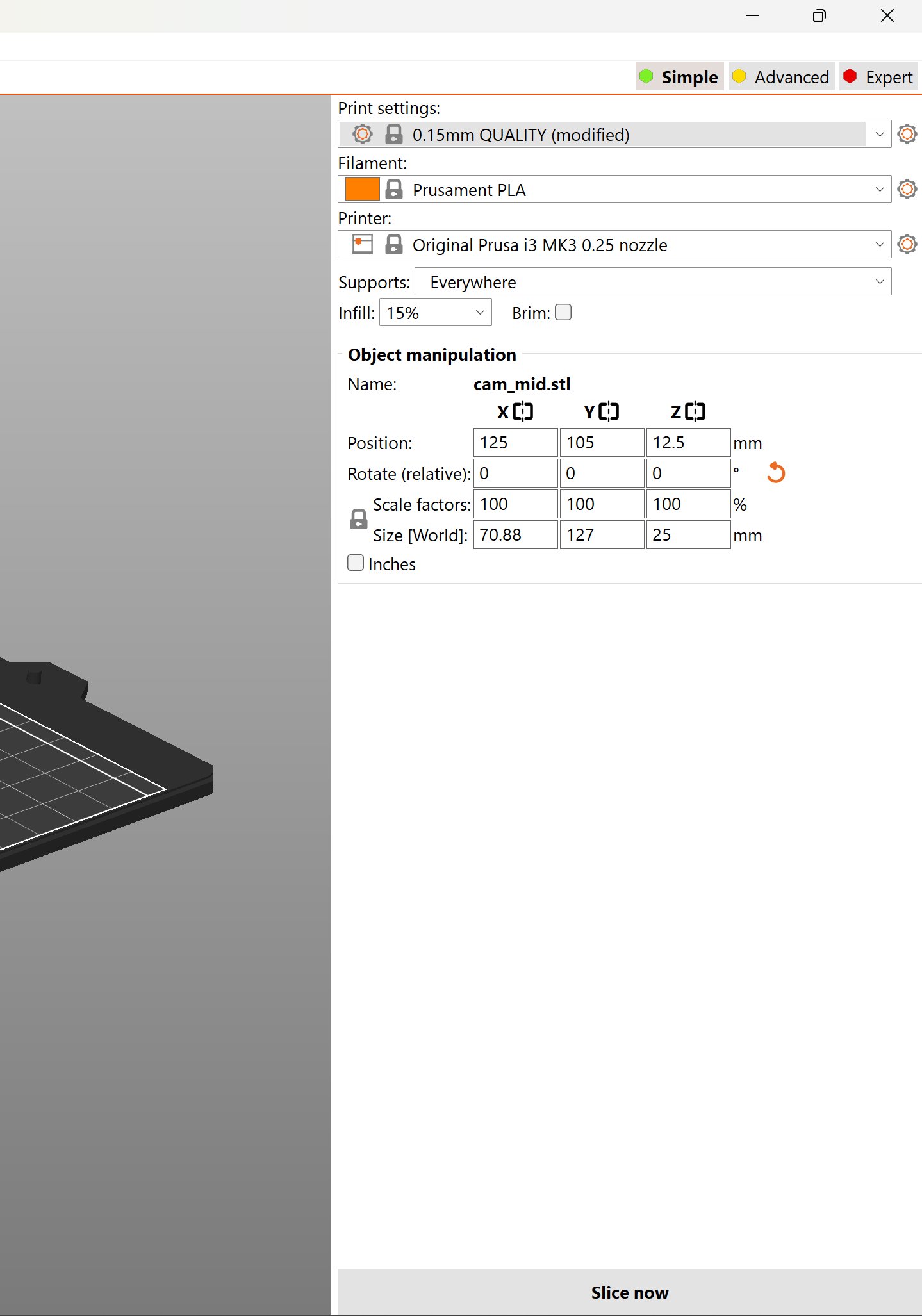

What’s the best setting for 1.75mm PLA filament on the Prusa? What’s the nozzle size for all three machines?
I just installed the Prusa slicer on my own laptop. So it’s asking me a bunch of questions on the printers I’m using.
I’m getting some spider webs on my prints with this setting.
Nozzle size is 0.4mm. For the other settings it depends on the part geometry and use case.
