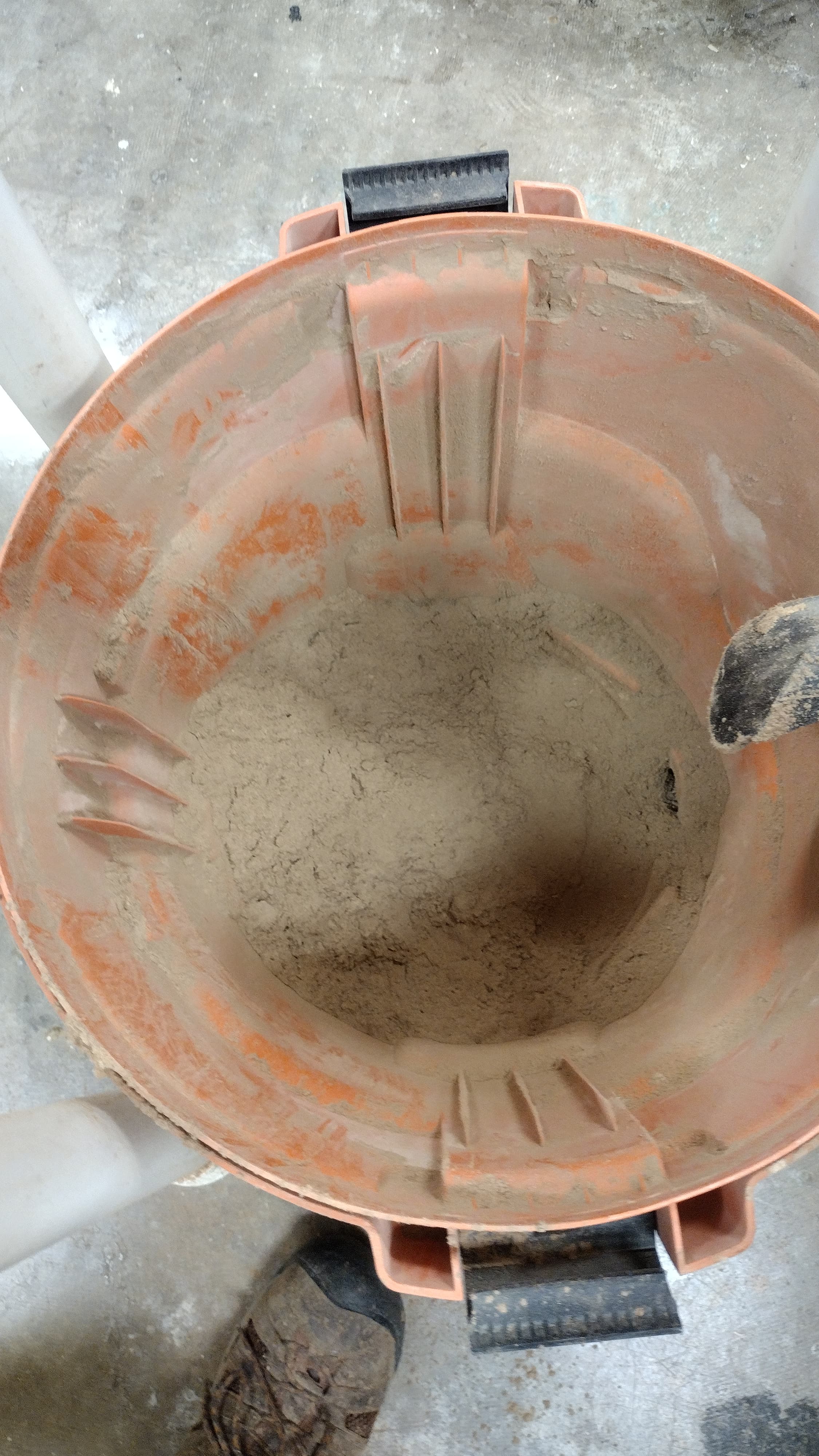

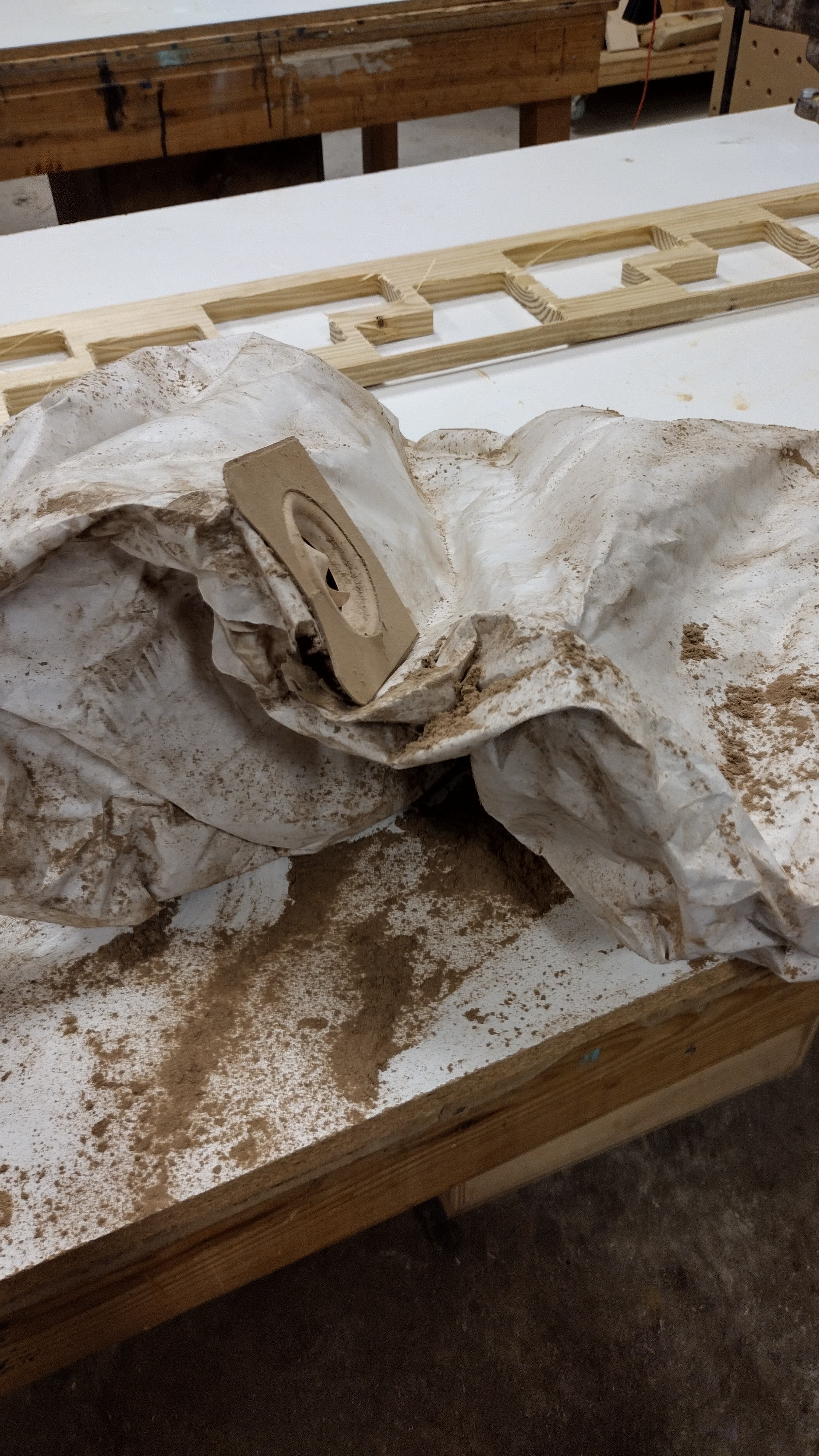

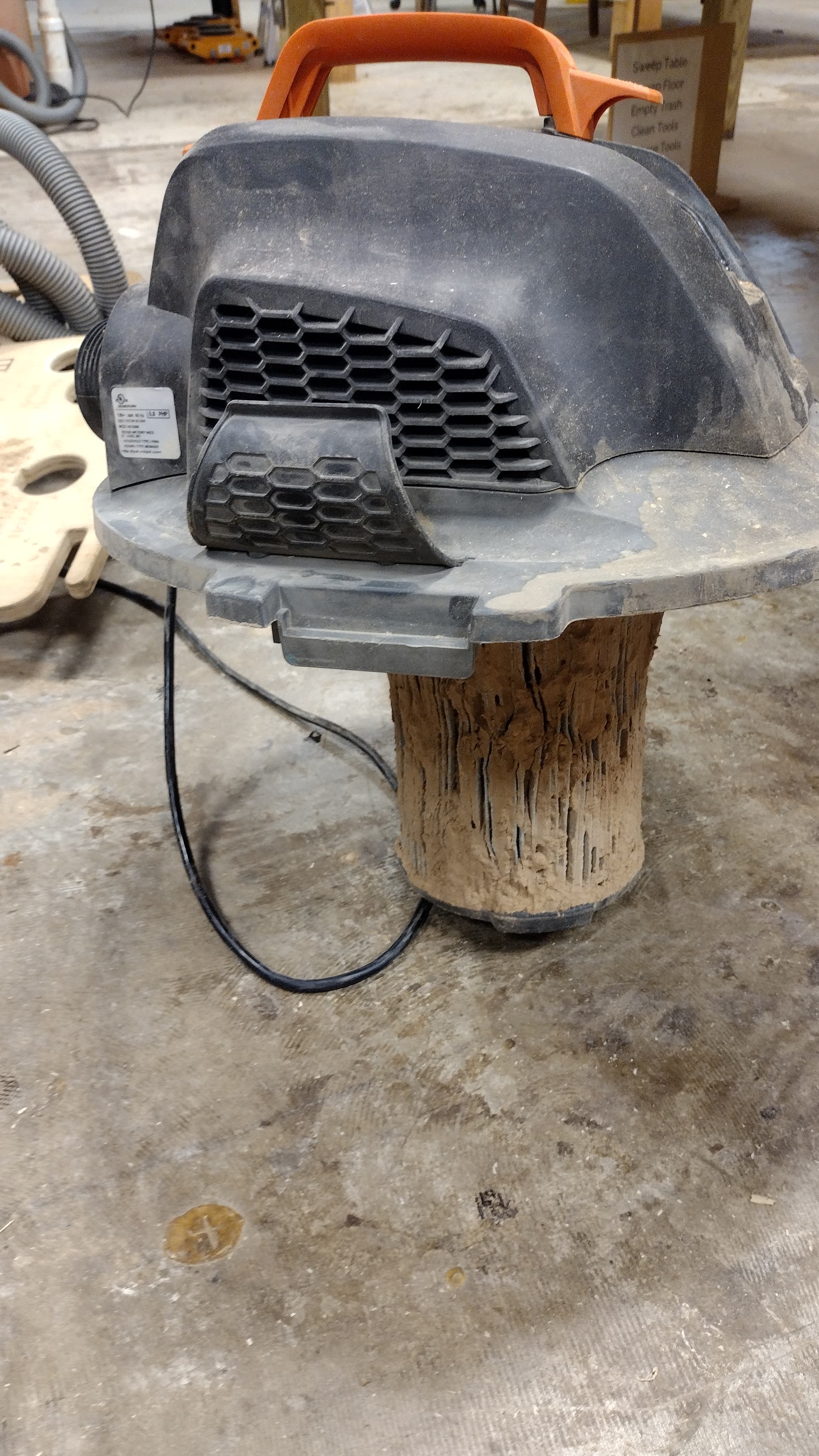

Attached are photos of one of the portable dust cart that I tore down today. It was clear that the bag had not been checked, and that the vacuum was used to pick up water at some point.
In their modified condition, they should not be used for water. If the buckets on top are emptied regularly, the bags can last several months. The way this one was filled to bursting makes me think that someone bypassed the bucket and filling the bag. Do not bypass the buckets.
Every time you use one of these, please empty the bucket on top.

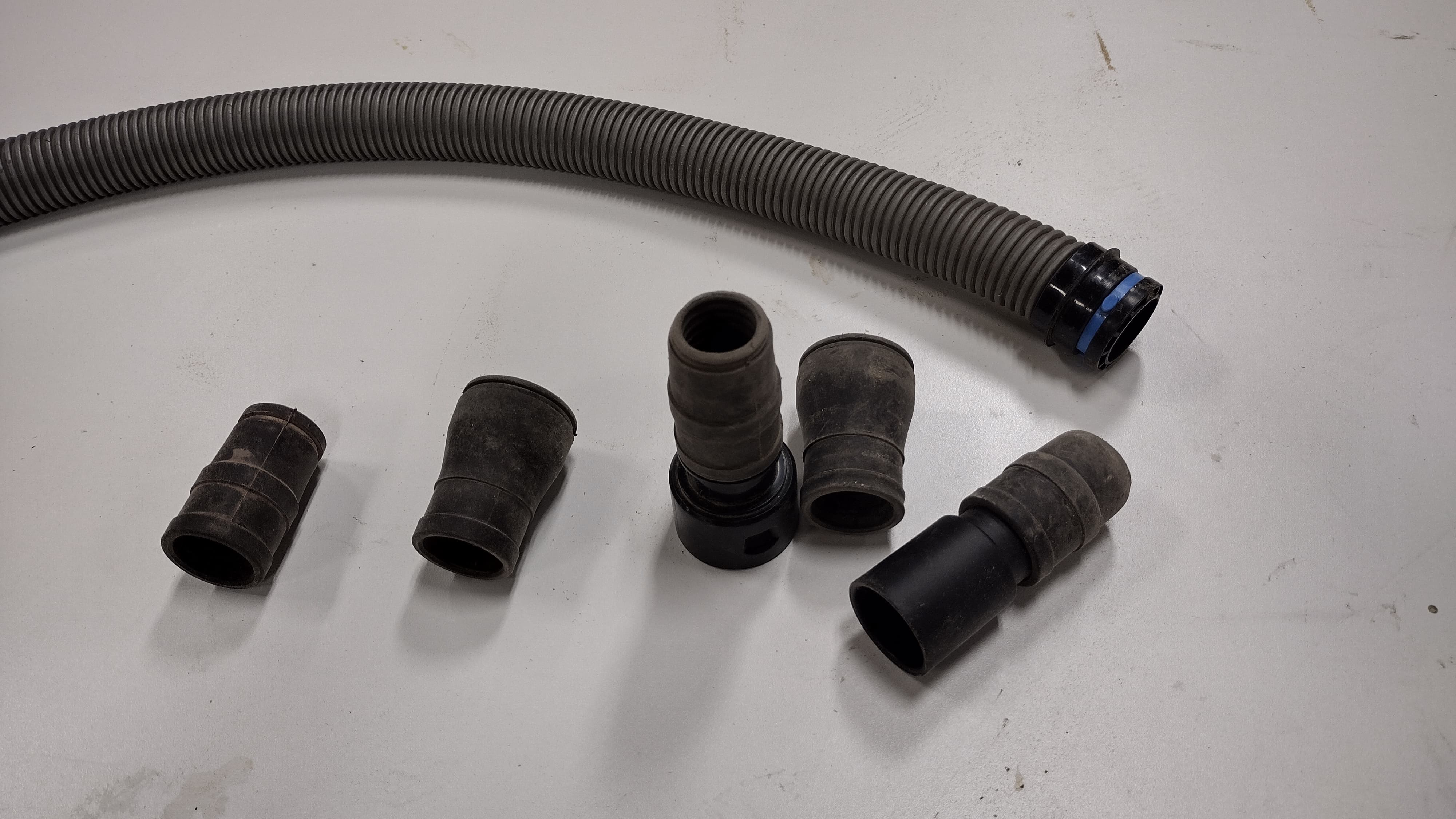

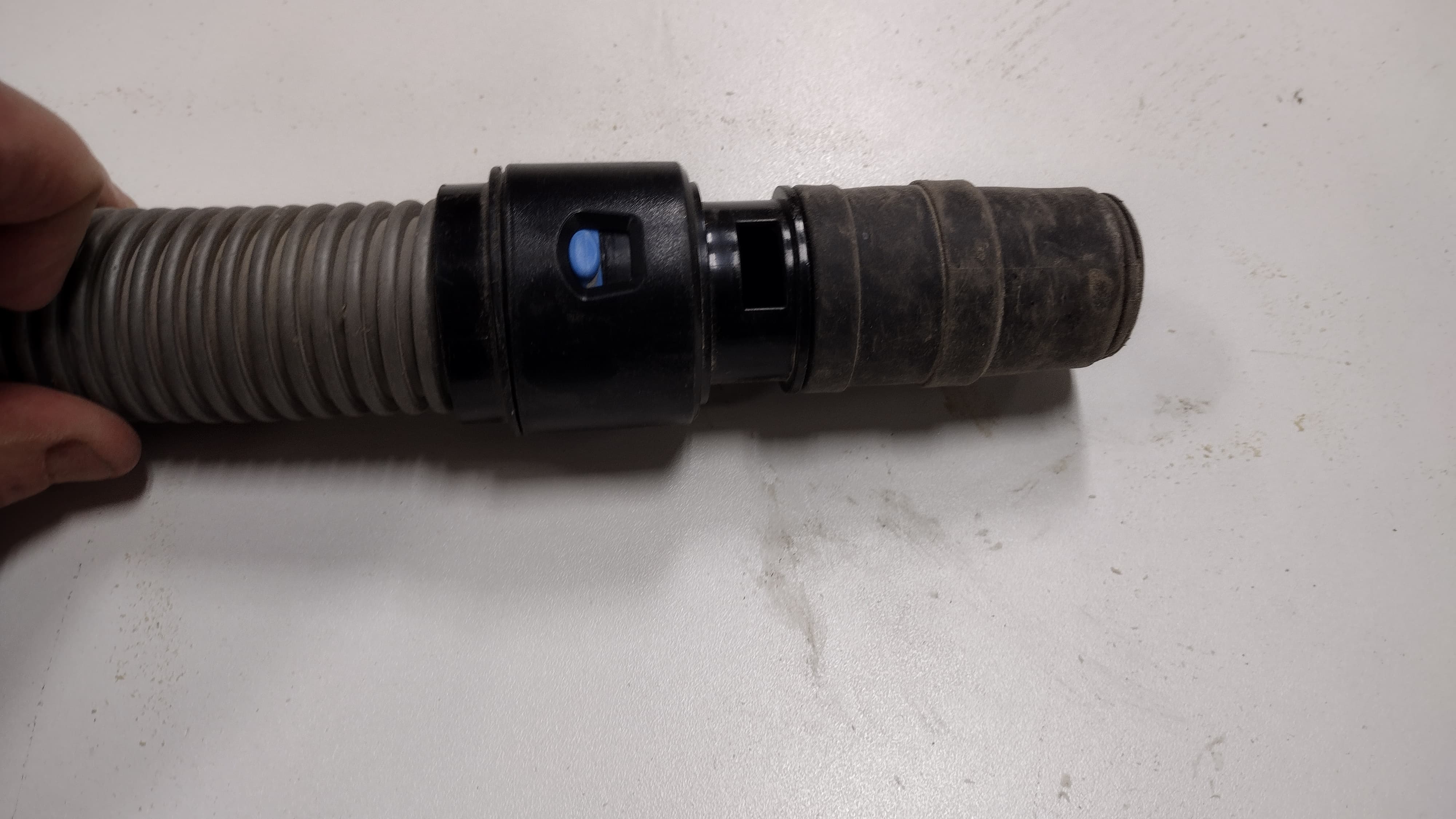

Also, I noticed today that someone was pulling the tips off of the nozzle assembly. If you press the blue dots at the base of the nozzle assembly, they pop off of the hose adapter, at the end of the hose. This may explain why there is always a plethora of rubber nozzle ends separated from the nozzle snap fittings. Please do not take the ends off. Remove the entire vacuum nozzle assembly, by pressing the blue dots.
In the first photo below, you can see the blue dots to the left. The second photo is a collection of removed rubber adapter ends, that should not have been removed. It also shows the hose adapter with the nozzle assembly properly removed.
