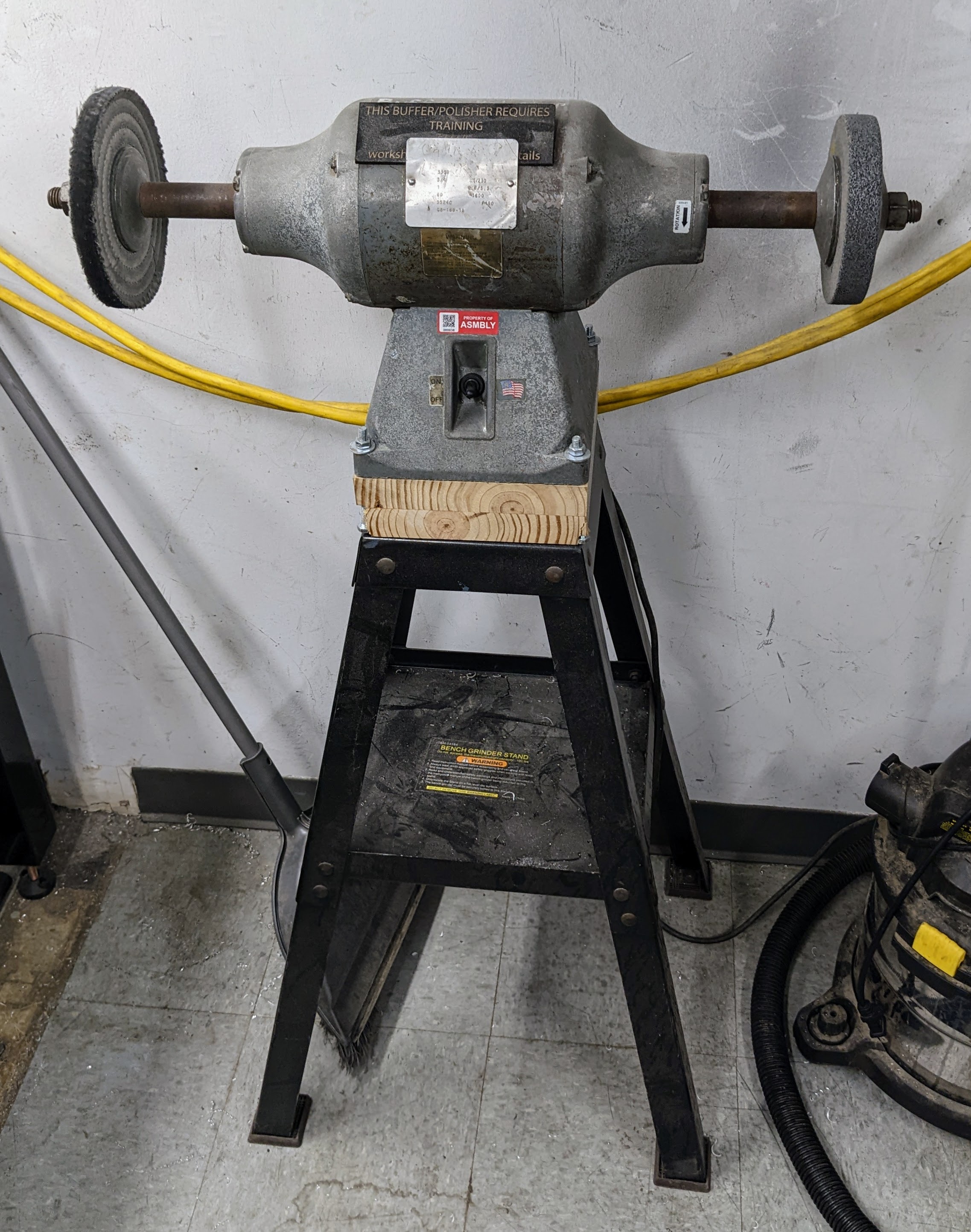

on the wiki it looks like the buffing polisher has both wheels mounted (see here).
I’m at the space right now, and the wheel is not fitted. I seem to recall from the metal shop introductory class that members aren’t allowed to change those.

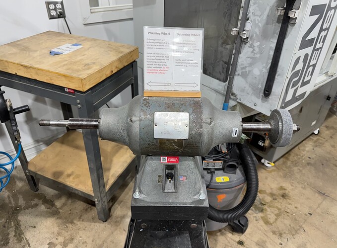

Is this correct, and the machine should be red tagged, or my notes are wrong and I should bring my polishing wheel? I’m confused because I don’t see the locking nut (see pic below)

Your picture is the current normal setup. (Yes, we’ll replace that deburring wheel soon, but we might as well get every last bit of use out of it we can; they are expensive.)
