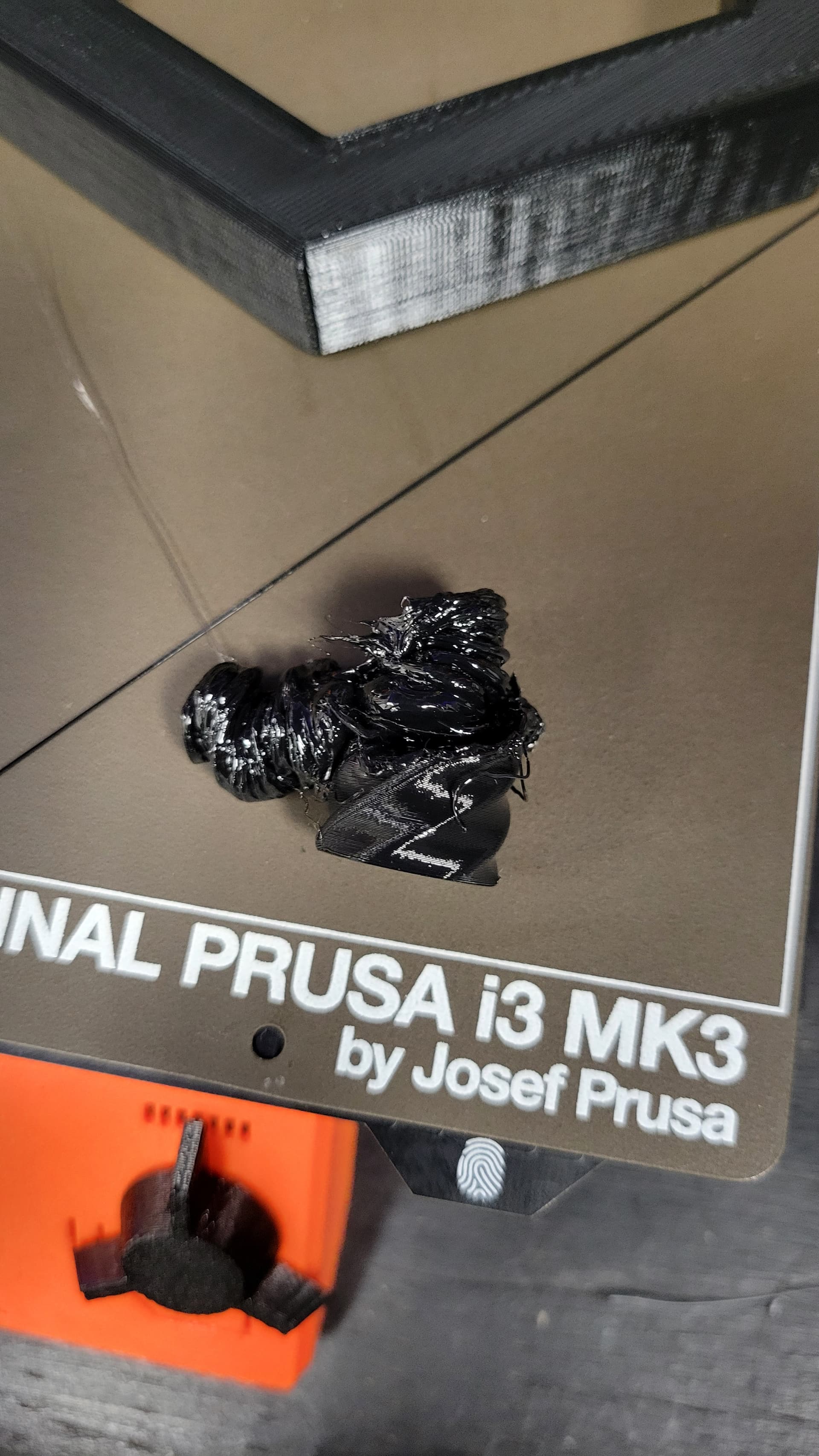

Fyi: just had to stop your print because the smaller part came off the bed and was traveling with the nozzle. Thankfully the large part seems to be a success.
Your other print had a crash, though
Thanks! …and that was the easy part!!! Not sure why it messed up there. Just started a couple large parts tonight. Fingers crossed.
