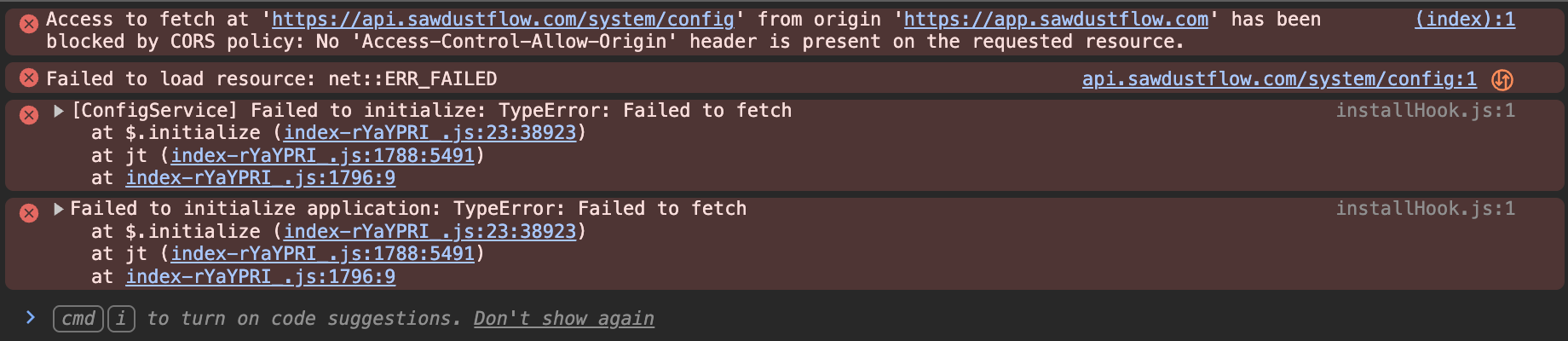

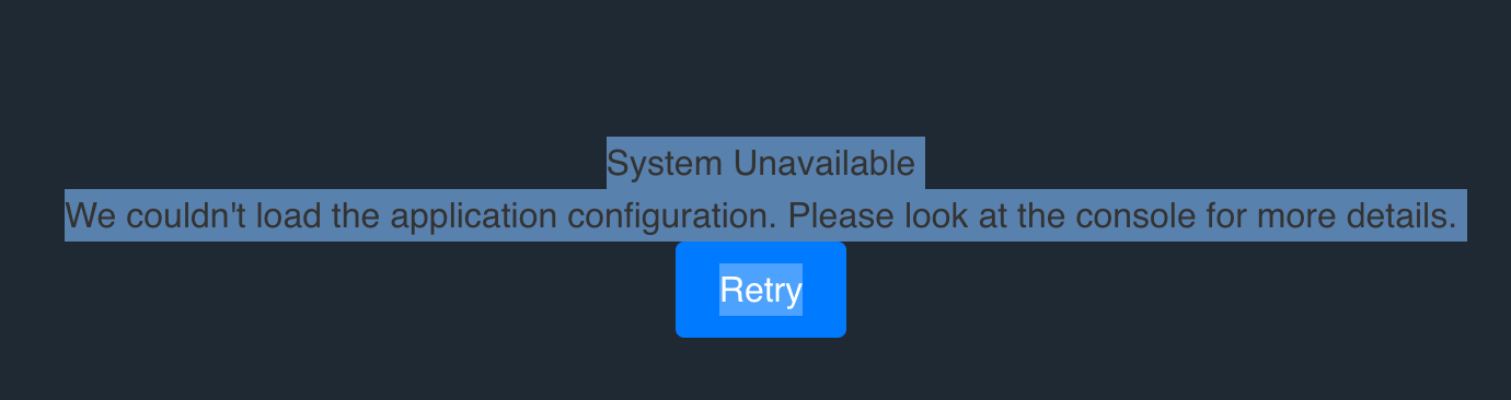

Getting an error on MacOS:
And console
Oh that’s so cool, I can’t wait to check this out! Looks like there might be a bug (CORS, of course :sweat_smile: )
Well damn. Never push code early in the morning before you leave the house for a day. I’ll post again when I’m home and undo whatever I messed up.
Dev.sawdustflow.com works okay today. Enough for the landing page anyways.
