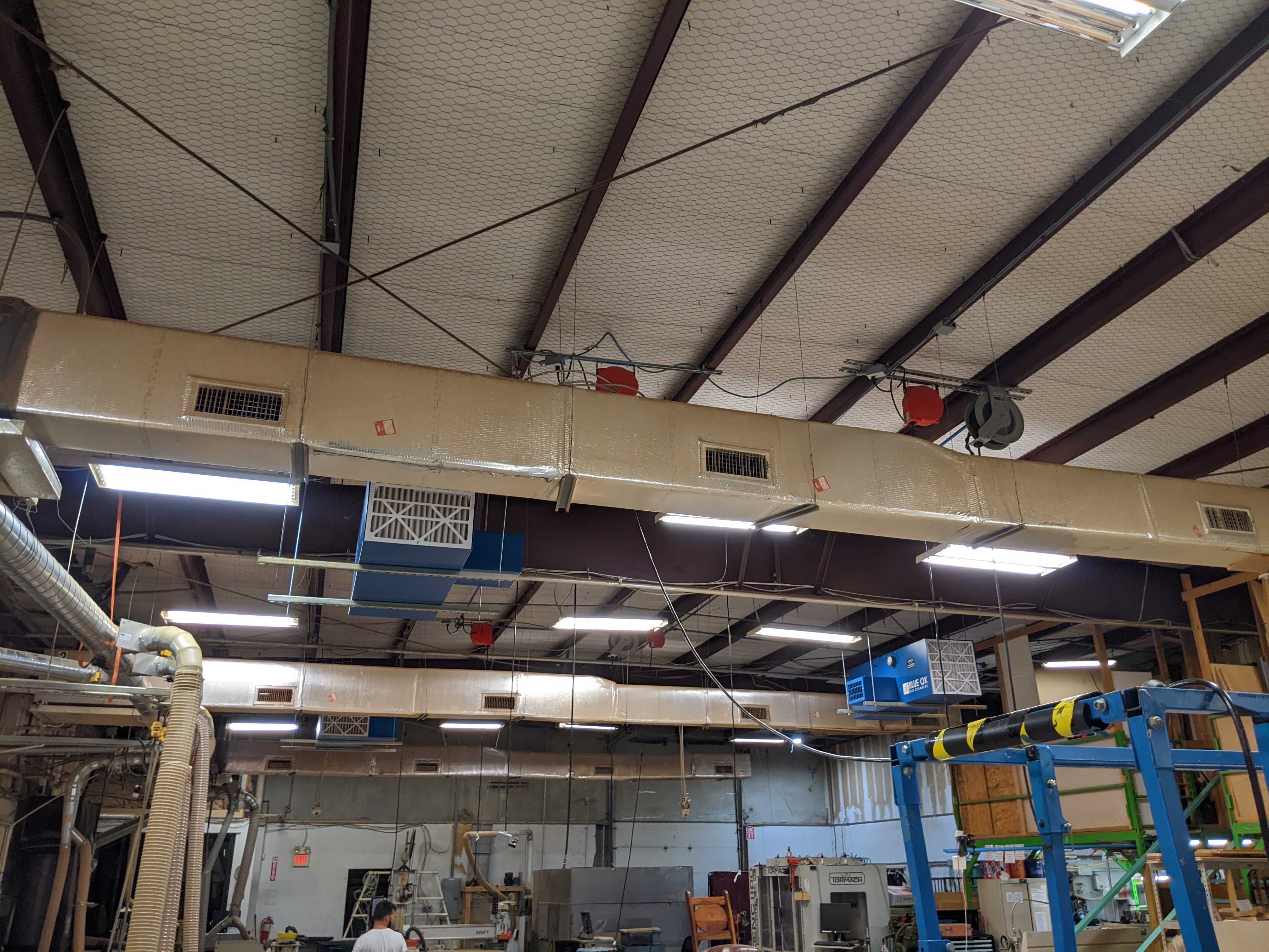

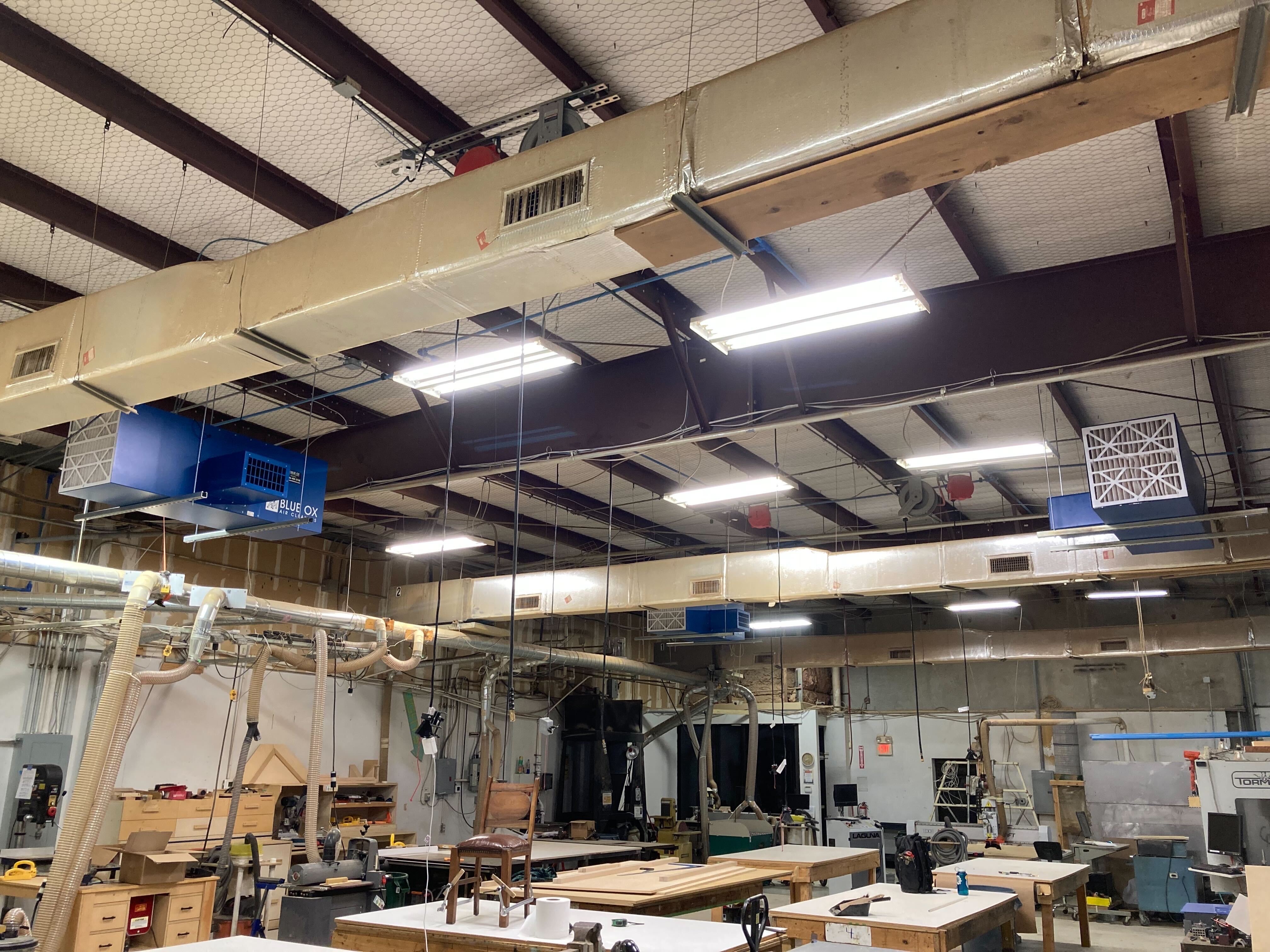

New shop air filters are installed and running!
If you look up in the main shop, there are 3 new blue boxes up at the ceiling, and these are industrial air filtration systems. Shop air improvements are upon us!
Like so many shop projects, lots of people were involved in making this possible, @mkmiller6 , @jamesfreeman @Joaquim led various parts of the install.
Thank you to everyone involved for this HUGE shop improvement

These new air filters are one great way to reduce exposures and maximize air quality in the shop, but they aren’t a catch-all. The best way to prevent poor air quality in the shop is to catch as much dust at the source as possible. In the woodshop, that means always using the dust collector, always using a shop vac when sanding, and using the downdraft table when possible. In the metal shop, that means using the fume extractor when welding.
Air filters like these work on the principle of air exchanges per hour, or in other words how often the entire air volume in the room is exchanged. That’s obviously not an immediate process (for our setup it’s about 6 exchanges per hour at a minimum, or higher when the AC is also running), so during periods of heavy use, I would still recommend wearing a supplemental dust mask or respirator. The air filters will help to minimize spikes in particulates and bring air quality back to baseline much more quickly.
