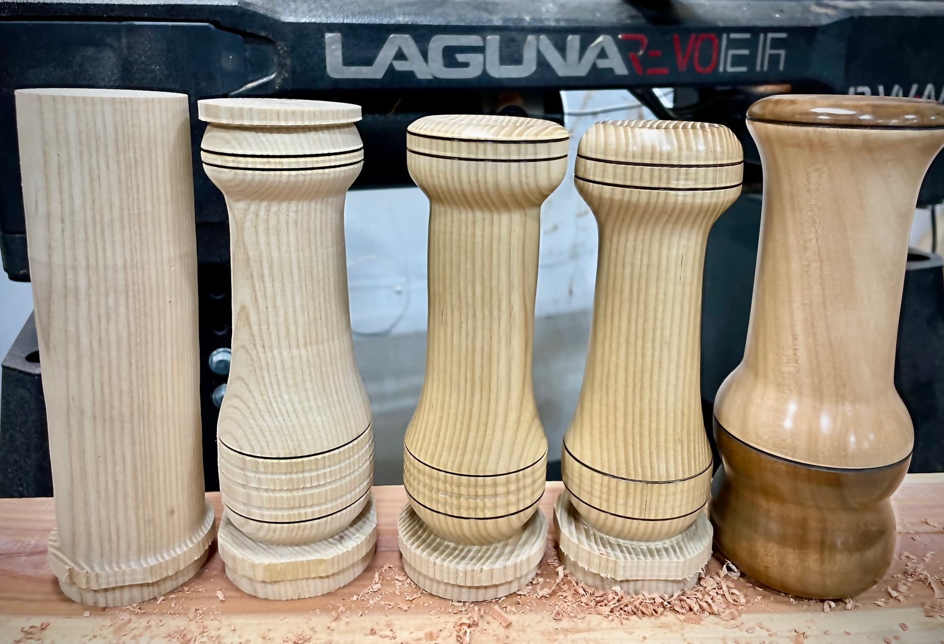

Expand your woodturning skills with this guided vase-turning class! Designed for students with prior wood lathe experience (or those who have completed our introductory woodturning classes) this session will help you refine your technique and take on a more advanced project.
You’ll learn essential skills such as spindle turning between centers, creating a tenon, finishing, boring, and tasteful tenon removal.

After completing this class students should be able to:
  • Properly mount material to the lathe, first between centers then after forming a tenon remount that tenon in a chuck
  • Shape the outside of the vase
  • Drill / bore the inside using a forstner bit and gouge
  • Sand and apply finish
  • Remove a tenon with a Jam Chuck
