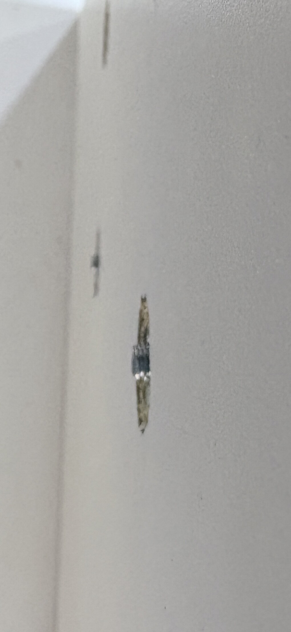

Al, the pocket wasn’t quite big enough(shy on length and width about a 1/16". I chiseled it out and it fits now. It’s not beautiful but I think it will work. Melamine doesn’t like to be chiseled.
We might want to cut a new one then. It’s critical that the rotary axis be aligned to the edge of the melamine. A tight fit in the pocket allows it to reigster against the metal base of the rotary.
I’m going to use the rotary tonight at 7 pm. We shall see if it is workable
Al, if you recut it, please don’t cut the secondary center cut out. The original bed doesn’t have it and the material gets very thin when the counter sinks for the T Nuts are cut. Thanks.
