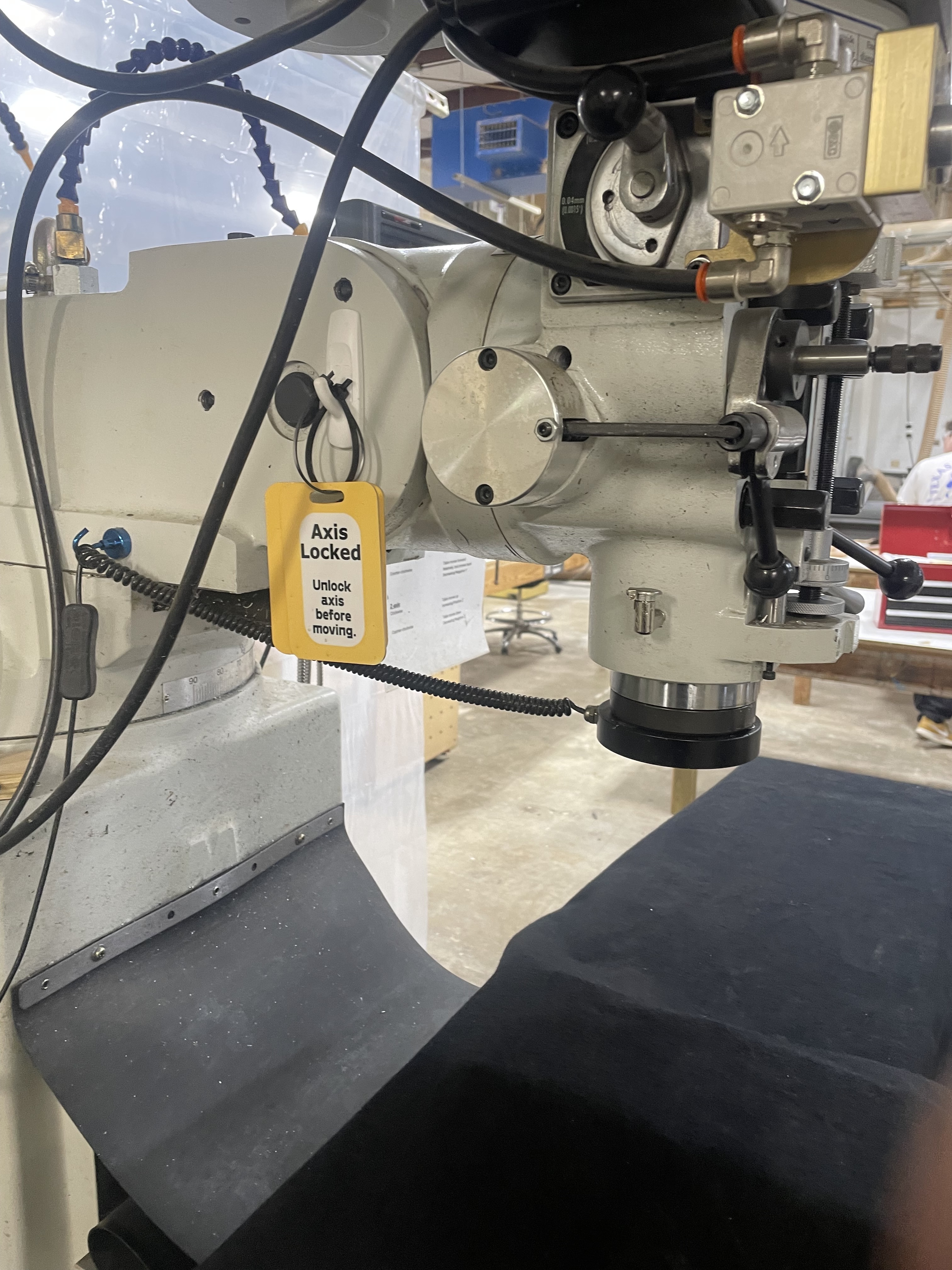

But it is easy to forget that the axis has been locked and start to move it while it is still locked. This is not very good for the lock and gibs of that axis. Again, this is a particular issue for the z-axis on the new mill; the autofeed lever for z is very accessible but the locks are behind the table almost out of sight.

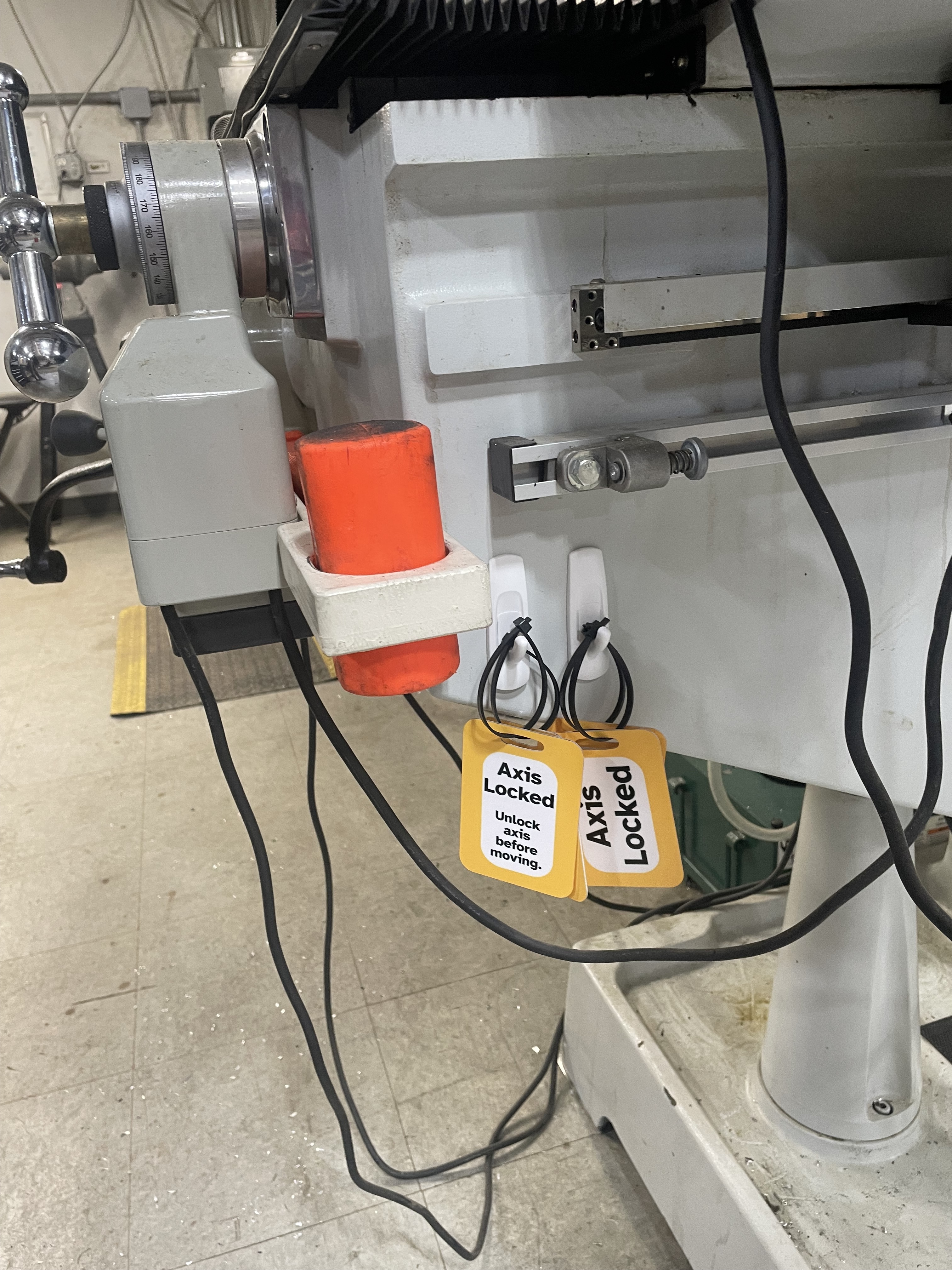

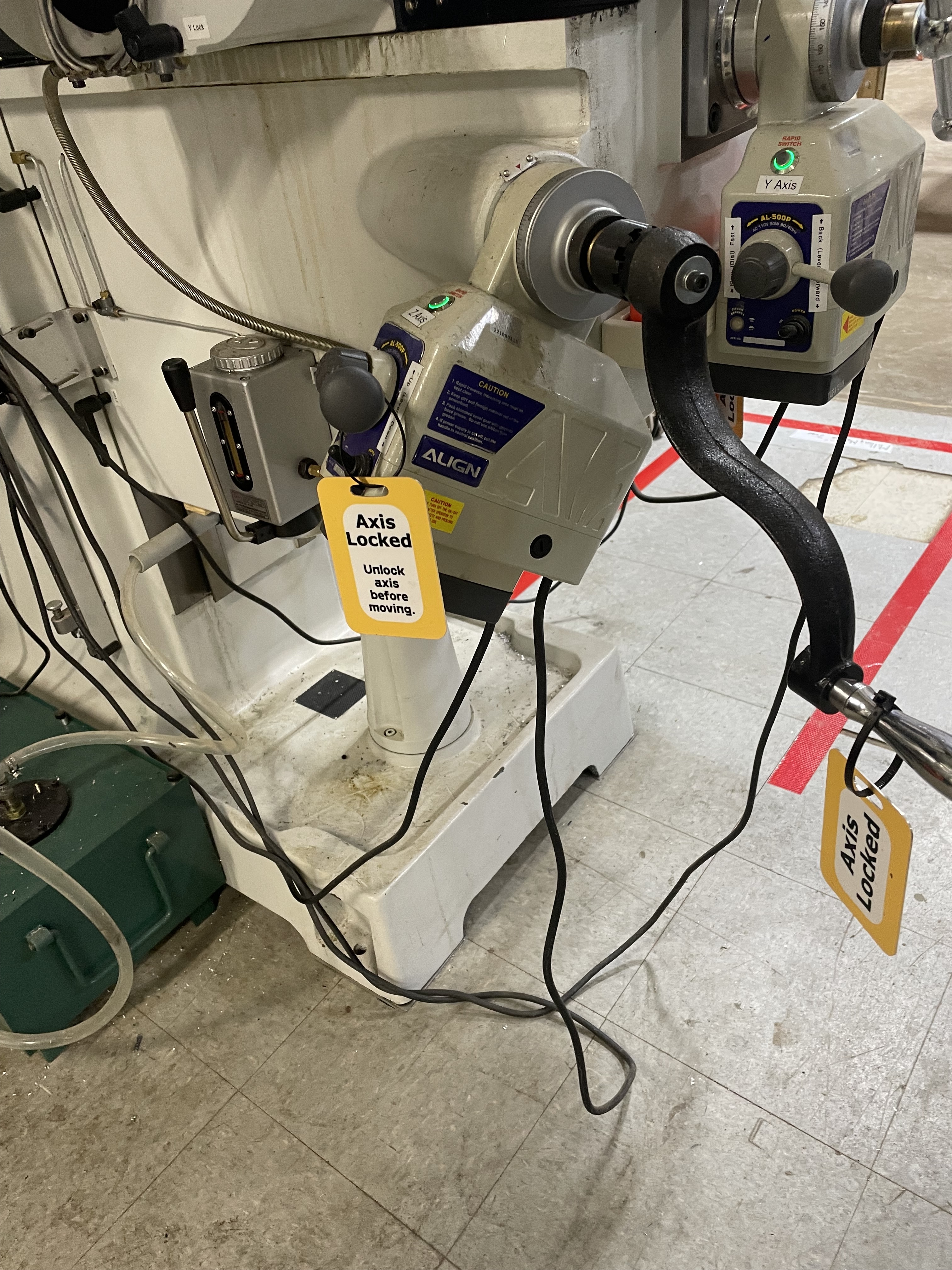

So we have a new procedure for the mills: whenever you lock any of the x, y, or z axes on the large mill or the x or y axes of the small mill, you should place one of these “Axis Locked” tags on both the manual and auto feed handles for that axis as a reminder, as shown here for the z-axis of the large mill.

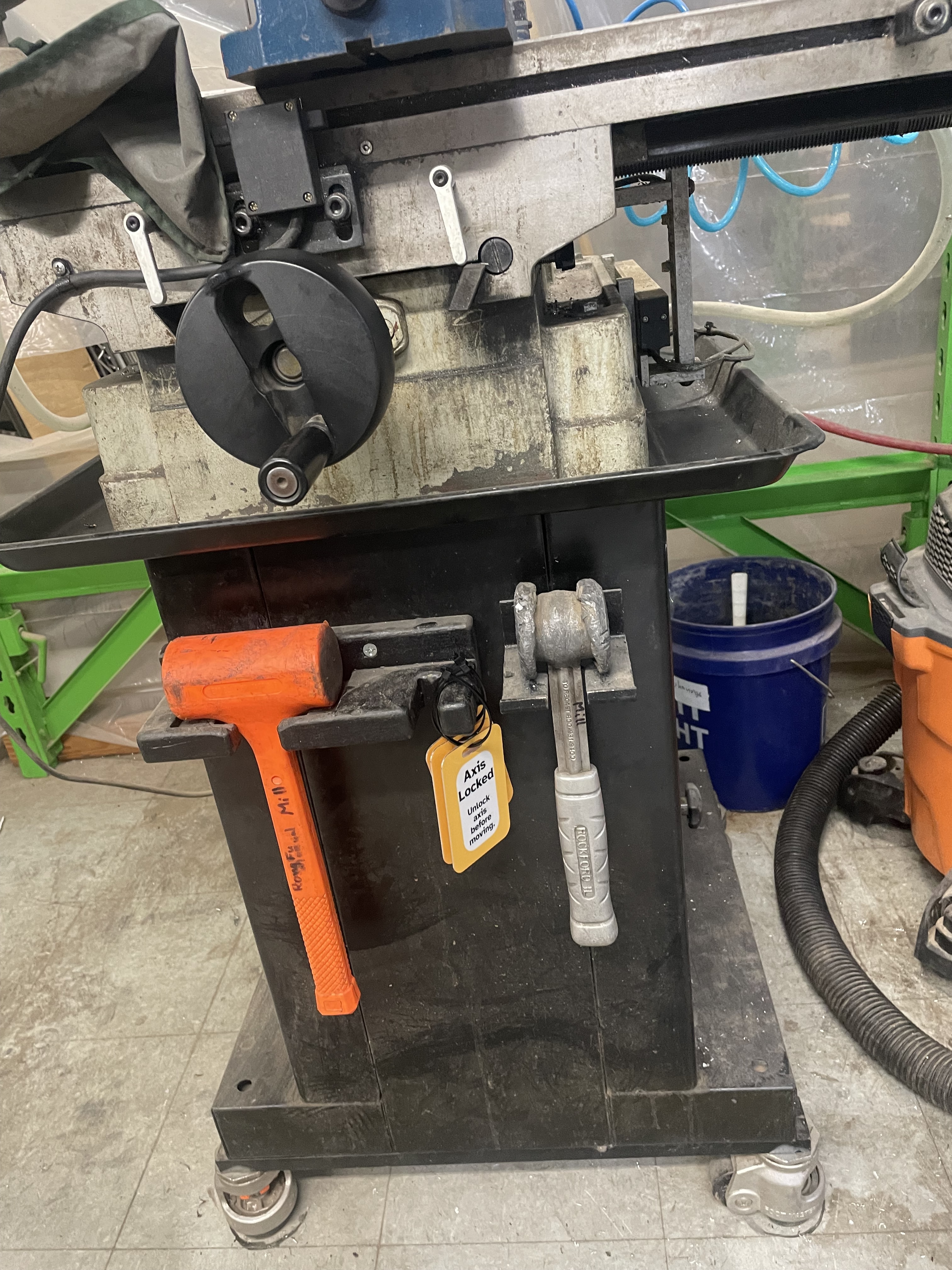

These tags are on hooks near the locks, as shown below, and should be returned there when the axis motion is unlocked.
(Note also the nice new hammer holder behind the y-axis autofeed motor.)
