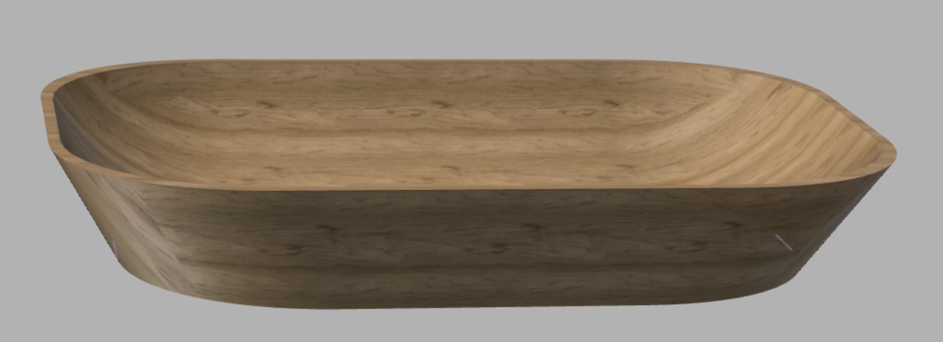

Right after taking the CNC class in the shop I headed home looking for an idea of what to make. As soon as I put down my wallet and keys I realized I needed a small wooden “valet tray” to hold them.
This was what the design looked like in Fusion 360
My first attempt died at about the 80% stage, so I made a second one with the items I learned from the first. It still isn’t near a perfect CNC task, but it is definitely recognizable.
My next step is to try some other milling techniques to perfect the setup and then do the final pass in oak.

For something like this in Fusion, have you played around with adjusting the “cusp height” in the toolpath yet? I do some work with hemispheres on the Tormach and find it pretty useful to minimize the amount of sanding at the end vs guessing on the stepover size. Also, a large ball end mill would be your friend here in getting it as smooth as possible pre-sanding. Cool idea, I need to make something like this for my apartment.
What bit did you use?
This sort of shaping calls for a ball mill- and the larger diameter, the better. The scallop between passes will be less and less as diameter increases. A ball mill’s max diameter is limited by the feature it needs to be able to fit into- which isn’t a factor for a bowl.
An endmill’s terracing will always be much more apparent than a ball mill. 15% stepover is generally the point where you’ve got it as smooth as it’s likely to get and lower stepovers will just take longer.
