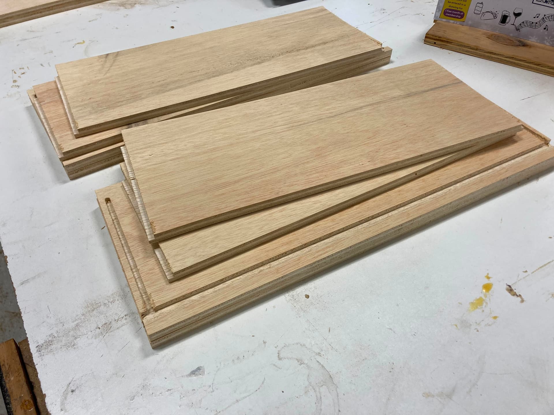

Valerie posted some pics of a set of three drawers that I cut. This is one of a few construction methods Mozaik offers. It’s less effort than using the Festool Domino and, as far as I know, provides similar joint strength for drawers.

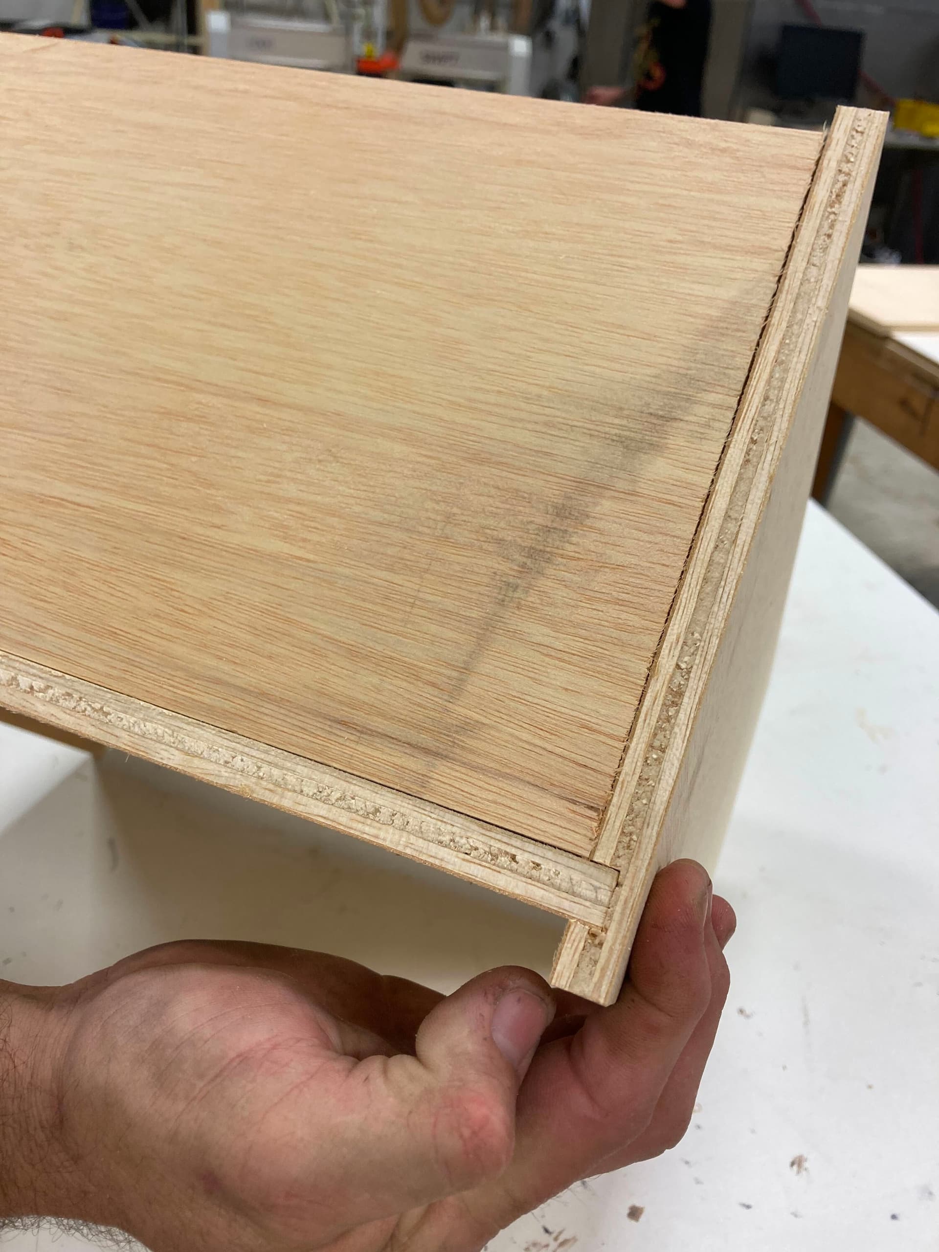

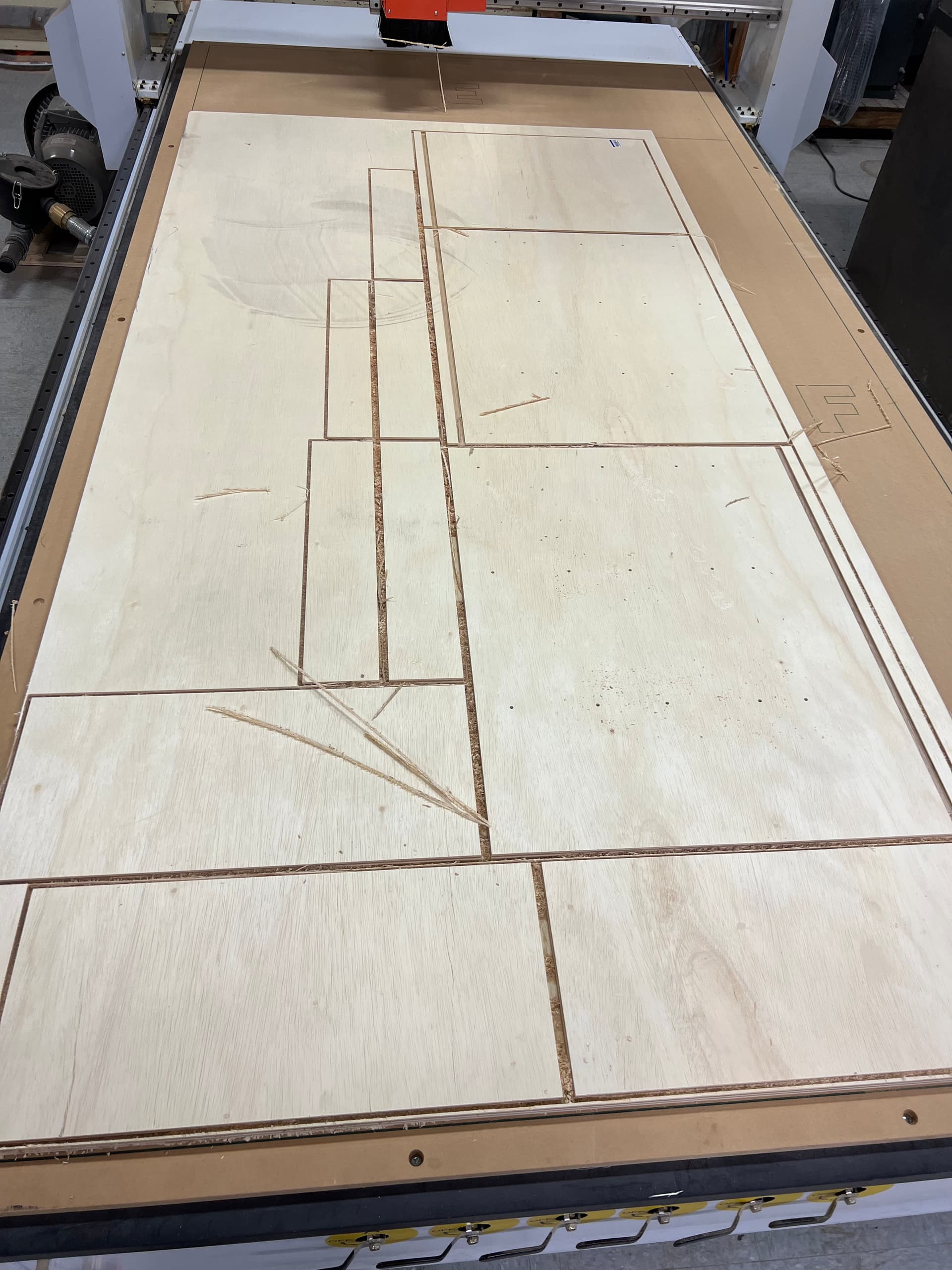

I have four sheets of 4’x8’ that I plan to break down this weekend. If anyone wants to hang and watch the process let me know. Here are more photos from Mozaik & Laguna work I have done:

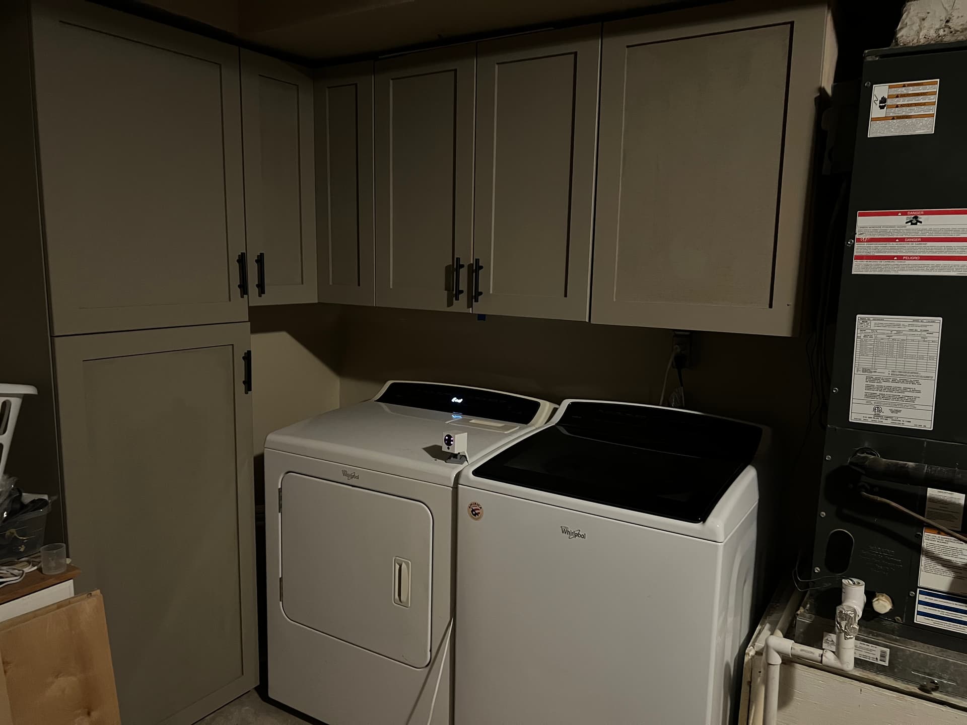

Here are the last four cabinets I made* on Danny’s machine. They have MDF fronts in the style of shaker cabinets.
