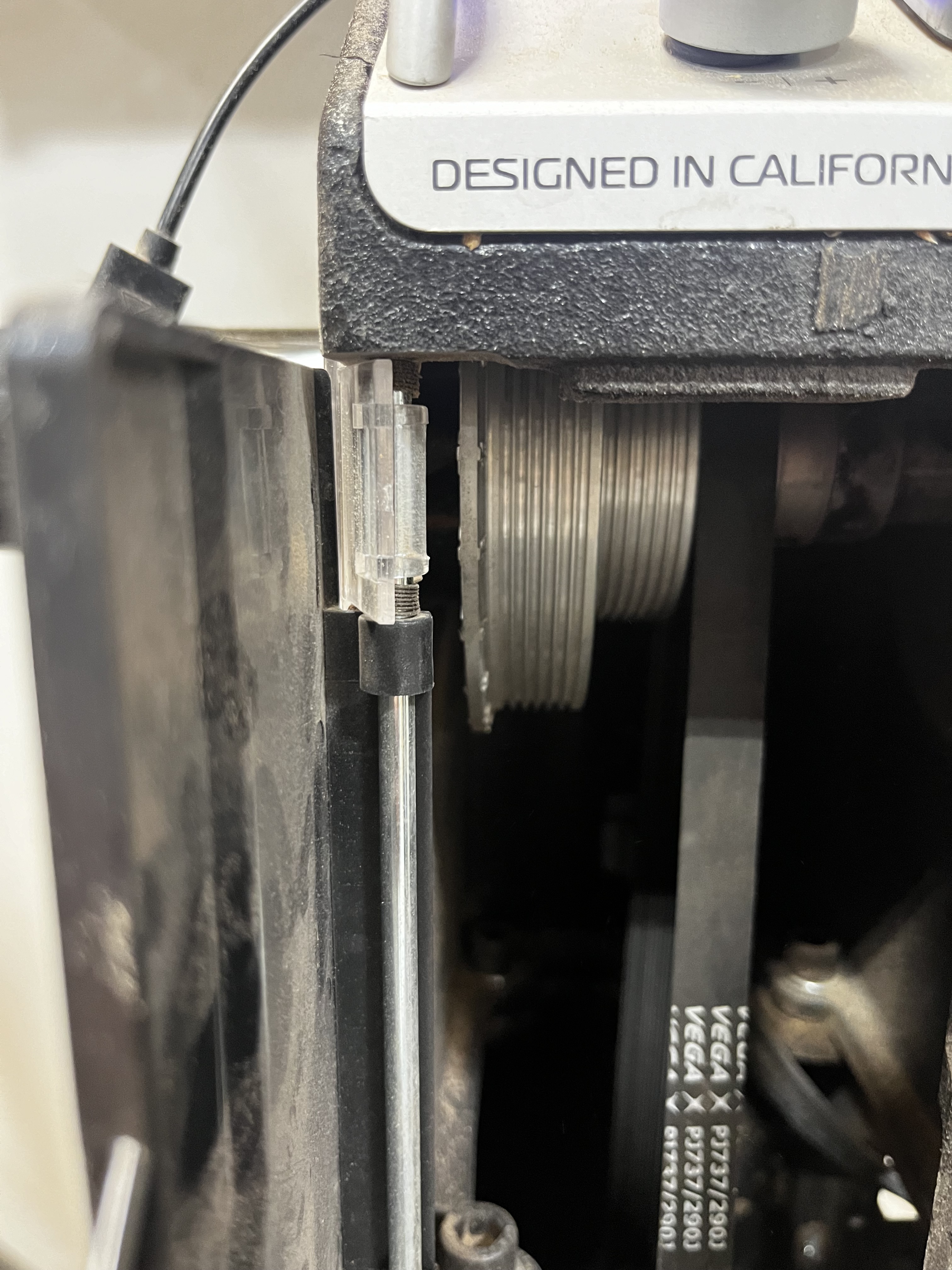

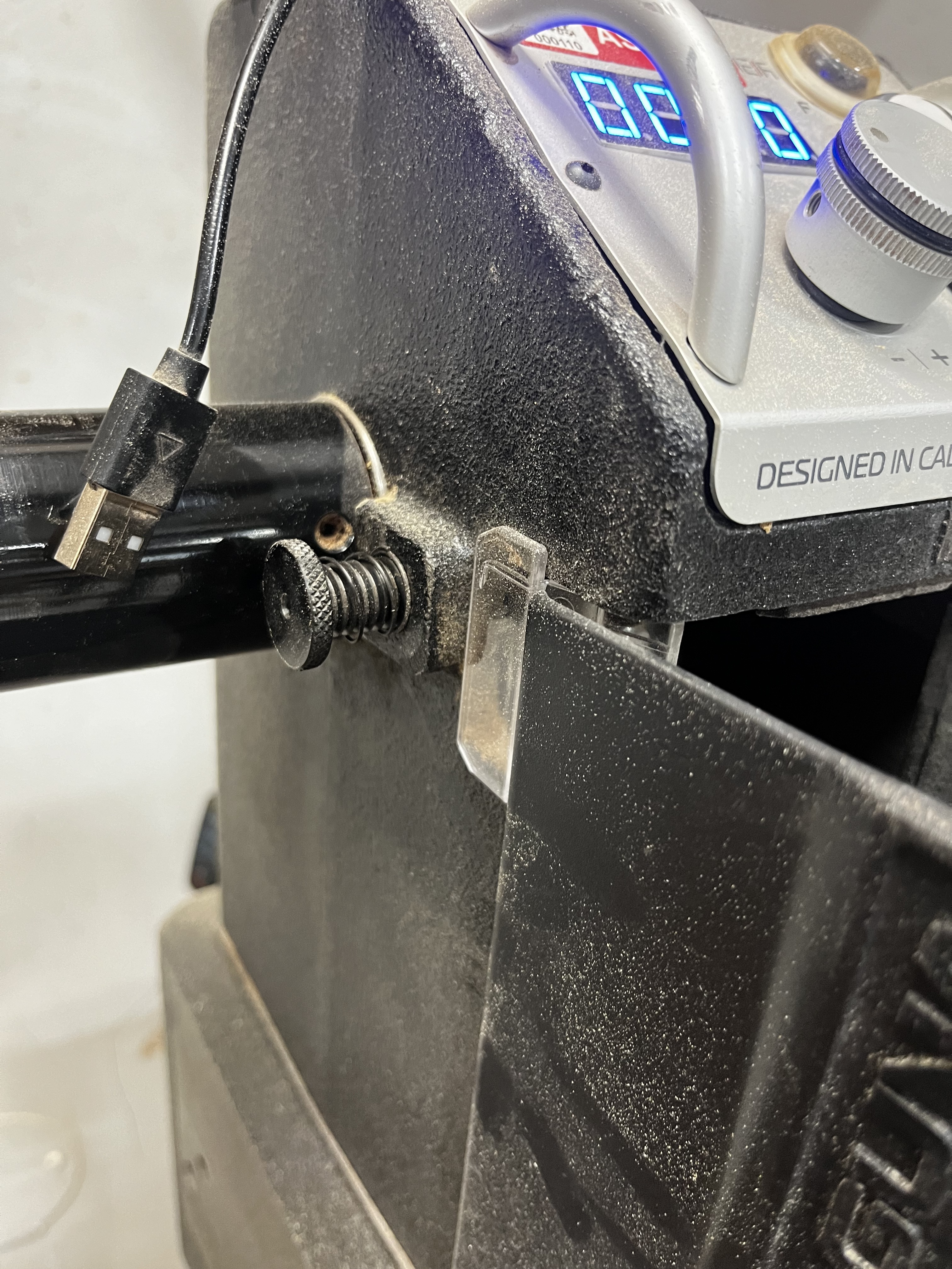

The middle lathe in the woodturning area isn’t rotating when it’s turned on. I couldn’t find the QR code to red-tag it, so hoping that posting here is the next-best thing?
Thanks for letting us know! Just checked. This black knob can be rotated to lock the top gears in place. Looks like someone had tightened it down for whichever reason. I just loosened it and the lathe is turning now!
