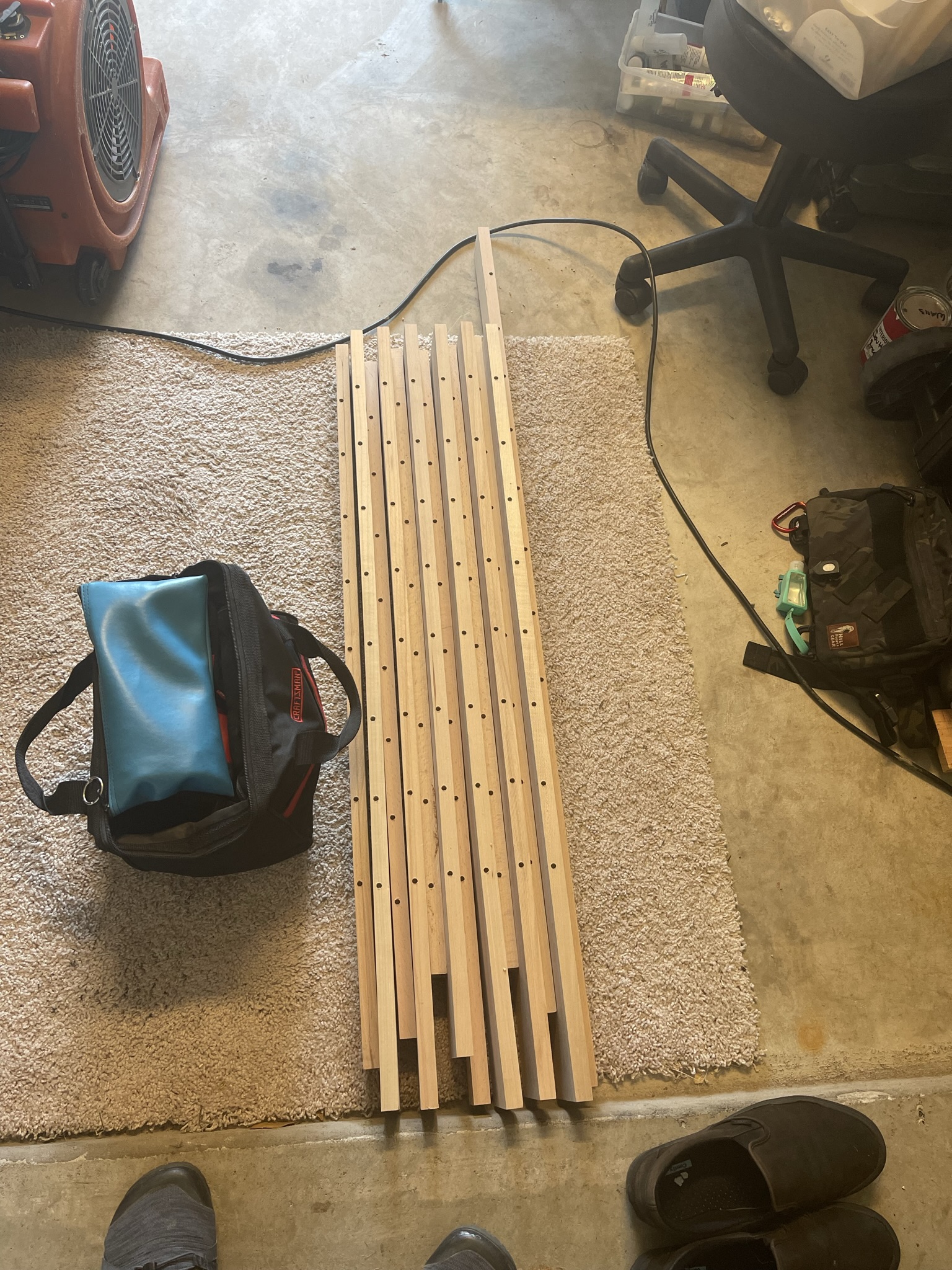

I glued a panel with the lighter mahogany and a strip of poplar for an accent. The boards were so twisty and warped I had to use a ton of dowels to get them all lined up. 109 dowel holes were enough to tell me I never want to use a dowel again in my life.
