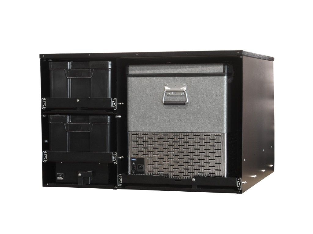

Metal brake for drawer pan?
I believe the metal brake can handle up to 14ga mild steel. Would 14ga be a good choice to make drawer pans like these? My other option is wood, but metal gives me a bit more volume to play with.
For our van conversion I’m planning two drawers in the rear, one for storage cases and one as a dedicated camp kitchen. So the drawer won’t support a fridge but rather a 22" griddle and cooking utensils.

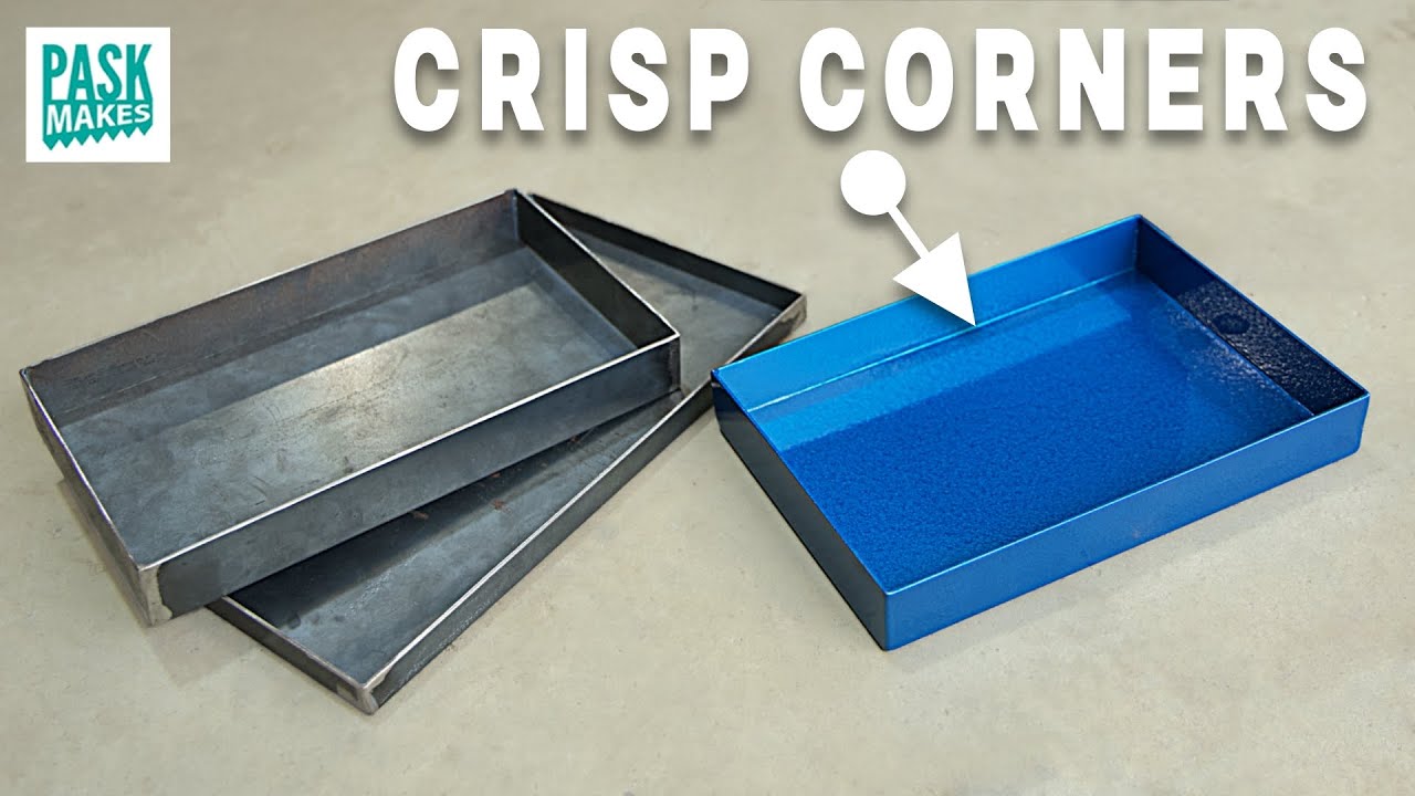

Another option for forming boxes in 16ga steel is using this technique which doesn’t require a brake. Also yields nice crisp corners.
