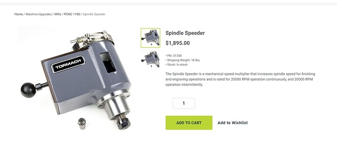

Does the Tormach spindle get fast enough to run such small bits? They offer a few high-speed accessories marketed for use with 1/8" collets.
It spins up to 5k which is less than ideal for small bits but can still work. Just means you have to run at a slower feed.
They make a speed booster that can get it to 20k (30k for short durations)
Might be worth looking into. 5k is really slow in terms of cnc mills. Most of them seem to be at least 10k.
Presumably the High Speed Spindle kit would be better than the speed booster?
I thought that until I read the install instructions. The high-speed spindle takes the place of the standard spindle; swapping between them is non-trivial.
Oof. You have to drop the whole spindle? Ouch.
