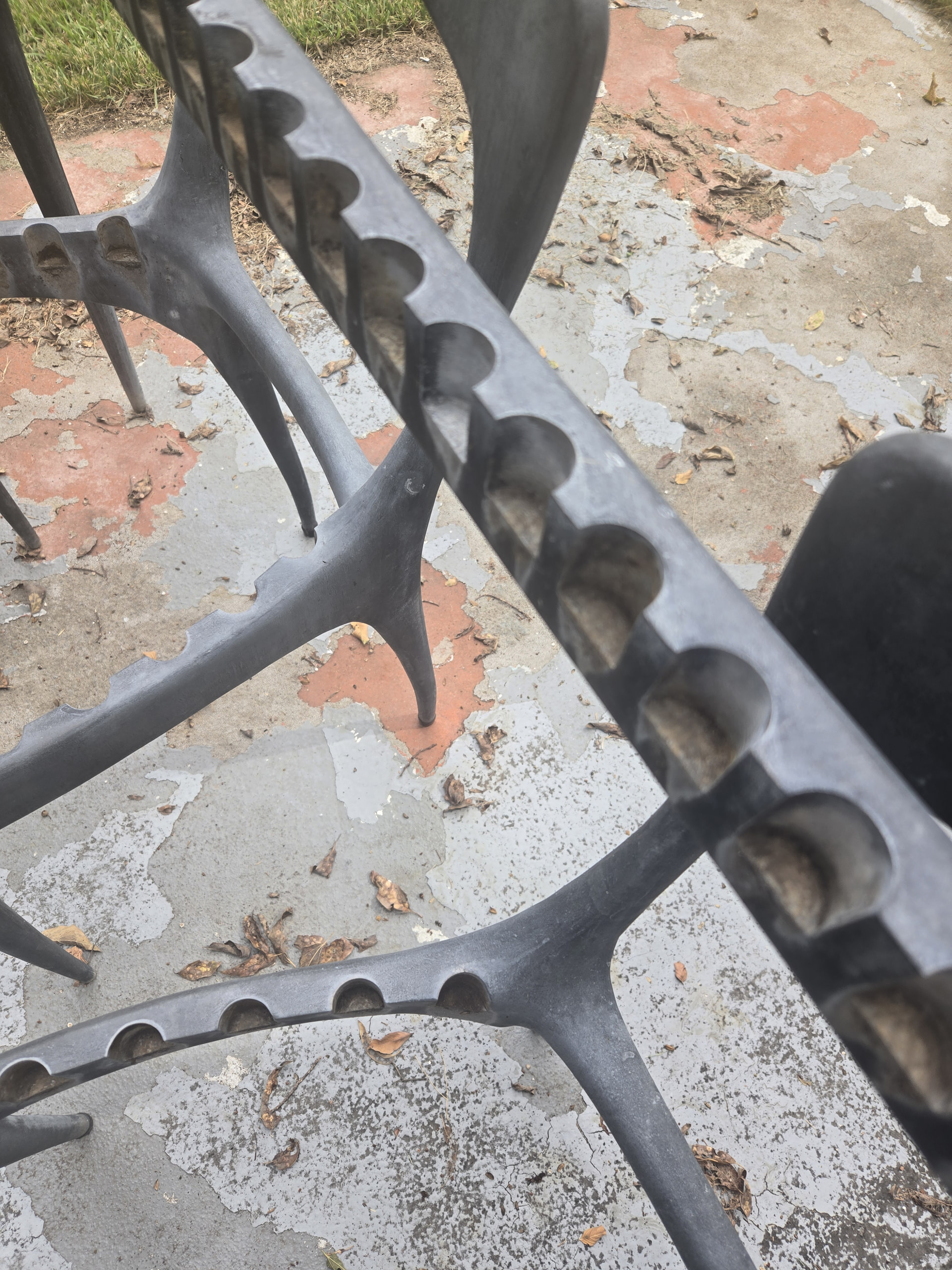

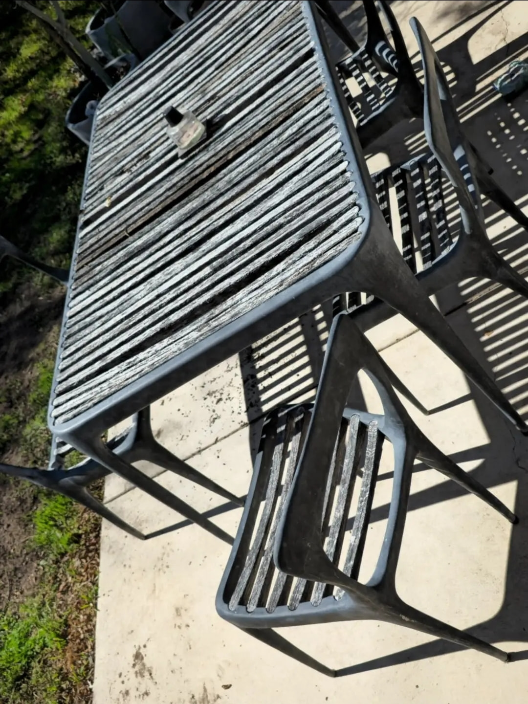

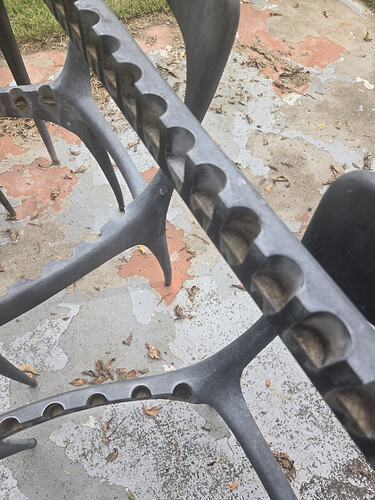

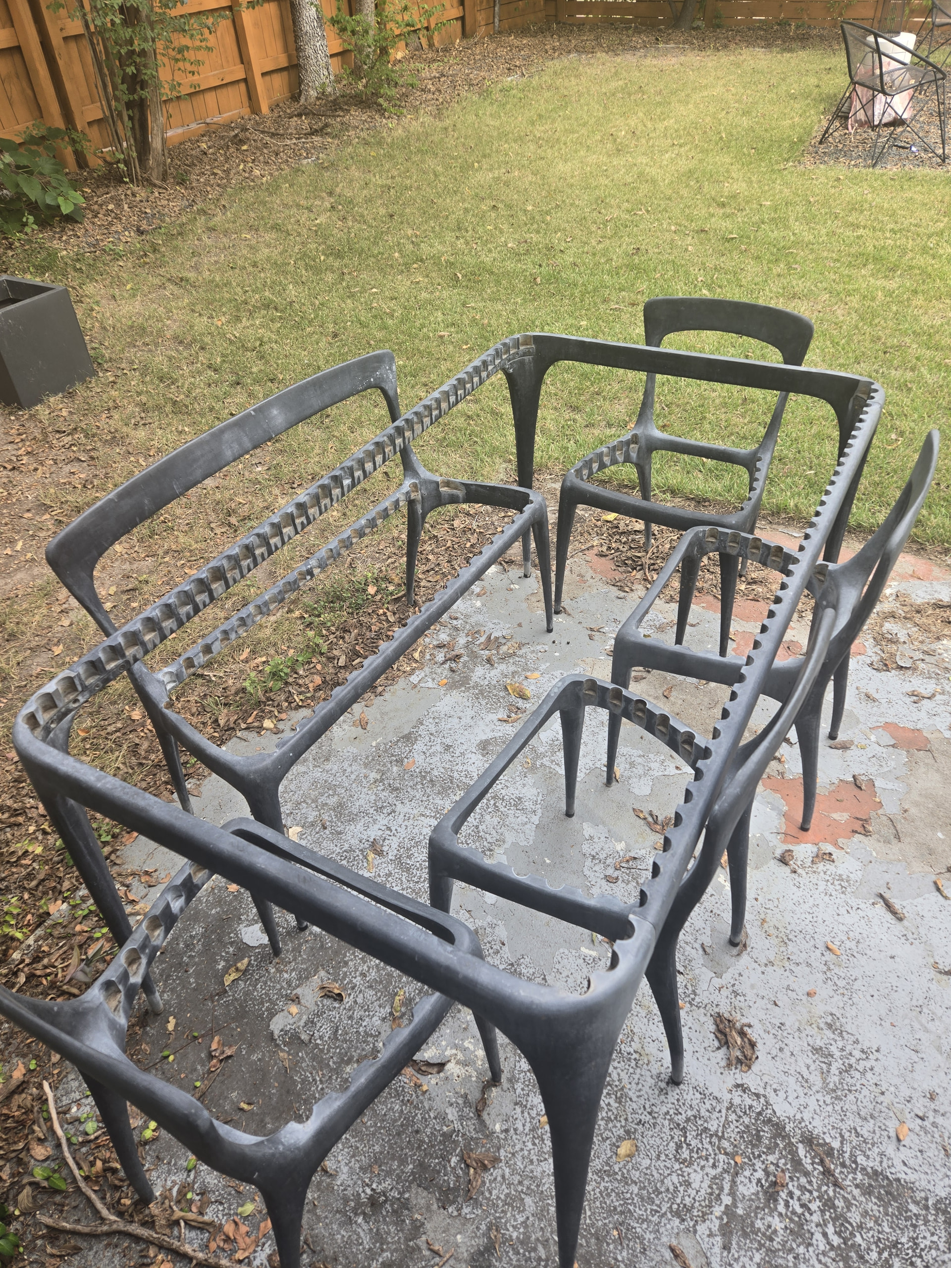

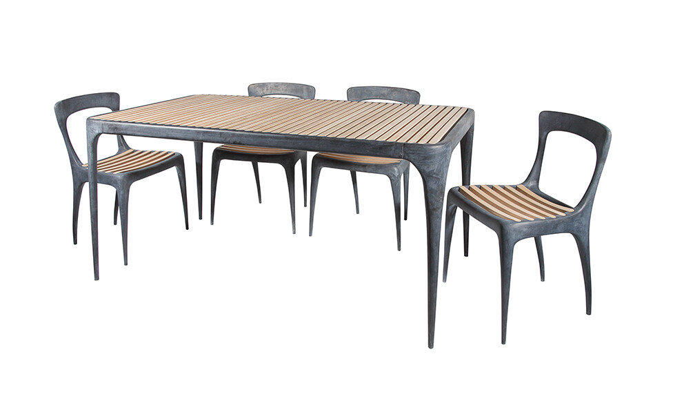

Included are some photos of the set now, how the slats slot in, and what the set looked like originally. The depth of each slot is 1.25in, but I think I could put a spacer in if the material was thinner.

Thank you! I’ve been in contact with the original designer of the set and he used oak originally (which is what my set has), but found that it didn’t last well so upgraded to teak in future iterations. I think the dimensions and holding method for the slats don’t take well to natural wood. Since each slat is narrow and deep and held in with a press fit, the boards start warping like crazy. Pardon the terrible photo quality, but here is one of the listing photos where you can see some of the warping
I used dimensional pine from the big box store to make Adirondack chairs. Stained and then two coats of indoor / outdoor spar urethane. The urethane did well for three years. In its fourth year and needs a sanding and recoating on the sun-drenched surfaces. If you coat all sides, i don’t think you will get significant warping so long as the wood is dry and acclimatized. A light annual sand of the top and a fresh coat of urethane would keep it fresh.
On another point, a press fit sounds like a real pain and a great place for moisture to hang around. Either way, if you use wood, you might separate the wood from the metal base so moisture doesn’t hang there either.
