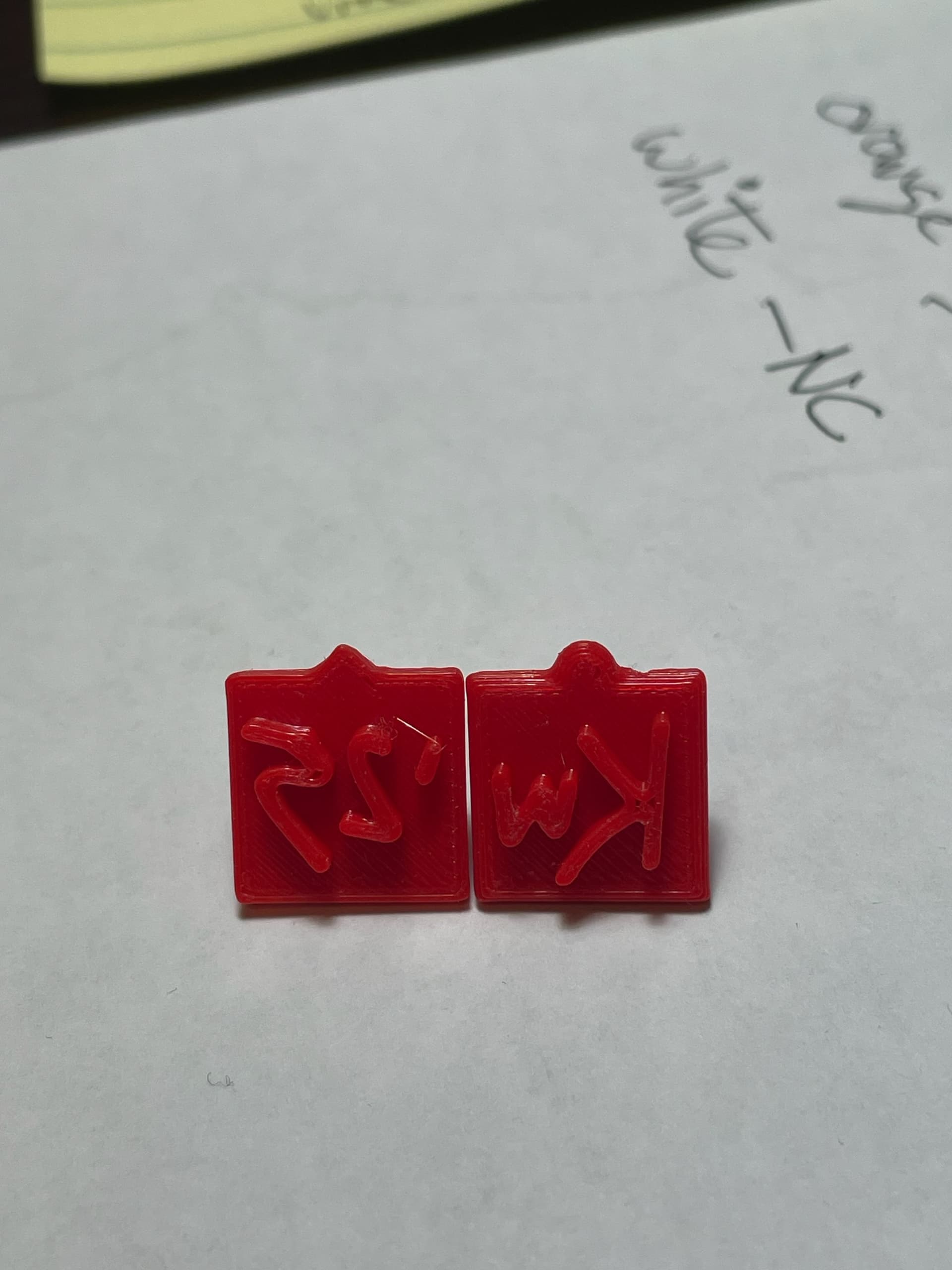

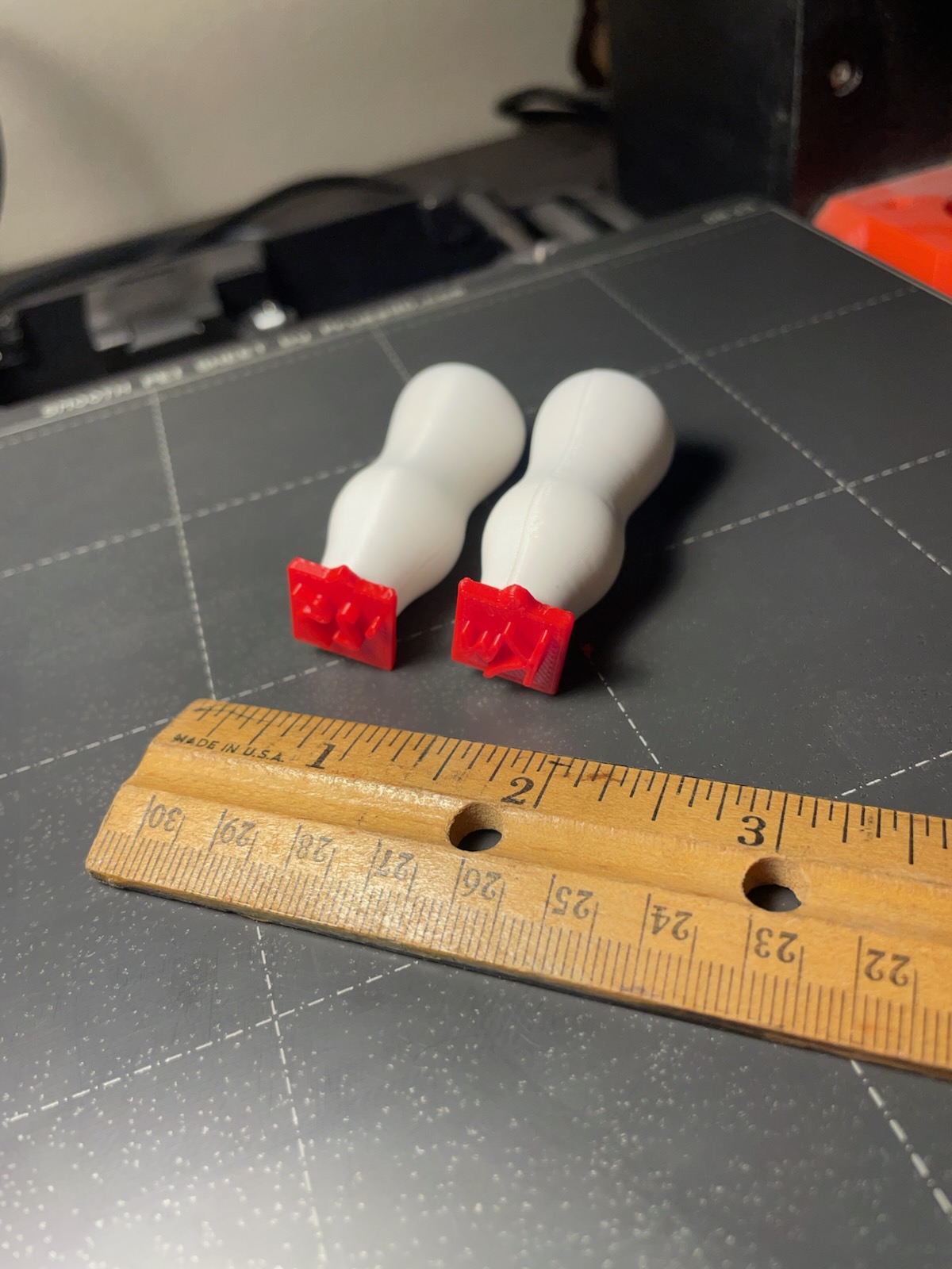

  • She has been scratching her initials in the bottom of her clay work, and I thought she needed a set of marker’s marks. So she scanned in her initials and the year and I made two 3D printed tools, one for her initials and another for the year, to help her make her work a little bit more professional. They’re only 1/2" square so I added handles too.

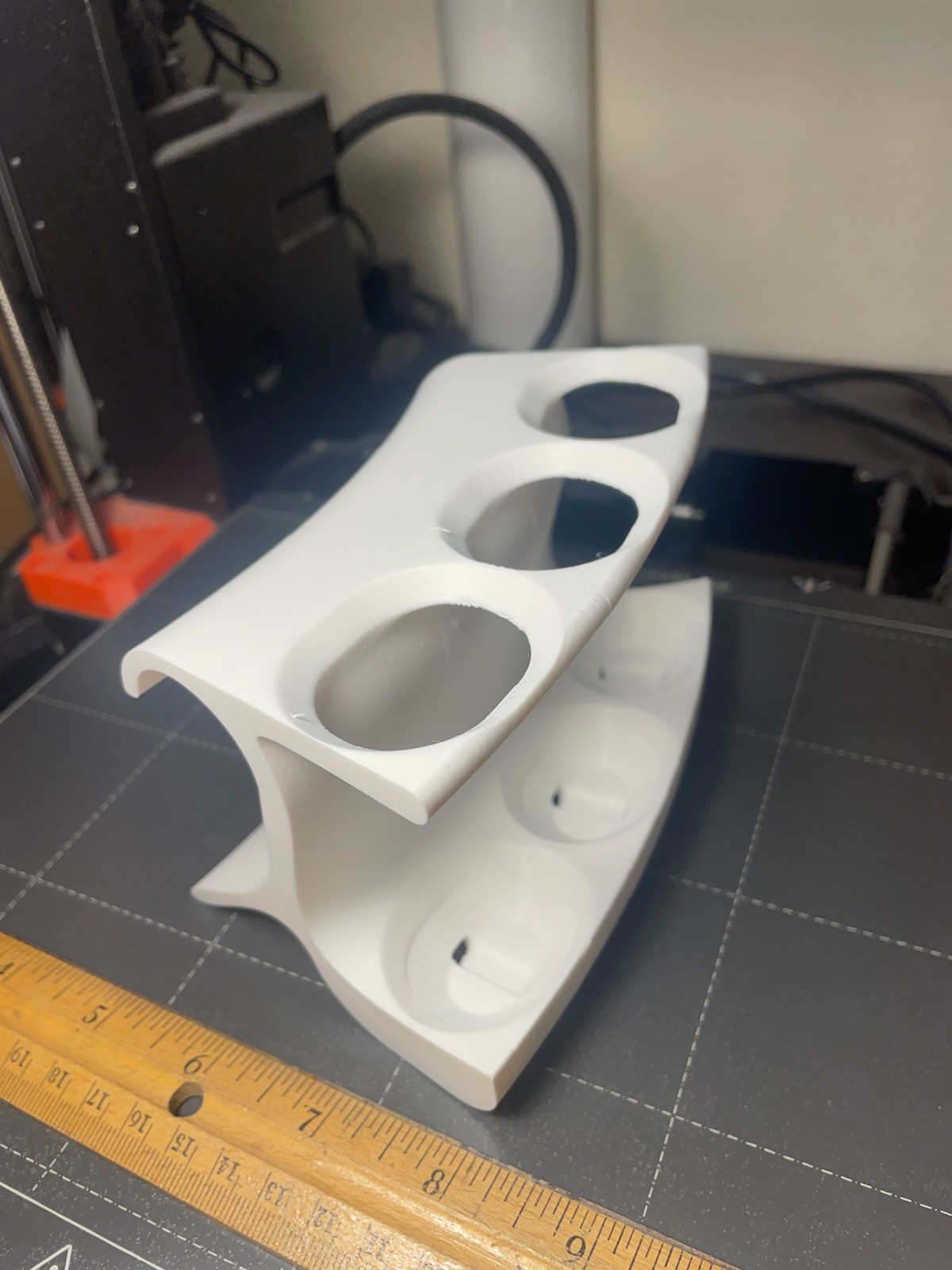

  • She’s enjoying working on the wheel, but she asked if I could print her a tool holder from the internet that fits over the curved splash guard. She has some custom tool holders we are designing together to hold flat card-like tools. So there is more to follow…

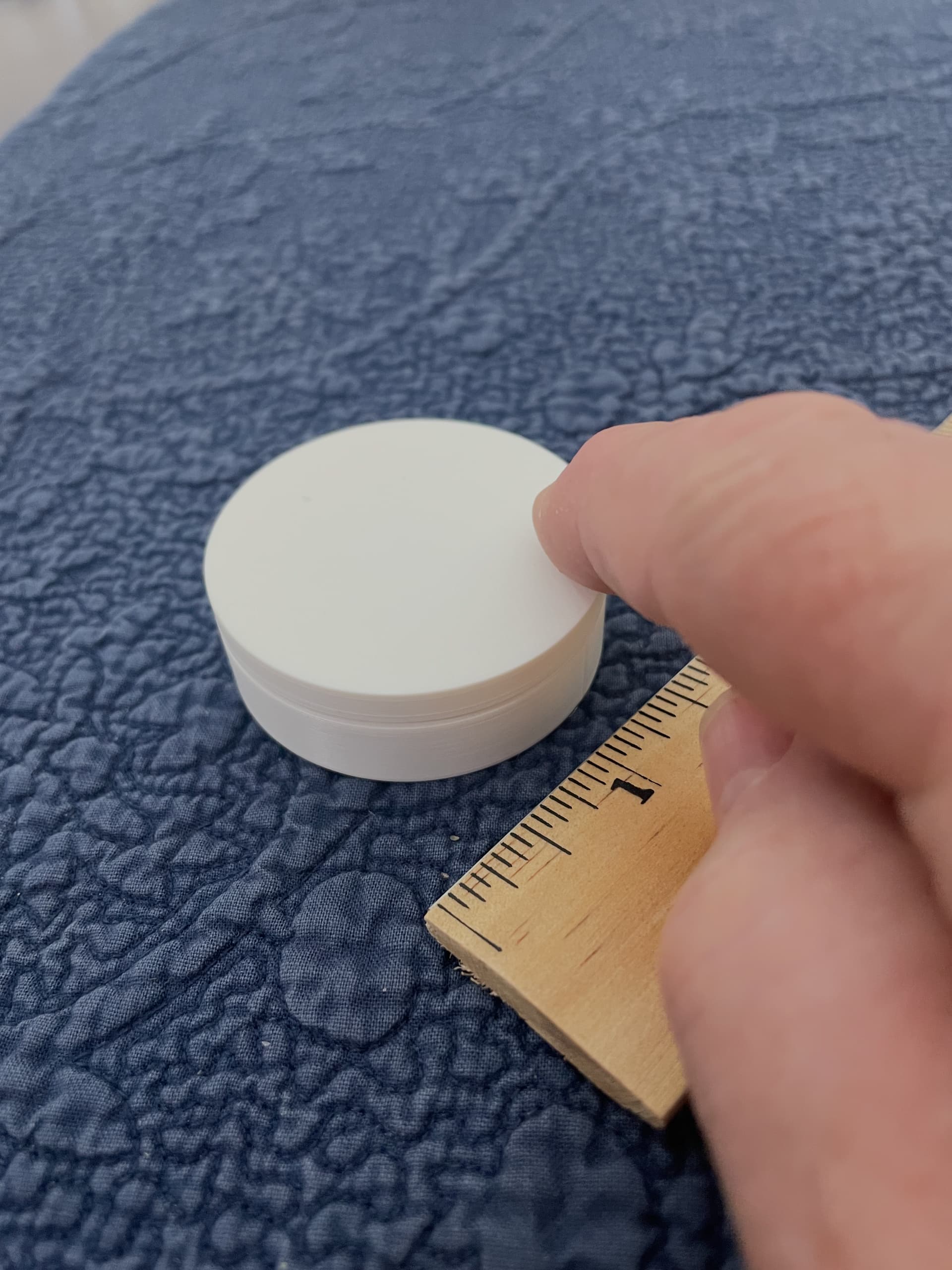

  • Finally, she saw someone using a trimming spinner in a video (see below) and asked if I could make something like that. Because I have a number of roller-blade ball bearings (8 mm inside 22 mm outside), I modeled up some spinners in CAD, exported to STL files and 3D printed them.

I’ve found that the Resin printers give better results than the filament printers for marks.
