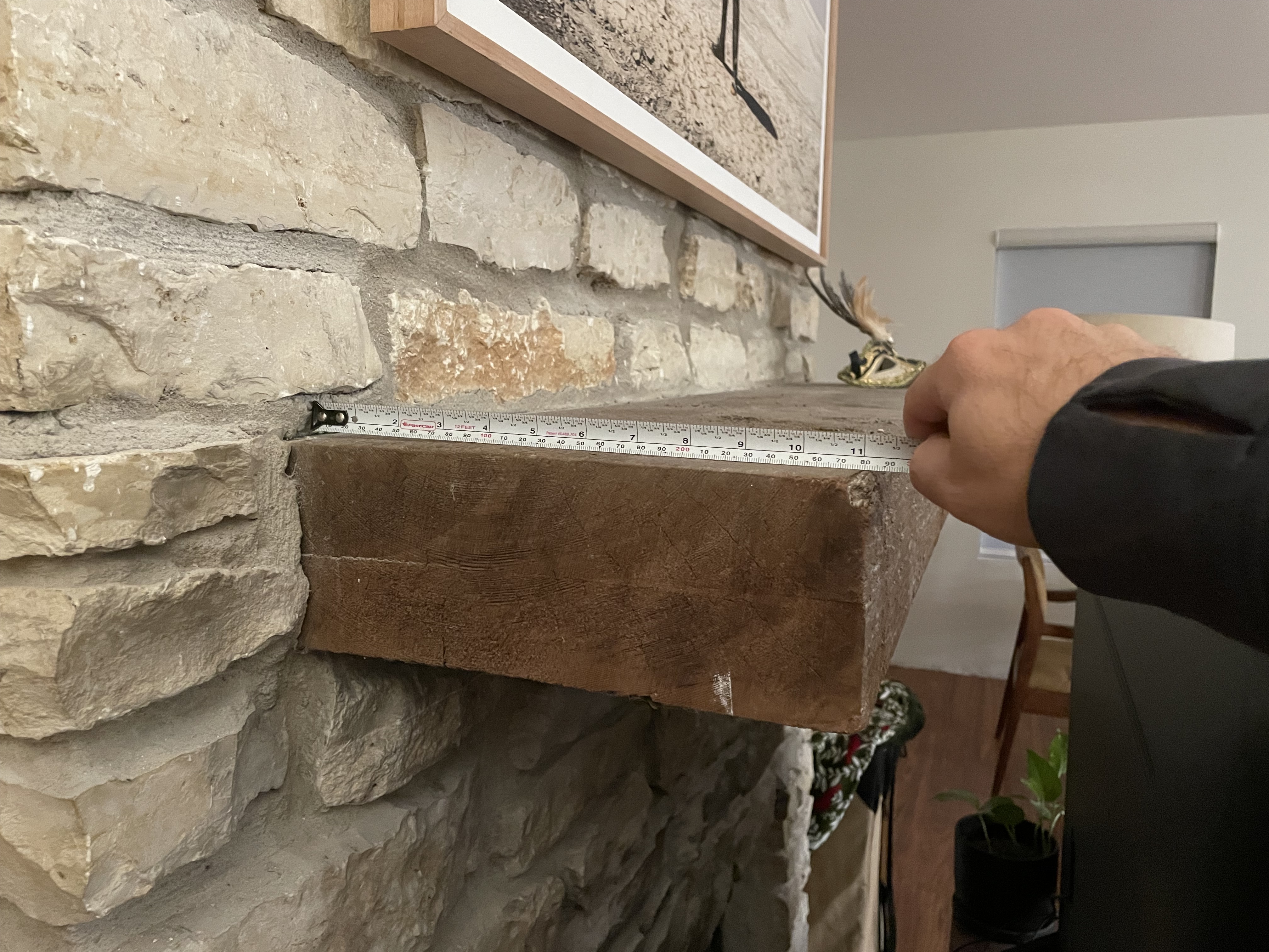

I have to point out that 18” deep is the deepest mantle I’ve ever heard of. They’re generally 6-10”.
18” will be very heavy. It will require a much more significant bracing structure, both to support itself, and the possibility of supporting anything you place on it. And it will be considerably more expensive.
Your average sitting bench is typically 15” deep. My mantle at home is 11” deep and I have concerns about its structural integrity.
