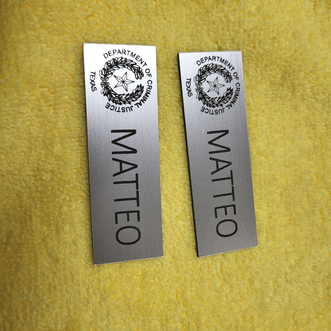

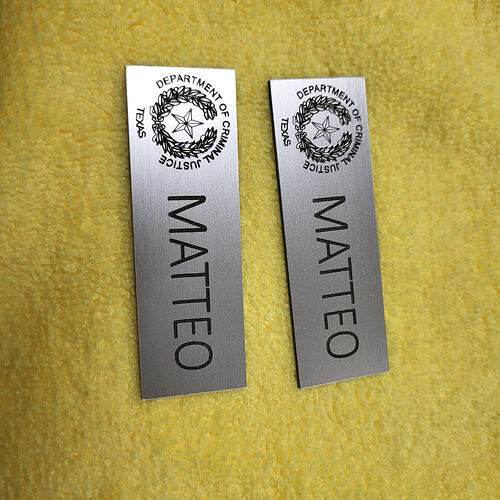

Sorry about the confusion. Plastic laminates are made of ABS plastic and you are correct about the chlorine fumes/solids. However, the Romark and Gemini plastics are made of high impact acrylic and designed to be safe in CO2 laser machines. Both brands have been around in the engraving circle (trophies/plaques) for a while with Gemini being the newbie affordable version. You can look up their websites for the composition of their products. Gemini does have some power settings in their site. Since either products are alike, the settings should be very similar. Romark is more brittle or not as flexible as Gemini. Gemini has some nicer modern colors. I can provide you with some samples if you want to add them to the material library or play with them. Often now days they’re used for signage on doors in buildings and name plates.
Here is a sample of a name plate using Gemini plastic done on pearl. One was rastered throughout, one the TDCJ seal was engraved using a vector setting (left side) for a cleaner look.
