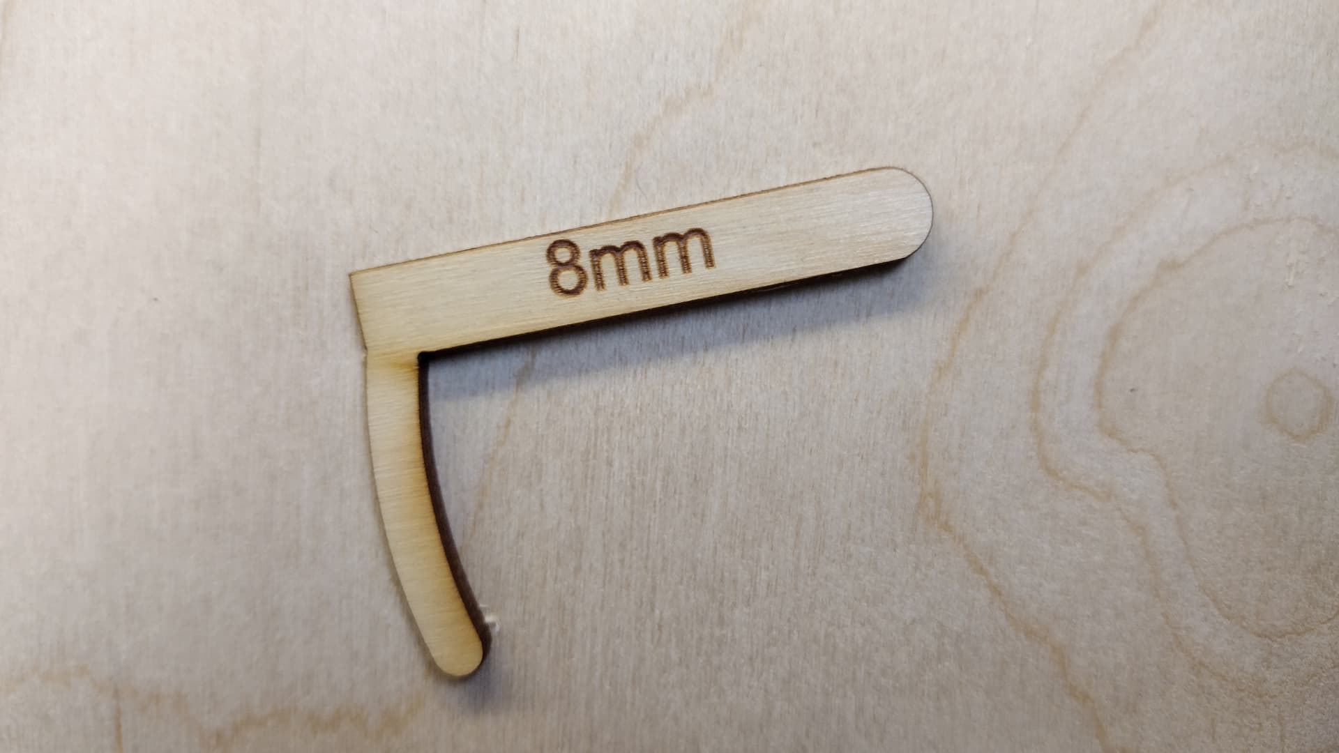

I was using festi.info to make some trays and inserts. I use this site a lot. Yesterday, I was poking around, and came across laser holdfasts. So I cut some out. Wow. I’m sold.
I’m at another makerspace for a couple of weeks, so the dimensions I used were for the grid here. It may well be the same as Tarkin, Dorian and the others.
Preloaded values from festi.info, but 8mm shaft width.
They work best when the shaft is away from the material, and the hook is touching the edge of the material. I used 3mm BB. Magnets will still have their uses, but these things hold the edges down great.
On this laser, they work X and Y orientation, plus they can rotate a bit. Press down firm on the top of the shaft.
To release, push the edge farthest from the hook. You might need another hold fast to help, if it’s in firmly.

We can cut dozens out of scrap. We might want to try some 6mm plywood. It’ll need a smaller shaft dimension, but it should have more holding power. Useful for thicker material.
I cut a handful for Dorian and have been using them extensively. Be aware that the honeycomb is different between Dorian and Tarkin so what works on one does not work on the other. Due to their size we need a tray to hold them and will cut one this week or next.
