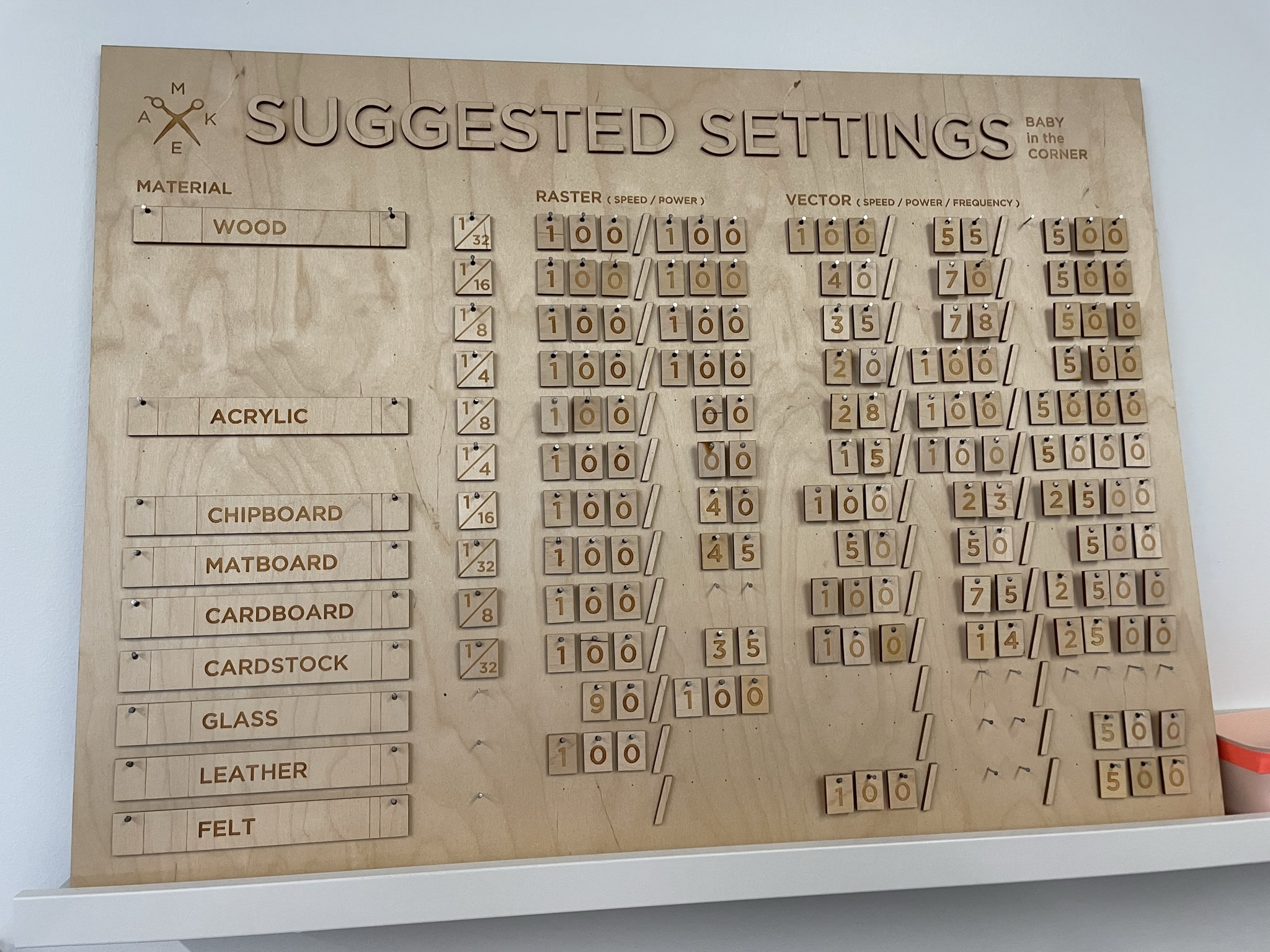

@DirtHurt is working on making a keychain of settings to keep at the computers. I also saw this neat sign at MakeATX I wouldn’t mind making our own version
OooOooooOoOOooooo I dig that!
But also yes, time permitting I’m planning on making some test grid swatches of a bunch of materials for rastering and cutting on Dorian.
Each pair takes about an hour so I’m piecemealing the ones I have time for inbetween other stuff
