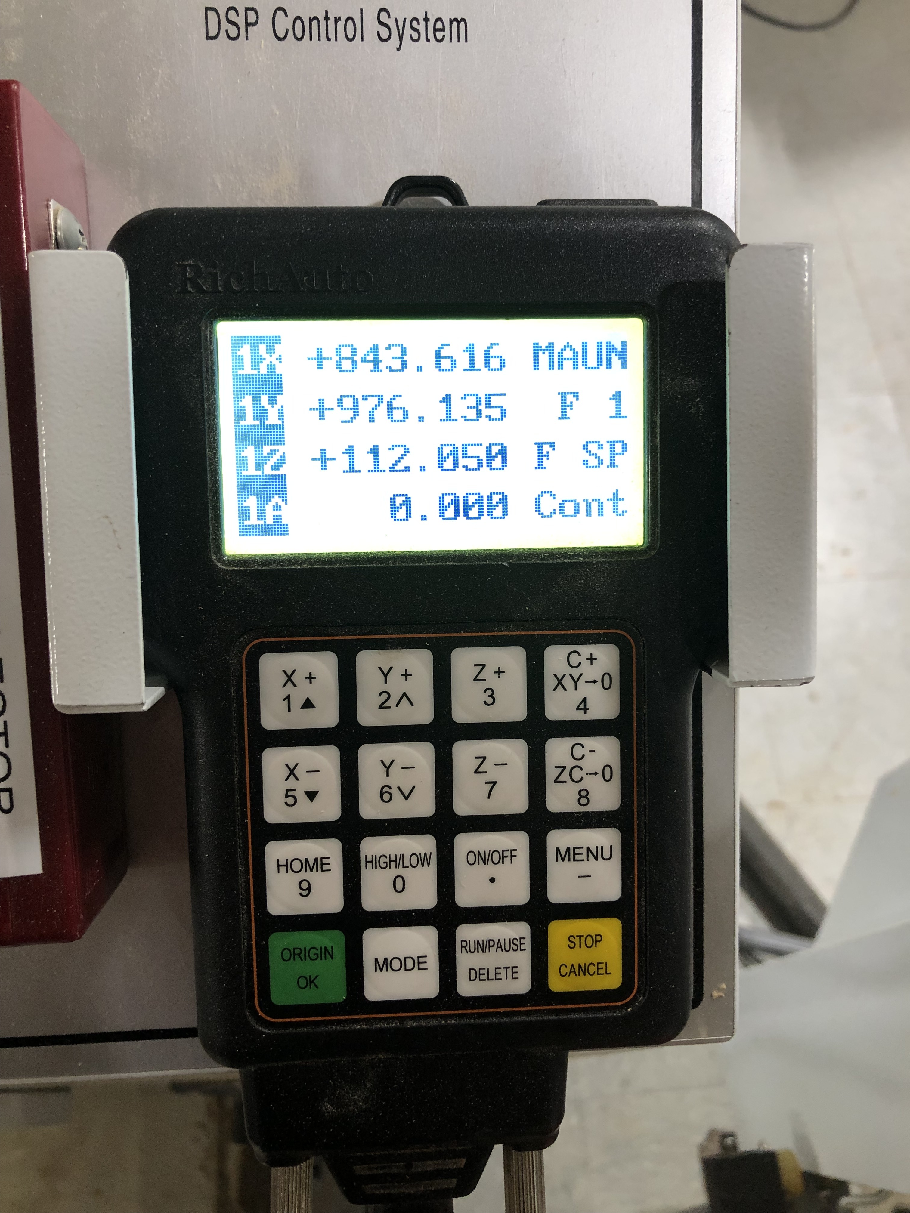

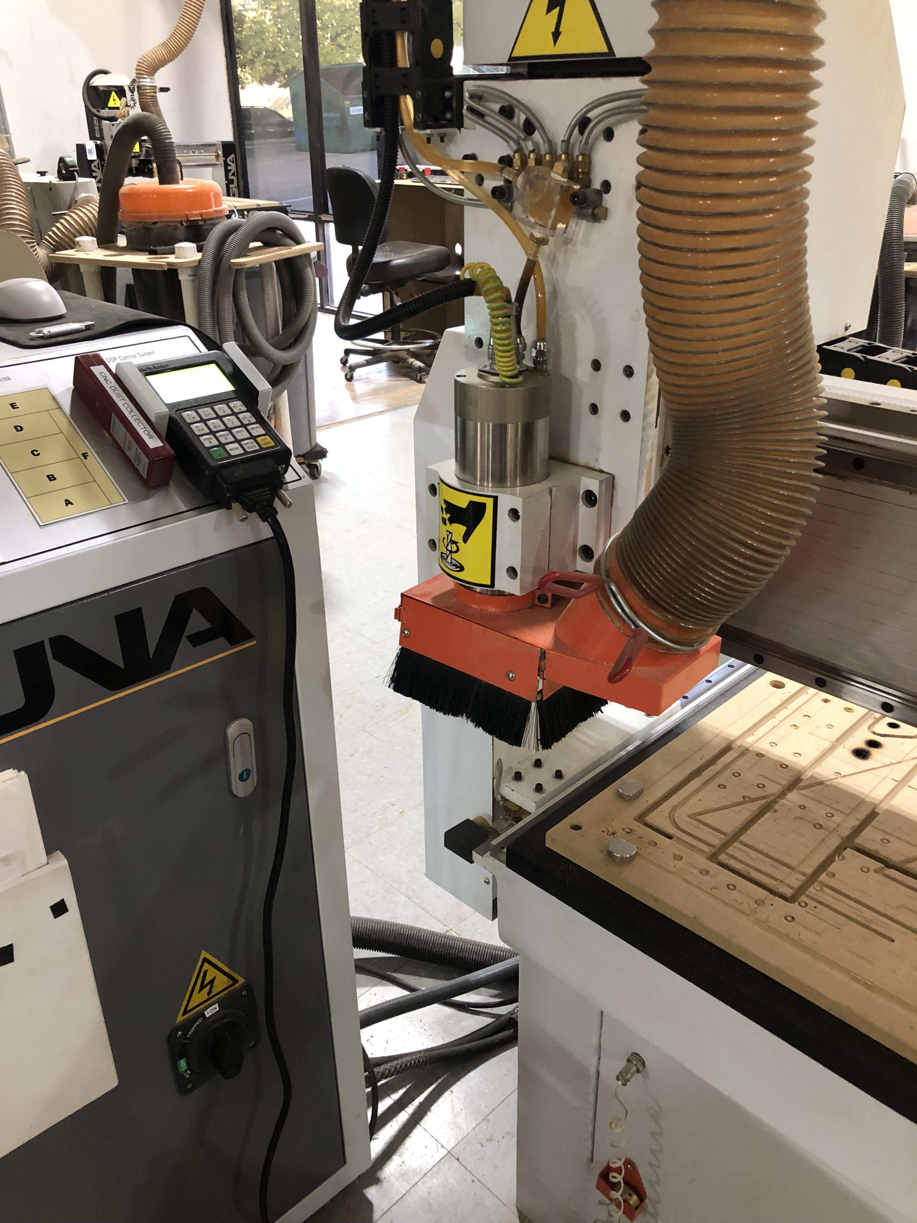

Hi! I just turned on the CNC and went through the homing routine/sequence. The gantry crashed into its ends (X & Y) without triggering the sensors resulting in forcing the motors. I restarted the machine and did the same thing again with a weird knocking sound in addition. I don’t know how to trouble shoot the CNC nor looking into the settings to reset everything. Don’t want to mess it up some more. Turning the machine off.
Looks like the homing sensor on the x axis has been broken. It snapped back into place so the machine is functional for now. Thanks for reporting it.
