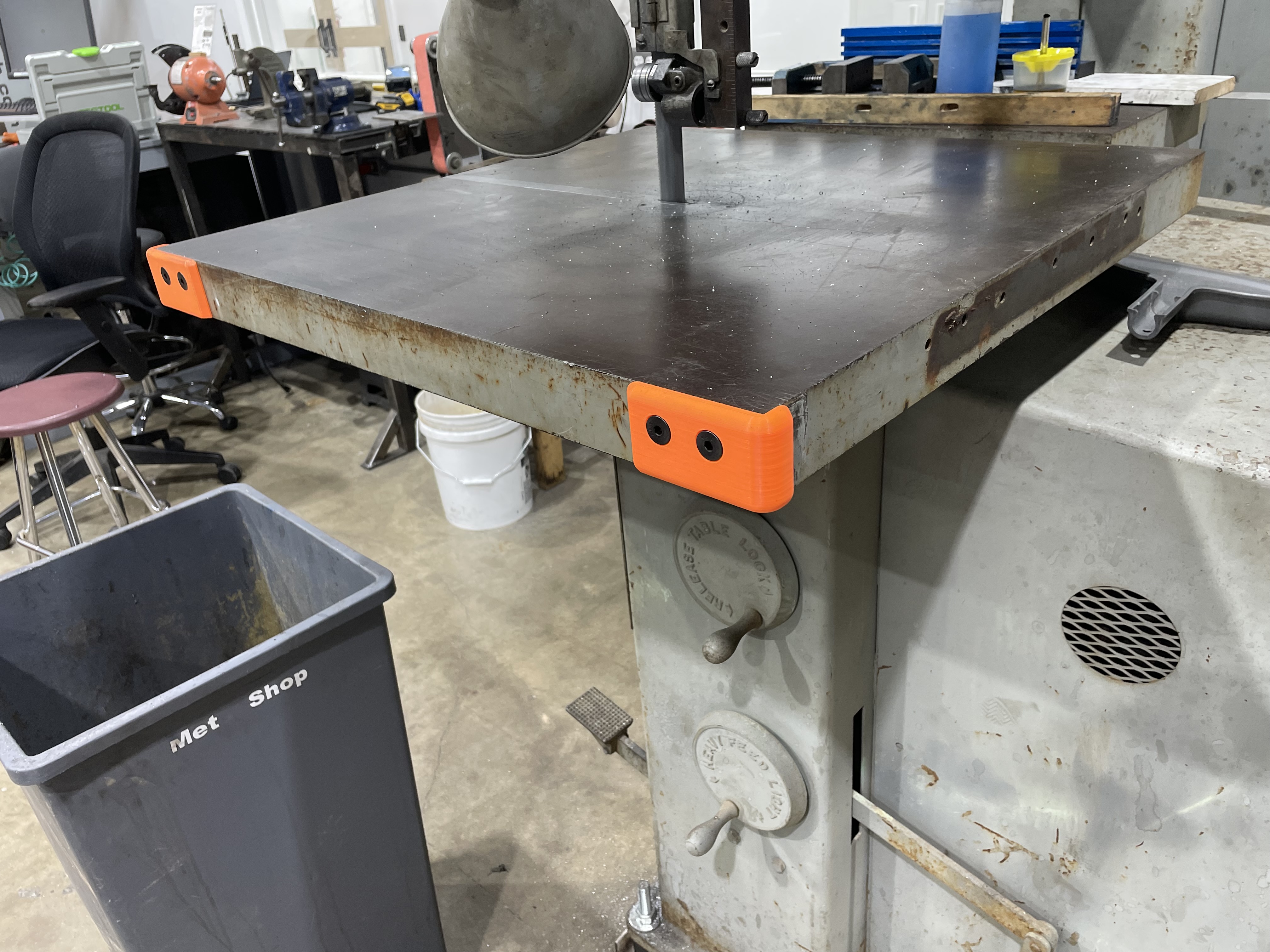

First, @dannym noted that the foam I had stuck on the corners of the DoAll table a couple years ago to protect people wasn’t really sufficient for the saw’s new location. So he designed and 3D printed these bumpers. They’re bright orange for visibility, and nicely rounded so you won’t injure yourself if you run into those corners.

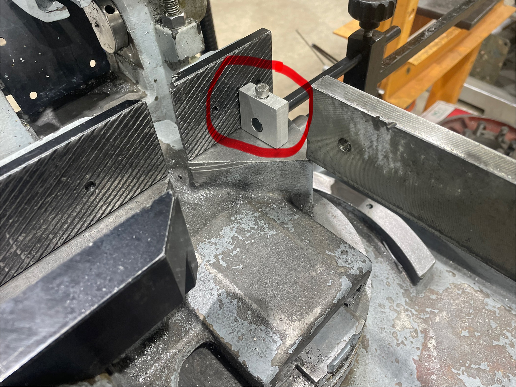

Next,@atwatsoniii saw that you couldn’t use the stop on the cold saw on thin pieces. So he made this end-piece for the stop that will work on a much wider array of sizes.

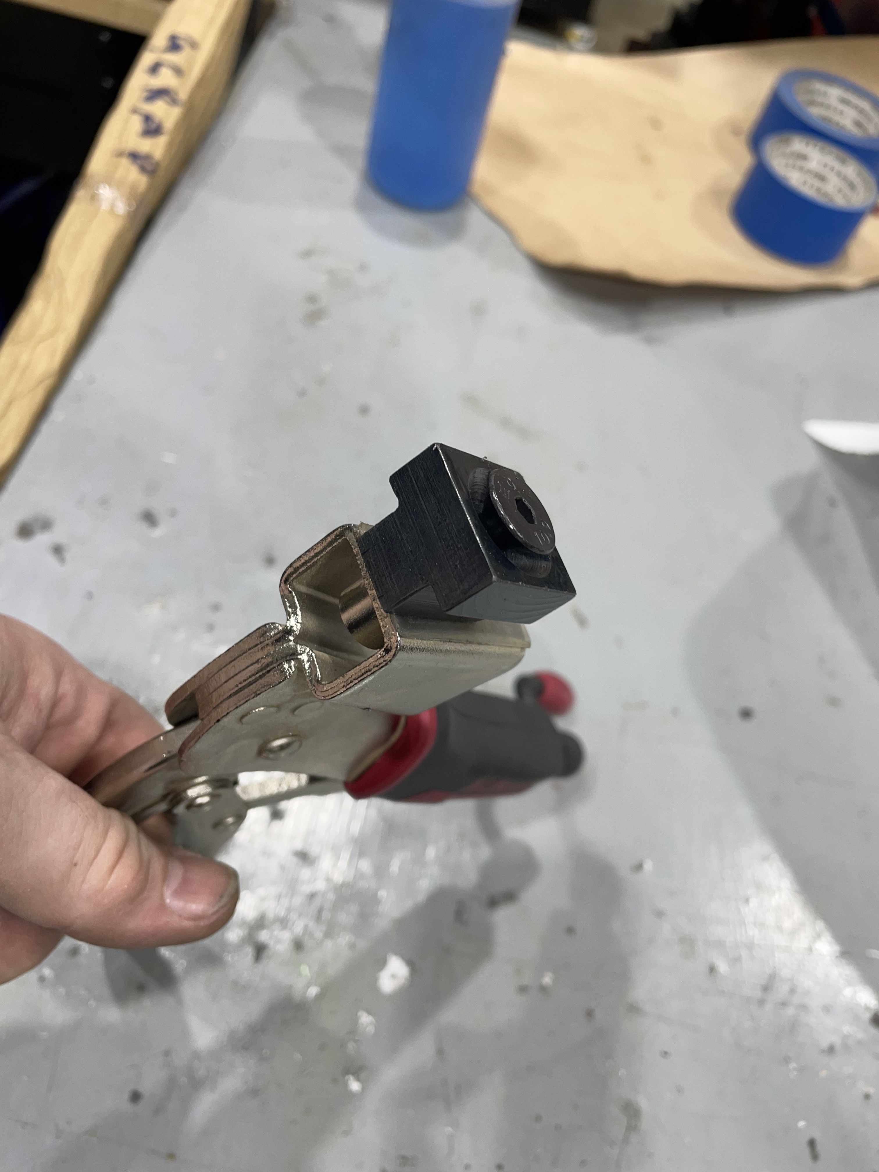

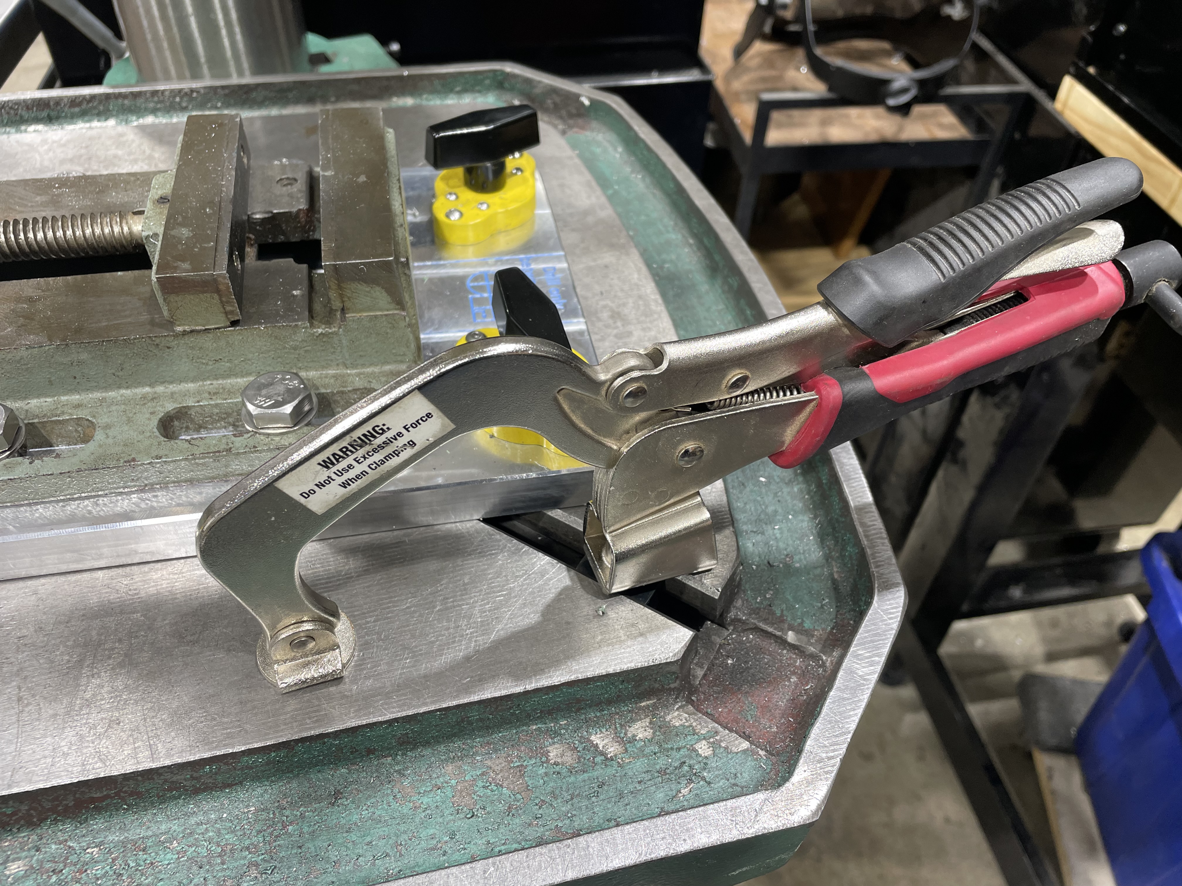

Also, @Julie finished the tee-nut project I mentioned before; we now have two of the vise-grip style clamps to hold things down securely on the drill press.

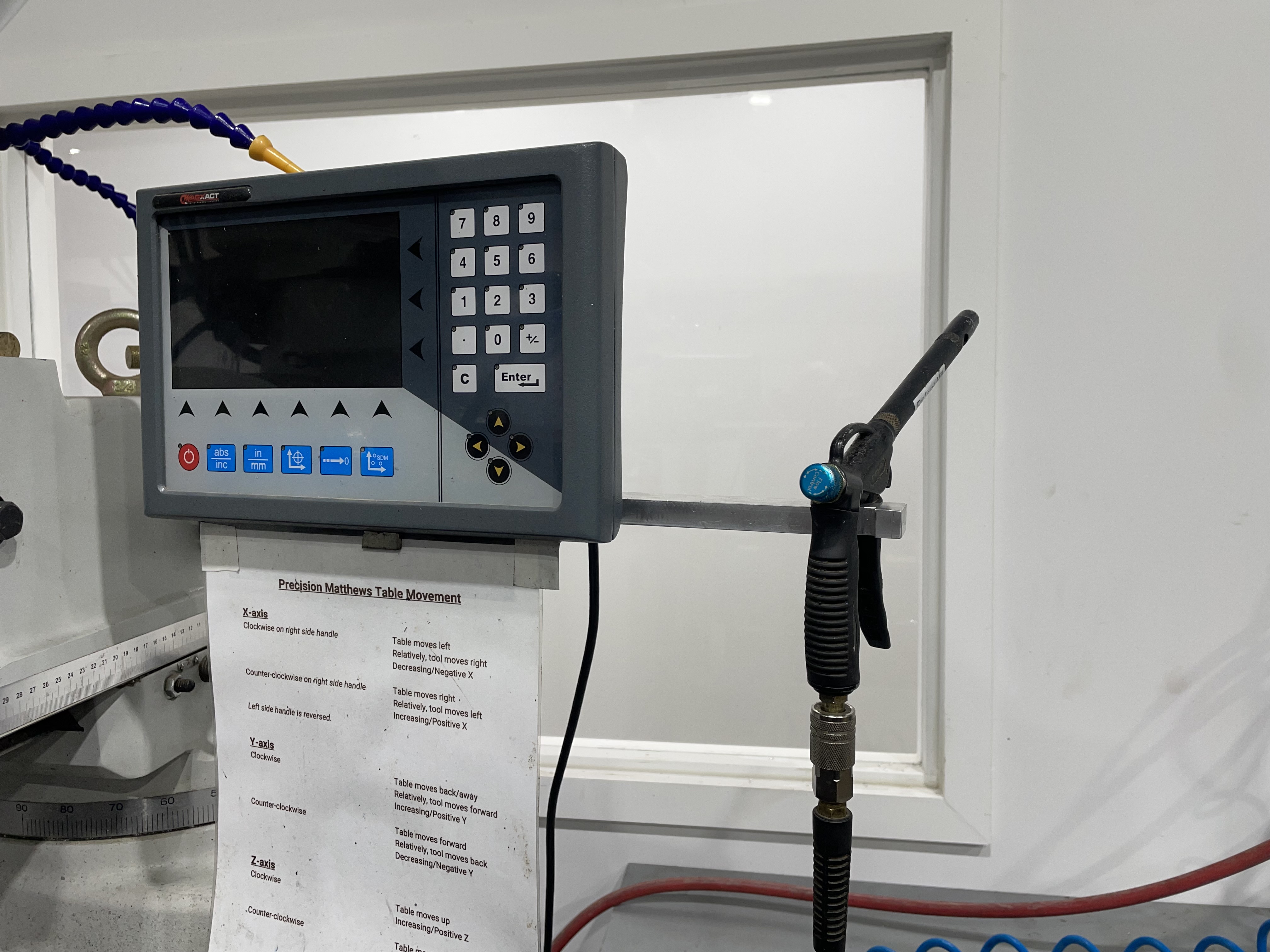

And not to be outdone by my own stewards, I finished this support for blow gun on the large mill. Now it has a proper, accessible place instead of lying around wherever it had been left.

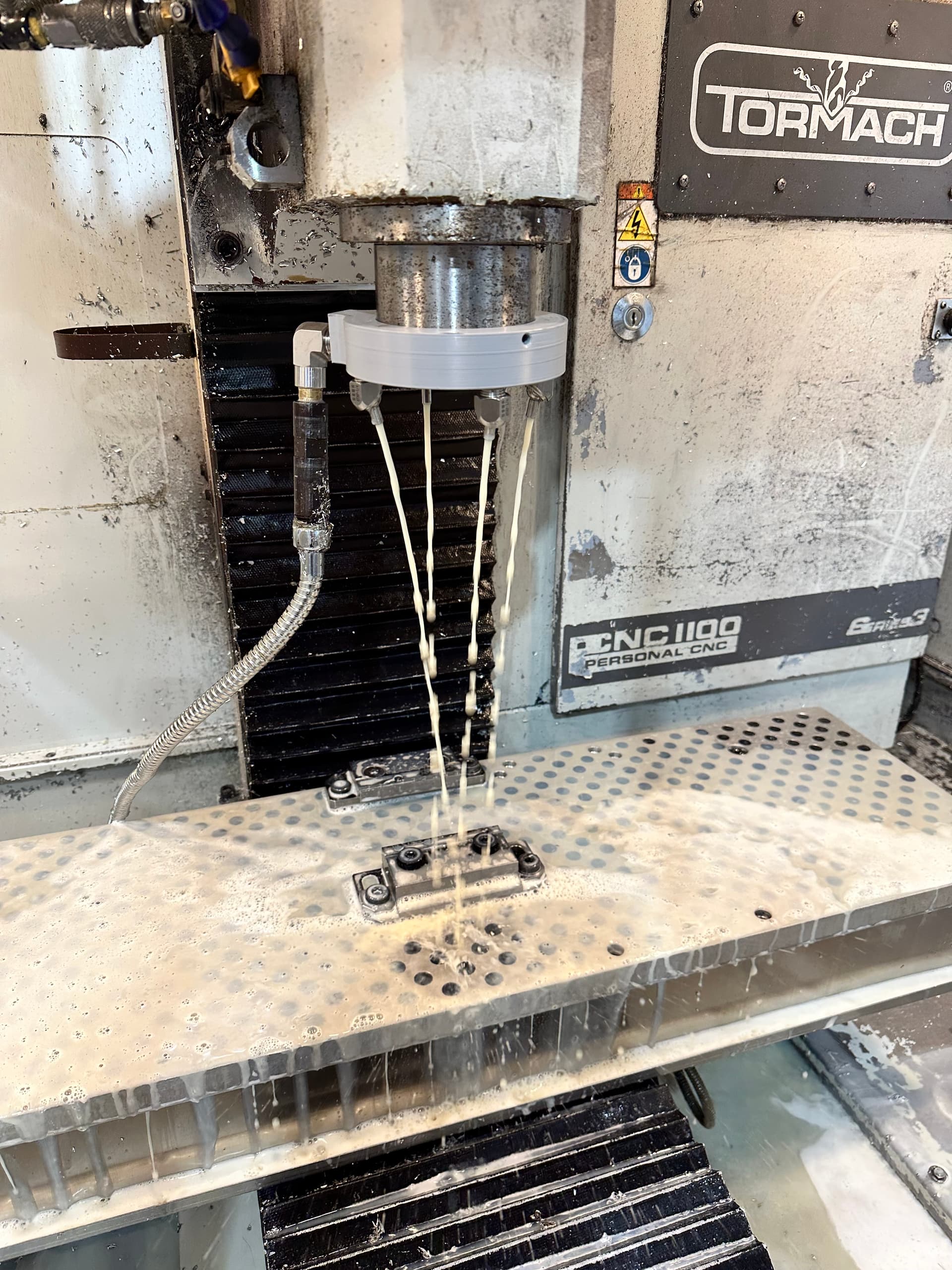

I also tried to upgrade the Tormach to have this prototype coolant ring. Unfortunately, the coolant pump just doesn’t have enough flow for even one more nozzle.

:eyes: I use the coolant on the tormach a lot! will be glad to try to utilize this, its so finnicky to get the coolant and air at the right angles esp since the air hose is so flimsy
