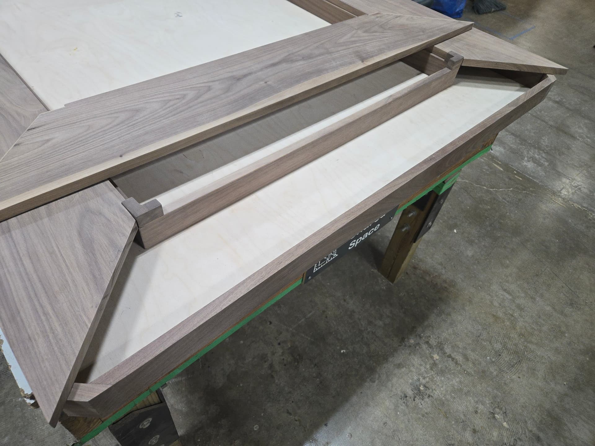

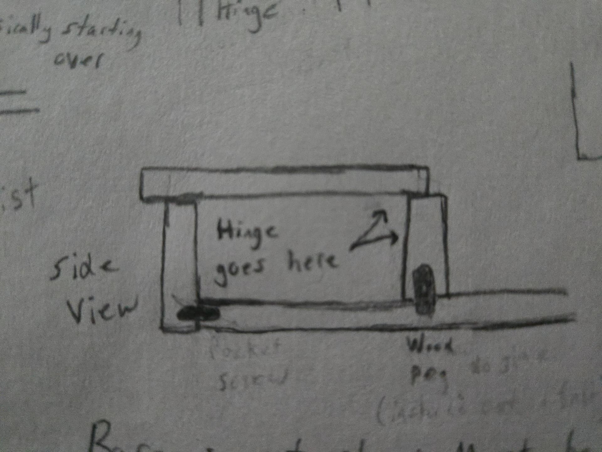

Right now I’m trying to decide how to attach the top 4 boards so that they are removable so you can store stuff under them. Original idea was to use invisible cabinet hinges, but after prototyping the idea, it simply wont work (i mean i could use more expensive 170 degree hinges with short profiles, but i’ve already tried 2 different hinges, and it just adds more complexity + failure points)

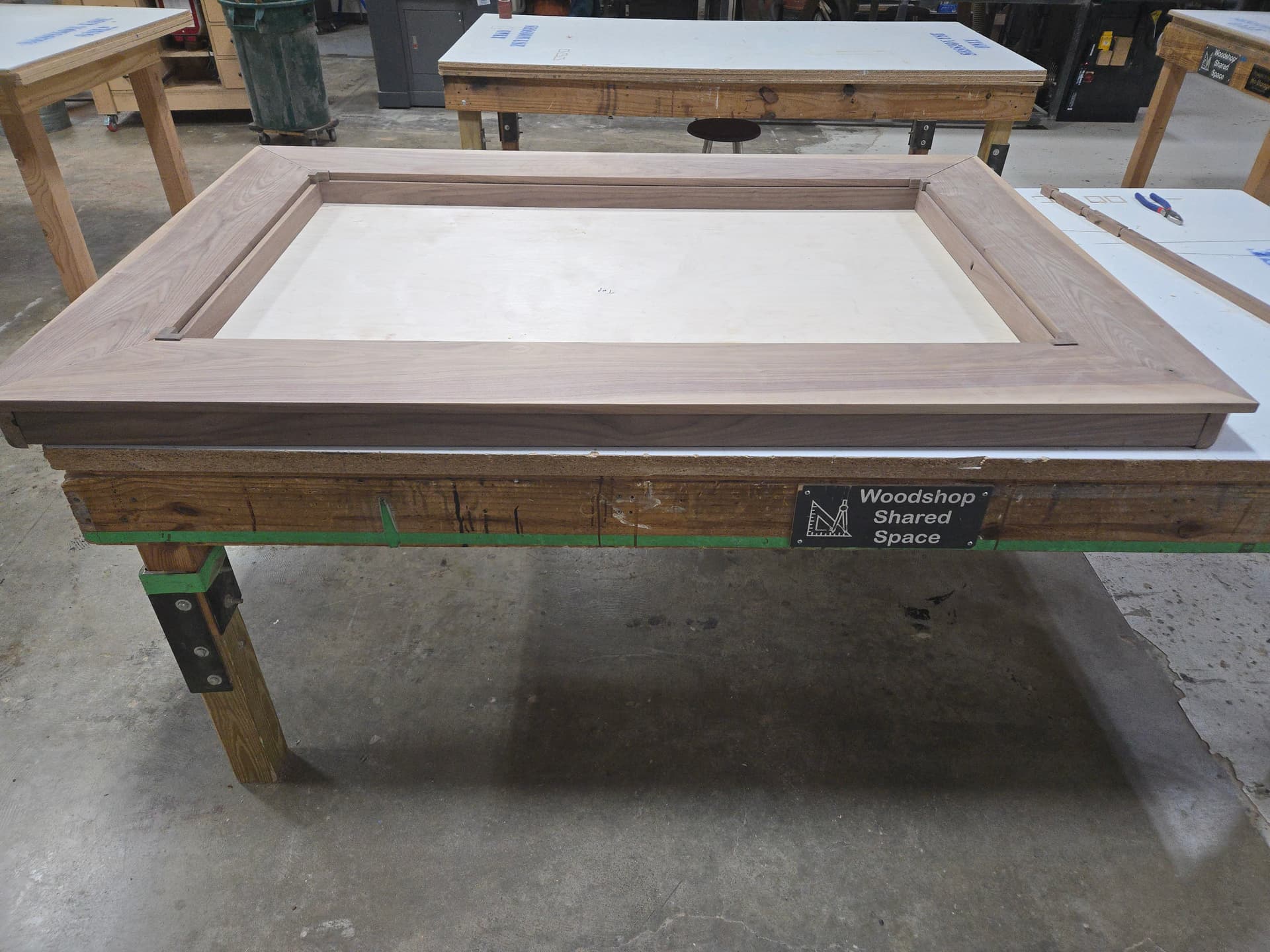

This is table assembled currently
These top panels will lift off for storage space.

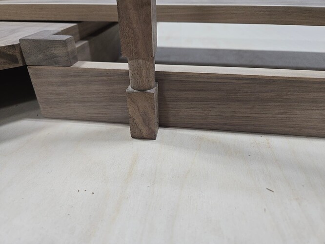

Current plan to cut this cylinder part in half to create 2 pegs with square bases that the tops will slot on to. Going to have all the pegs up against this internal wall to give the wood space to expand. Will probably use 3 or 4 pegs total for each of the 4 top pieces.

The top sits on half of the interior wall. The other half is for the inside cover tiles to sit on. So to hinge open the top piece has to hinge up and back to clear the interior wall it sits on. I also only have 2” of space on the inside for the hinges to attach to.
So maybe something like this https://www.amazon.com/Chibery-Overlay-Concealed-Replacement-Cupboard. But its hard to tell if the hinge would have space when closed, or if it would allow the top to sit flush on top of the inner wall.

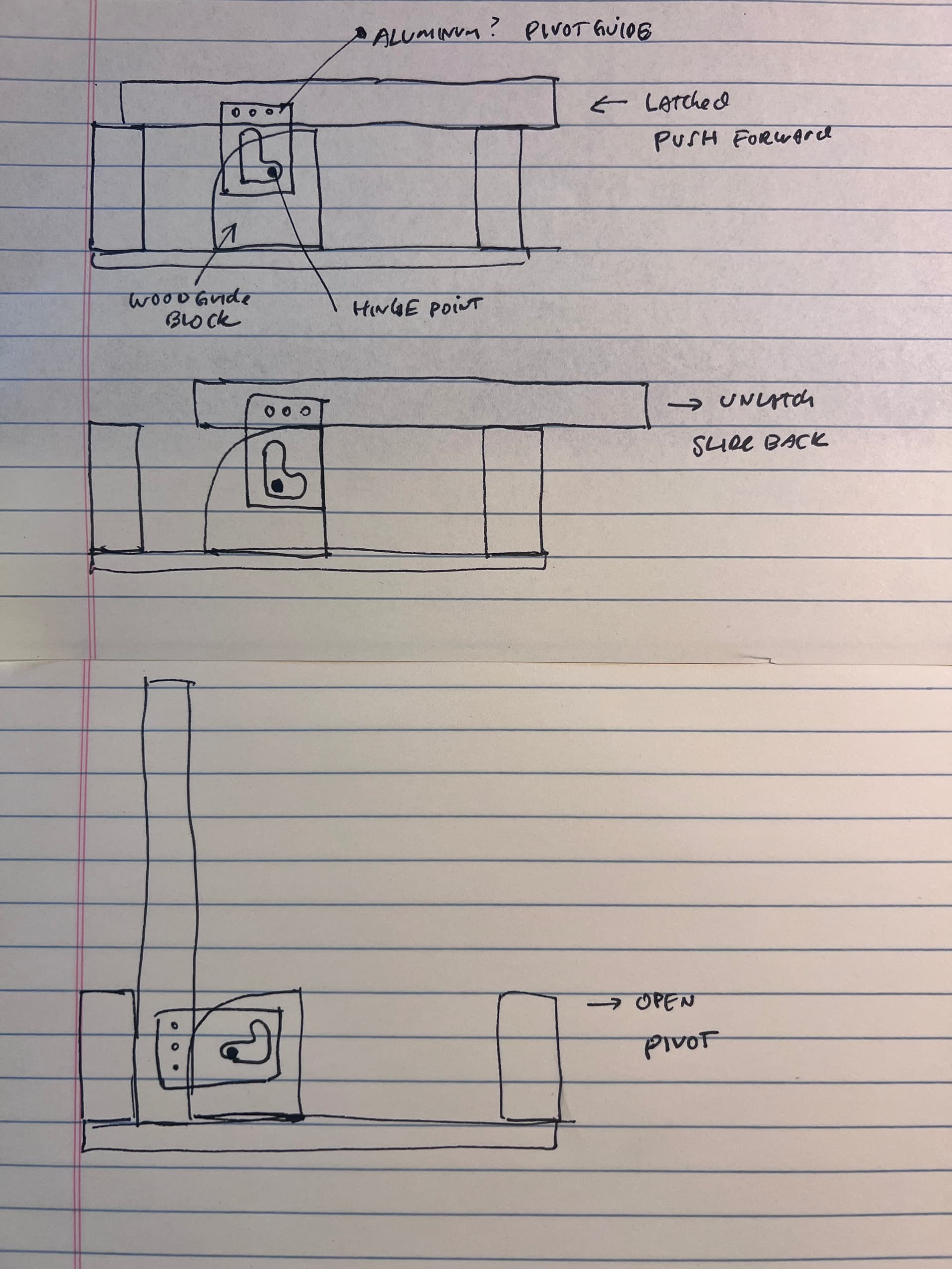

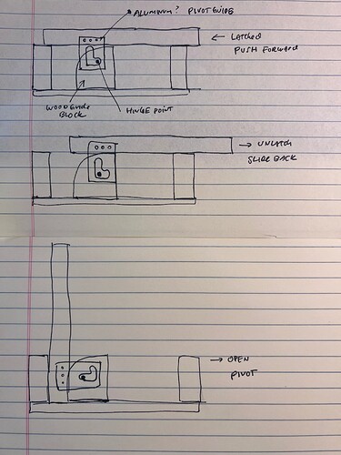

I thought of this much more custom than off the shelf idea for hinging and latching the tops as well. Would have to address the interference from the miters on the ends though in the open position.
it would take some 3d modeling to work this out, but the gear hinge should be able to do that.
there are variables to work out- in addition to diameters and spacing, you have freedom to set the door side gear’s location and wrap the moving lid to wherever they need to be
like if you mount the door gear directly below the fixed one- call that six o’clock- it will swing right and up as it rotate counterclockwise from that picture’s perspective
