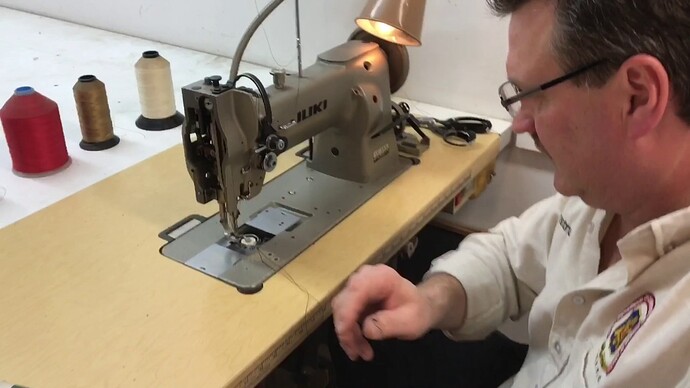

watch the video:
This whole video is great but of particular interest is his description of what needs to be lubricated and when. The video also covers winding the bobbin, threading the machine, and other topics to safely use the machine.
