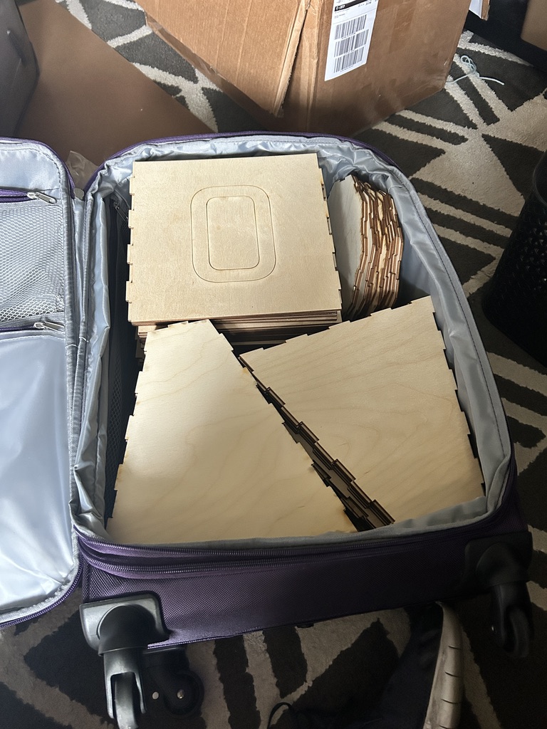

This project was quite ambitious, as I was up against a pretty limited schedule (I had only three days to complete the design work and get the parts cut before I had to leave Austin). Also, I somehow needed to fit everything through TSA, meaning the larger parts needed to be split into smaller pieces that I could assemble during build week. Even with these constraints, I’d say the project went pretty smoothly :grinning_face_with_smiling_eyes:

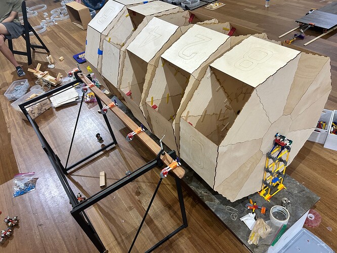

All of the pieces inside of my suitcase

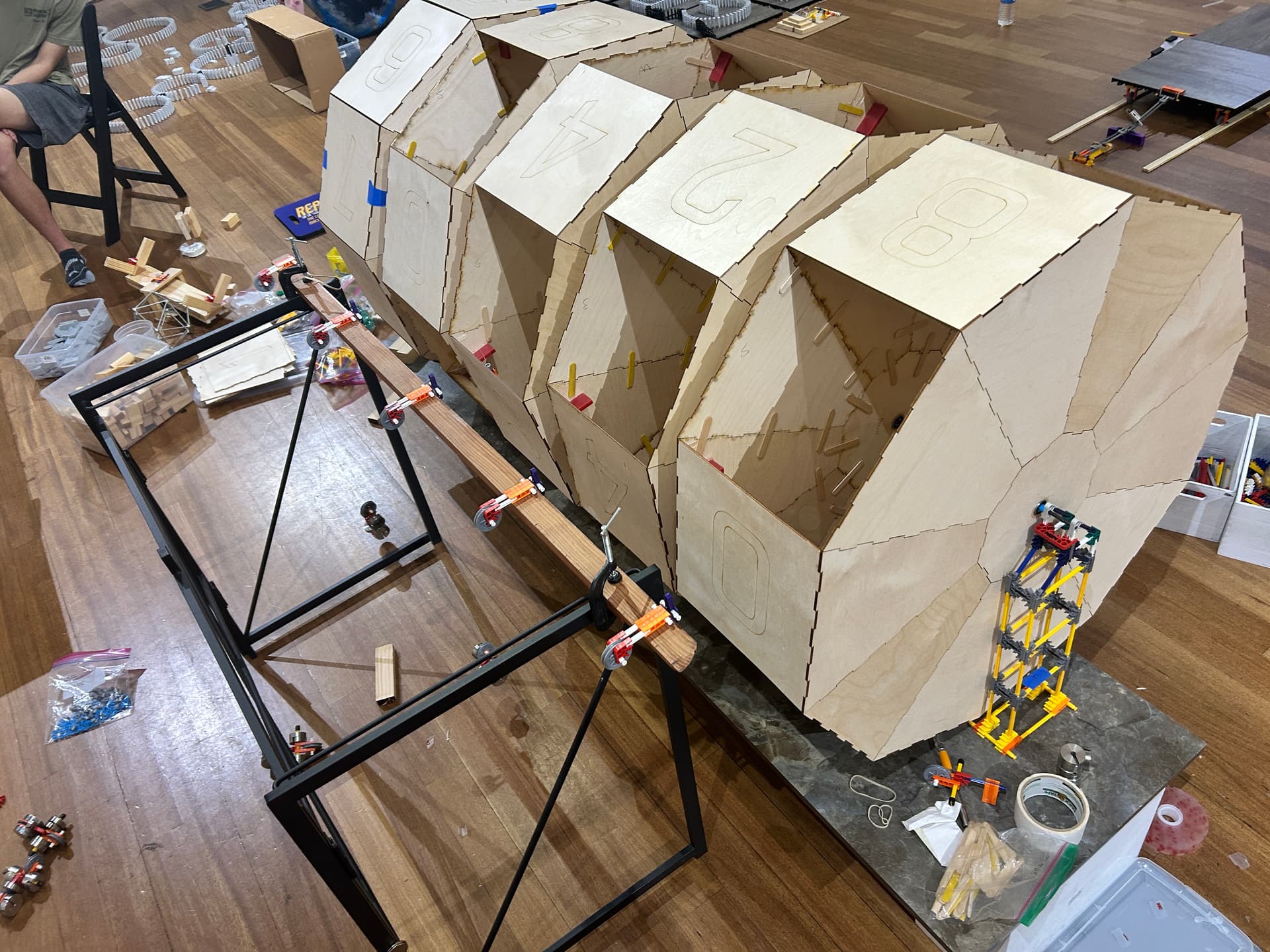

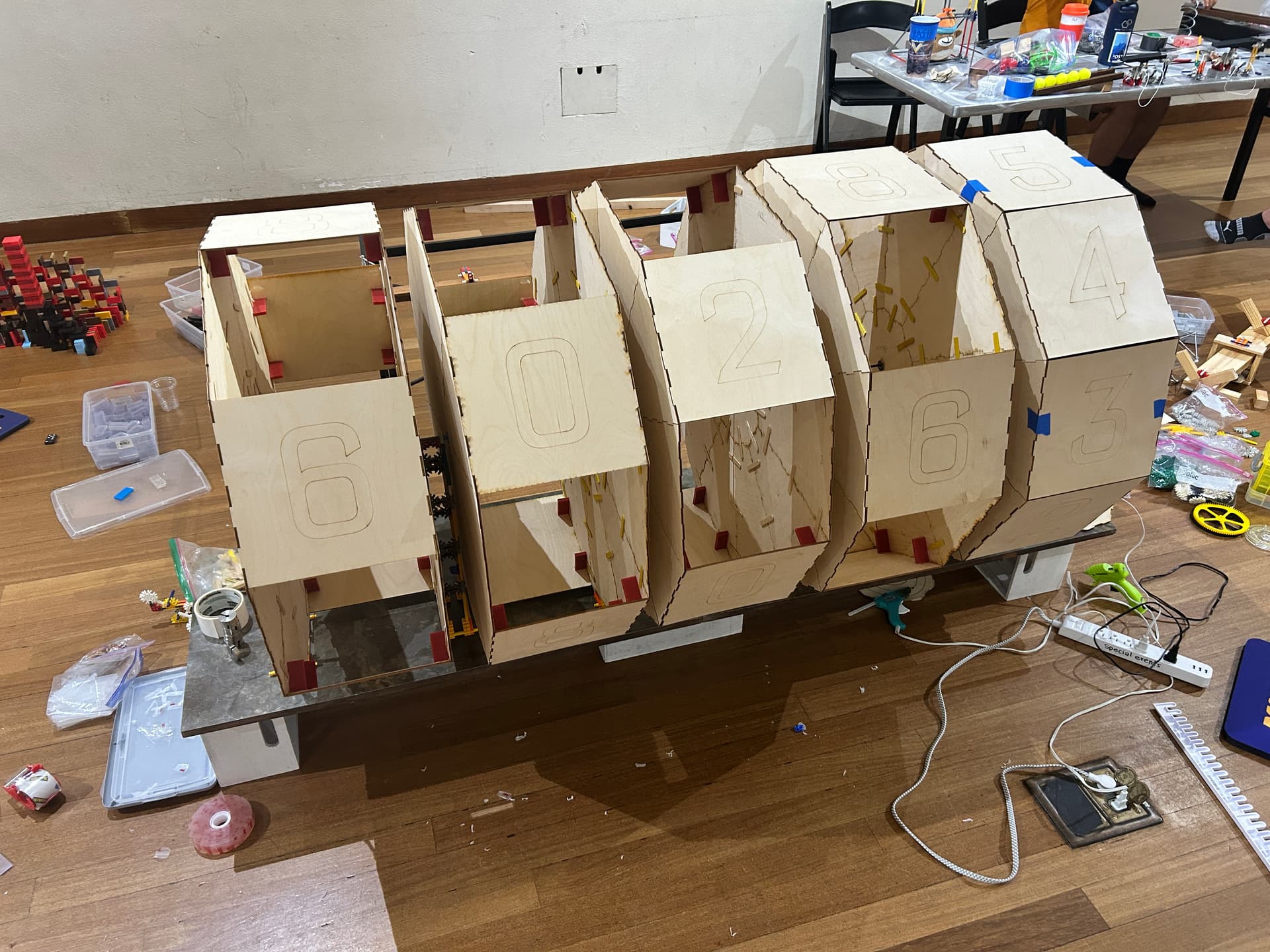

Assembled wheels on mounts

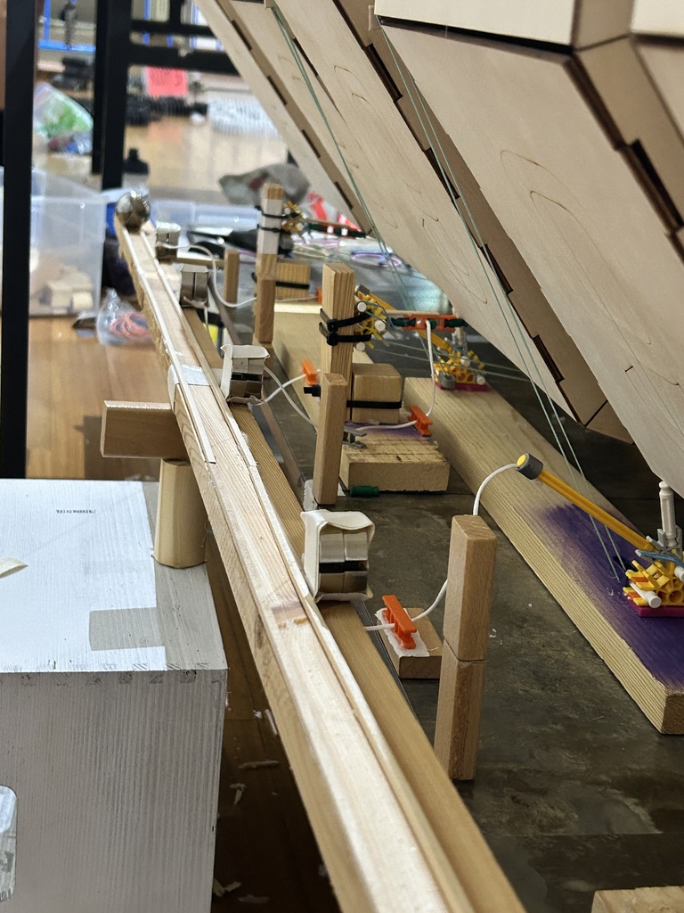

Weight/pulley system pulls fishing line wrapped around wheels to rotate them
Release lever mechanisms and sequencing

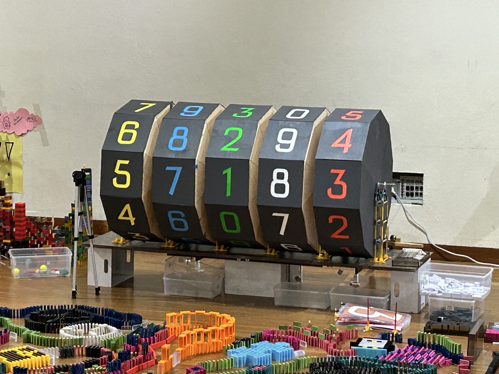

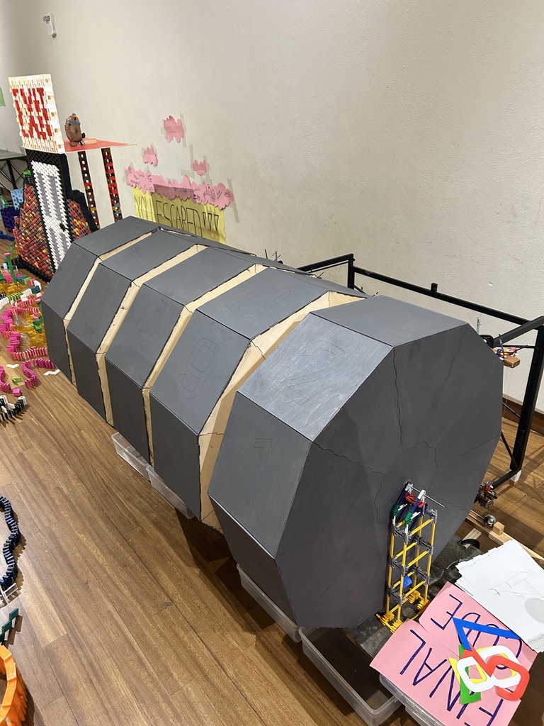

Paint job

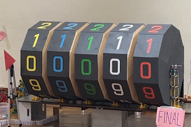

Finished appearance
