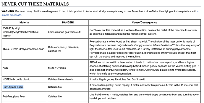

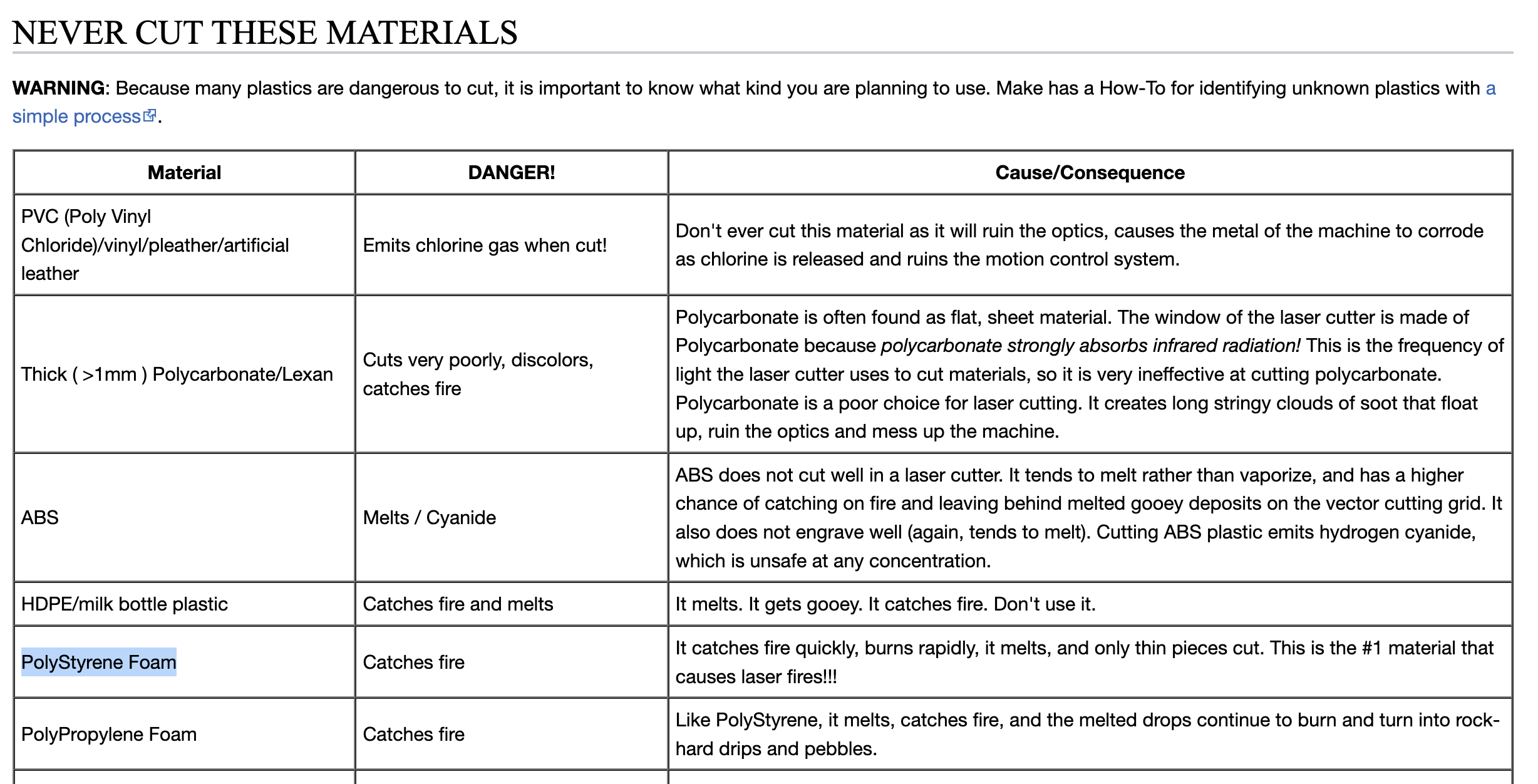

Danny may have better information but it looks like foam board and gatorboard both use PolyStyrene Foam which is on the do NOT cut list Laser Cutter Materials - Asmbly Wiki .
PolyStyrene Foam Catches fire It catches fire quickly, burns rapidly, it melts, and only thin pieces cut. This is the #1 material that causes laser fires!!!
