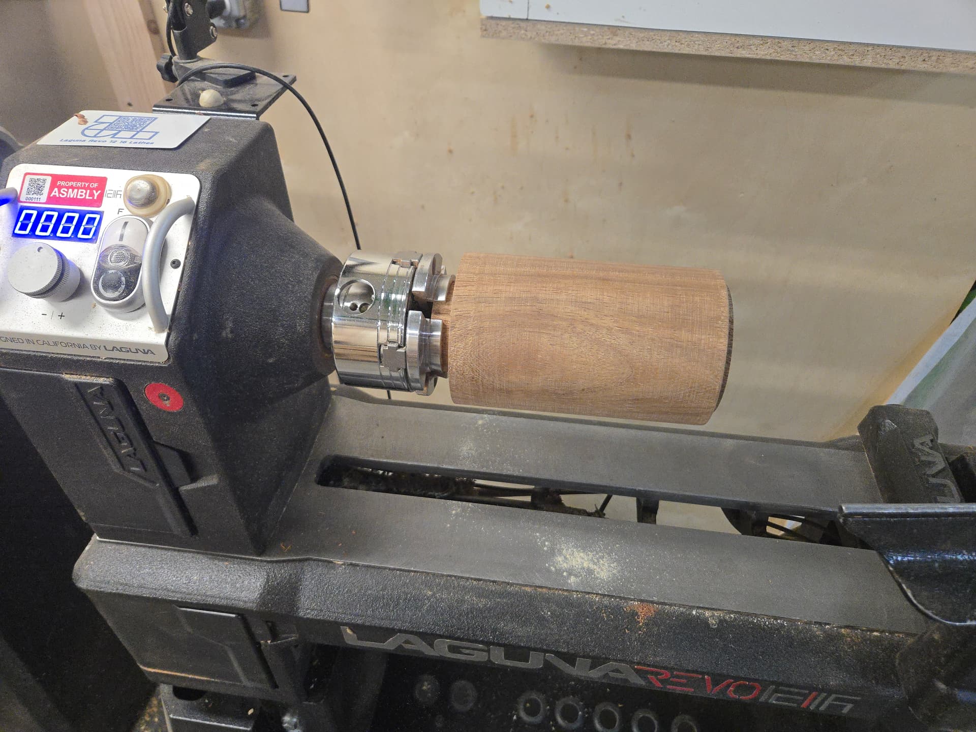

Im making a tall mug thats basically a tall and thin hollow tube with a base (about 7” with 3 1/4” diameter). When I attach it to the chuck and turn the lathe on, it has a bit of a wabble on the end. I cant figure out how to get rid of this wobble. With it its impossible to make the internal wall evenly thick all the way around.
Anyone have any ideas for how to stabilize this mug for hollowing out? I’ve seen people use wheel stabilizer things that you can put at the opposite end of the chuck, but i havnt seen any of those in the shop

I’m wondering how it’s being chucked; if your piece isn’t square in the chuck it will wobble.
i used the miter saw to get the part the chuck clamps on to 90 with the rest. But even when i dont have the bottom touching the floor of the chuck, it still wobbles
i gouged out the part for the chuck to clamp to in the same lathe session that i rouged and sanded the outside. made sure to not take the piece off the lathe the entire session as to not change the central axis location. also added about a 5 degree angle inward to to attach point so it would hold on better
ive been trying different things and the problem persists. Think im just gona have to use a wheel stabilizer. The one in the shop is to big though.

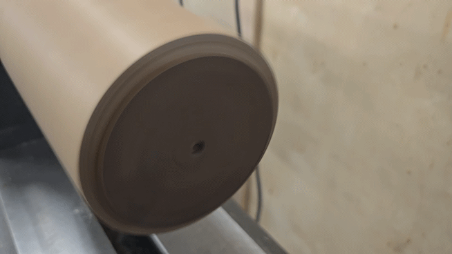

One suggestion would be to try using the tail stock to create a jam chuck (lots of YT videos on the topic), which would force the mug into a stable position. It would be a two-step process: first use the jam chuck to stabilize the piece, then once it’s turning true remove the jam chuck so you can go back to back to working on the inside.
And it doesn’t even have to be anything fancy: I’ve used a tennis ball in the past, esp. when working on a vessel with a delicate rim.

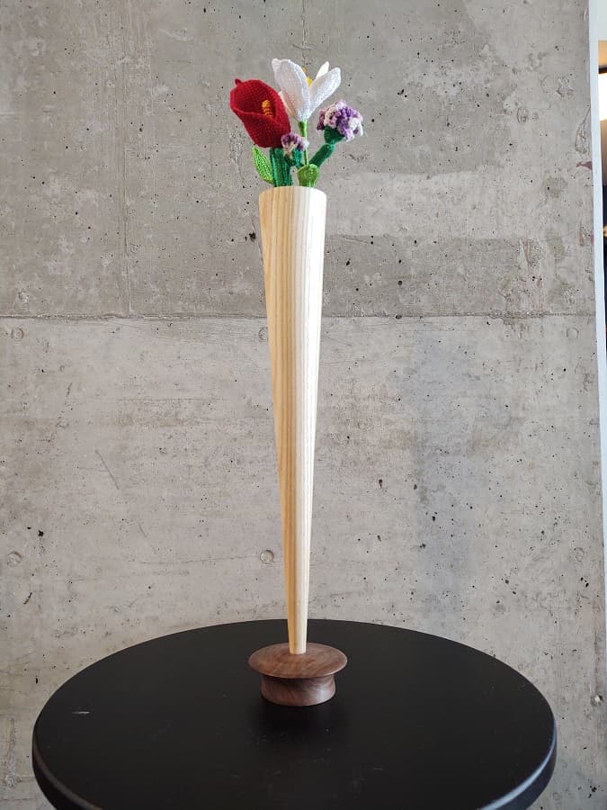

edit: I used that approach to stabilize this thing:
Admittedly, it’s absolutely not hollow all the way down, but it is 17.5" tall and ~2.5” at is widest. So it’s definitely a workable approach.

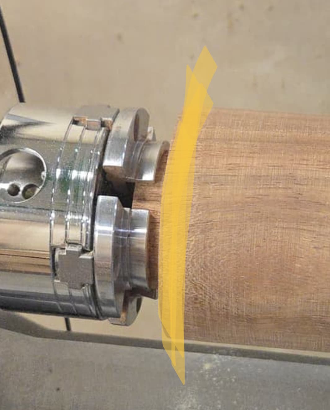

Thank you for sending the photos. When your piece is clamped in the Chuck, ideally it is touching that yellow line. I’m drawing on the photo. That is the shoulder of your piece. In other words, your tenon is too long. Shorten it just a little bit. So when your piece is in the Chuck, it is not only clamped around the tannin, and the shoulder is pressed up against the top of the Chuck clamps.
Something I like to do to set up is loosely clamp the piece in the Chuck, bring the tail stock up and firmly press it against the Chuck, then clamped out further.
Your tenon size looks great. Other than that. It isn’t too small.
omg it works perfectly! thanks so much. now this mug will definitely get finished before Christmas thanks to u
