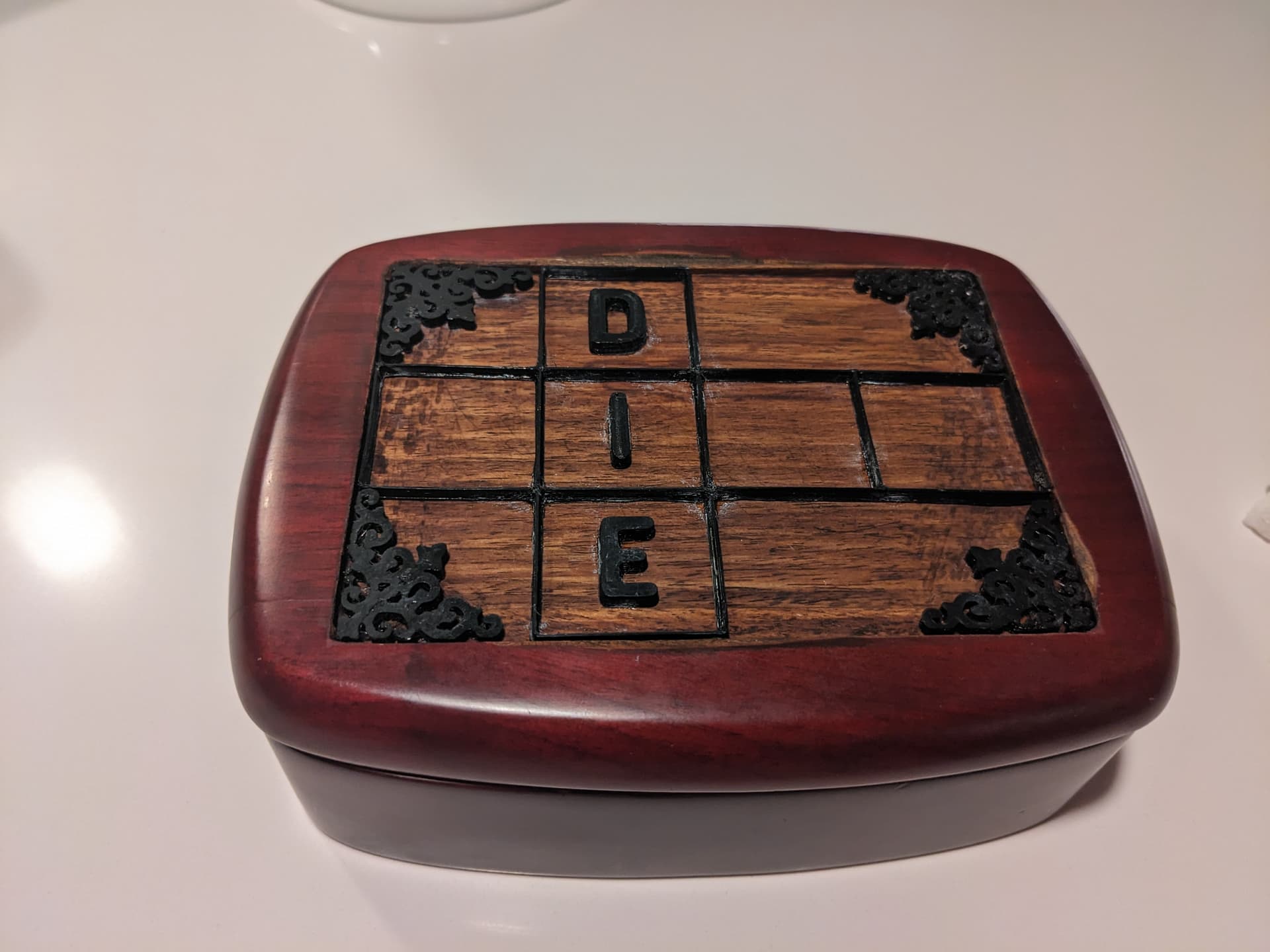

Now, you could pick applicable colors and go for it! You’ll get a nice result with sub-millimeter precision to hold all the components -but it will still be plastic. So here’s where a combo project could shine!
  1. Print the box inserts in a reasonable contrast color for the components.
  2. Create and nicely finish a wood box exterior around the printed insert. Using 1/4" veneered plywood can go far and be inexpensive. You can glue it right to the insert too.
  3. Optionally, add felt lining. Optionally, laser engrave the wood lid. Optionally, sublimation print on the wood instead. Or vinyl silhouettes. Or CNC engraved tops. Or leather! … Or any skill you want to use on it!
Here is an example I made a while back, using a goodwill jewelry box. This was for a tabletop RPG that had no previous models, so sizing my print to the box was easier than sizing my box to the print. I don’t really recommend custom felt lining every compartment, it was a real time sink. But that’s what I chose to do!

I’ll take a look at the printables links and see what kind of ideas they spur up. And that dice box looks amazing!
