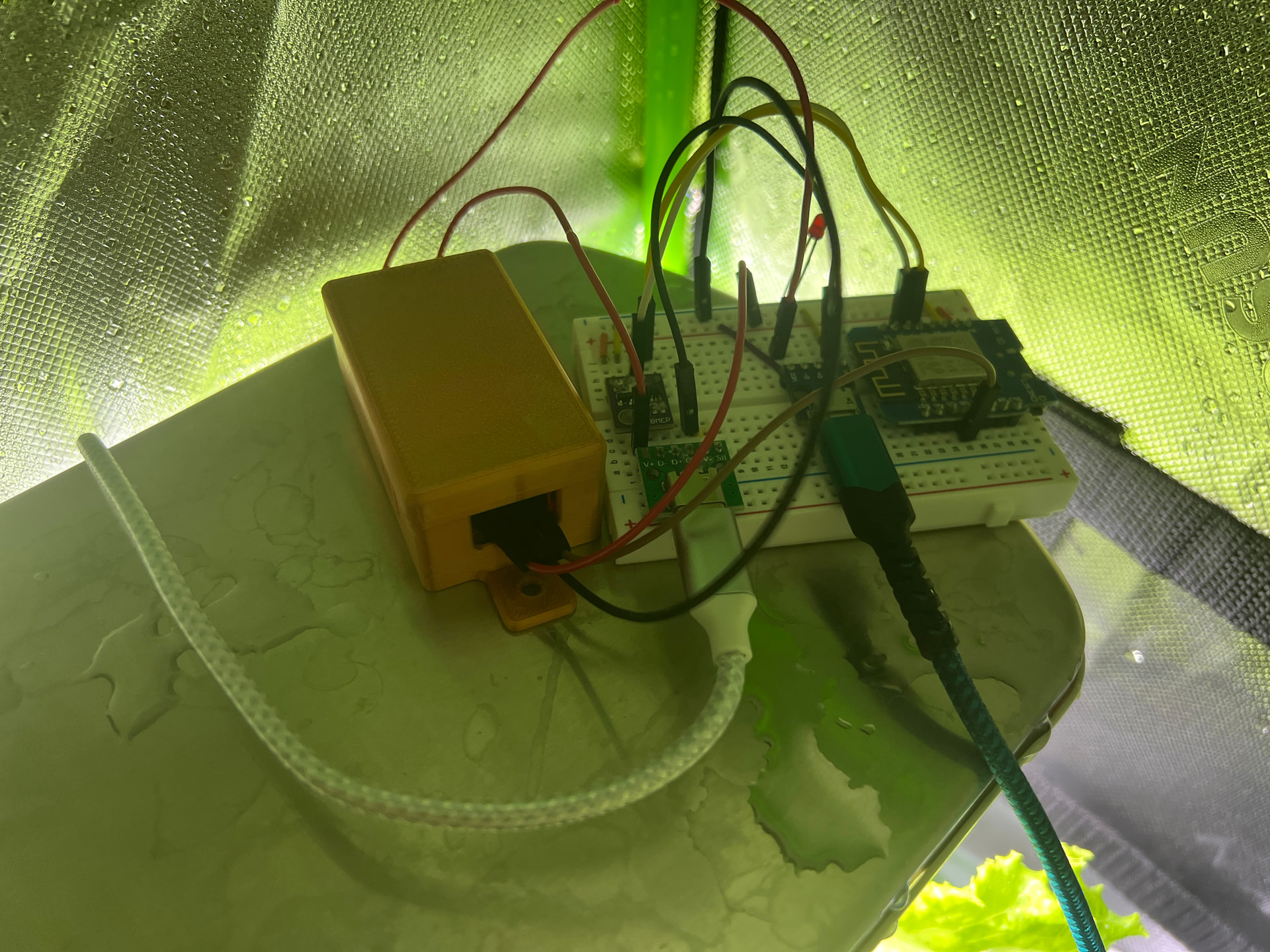

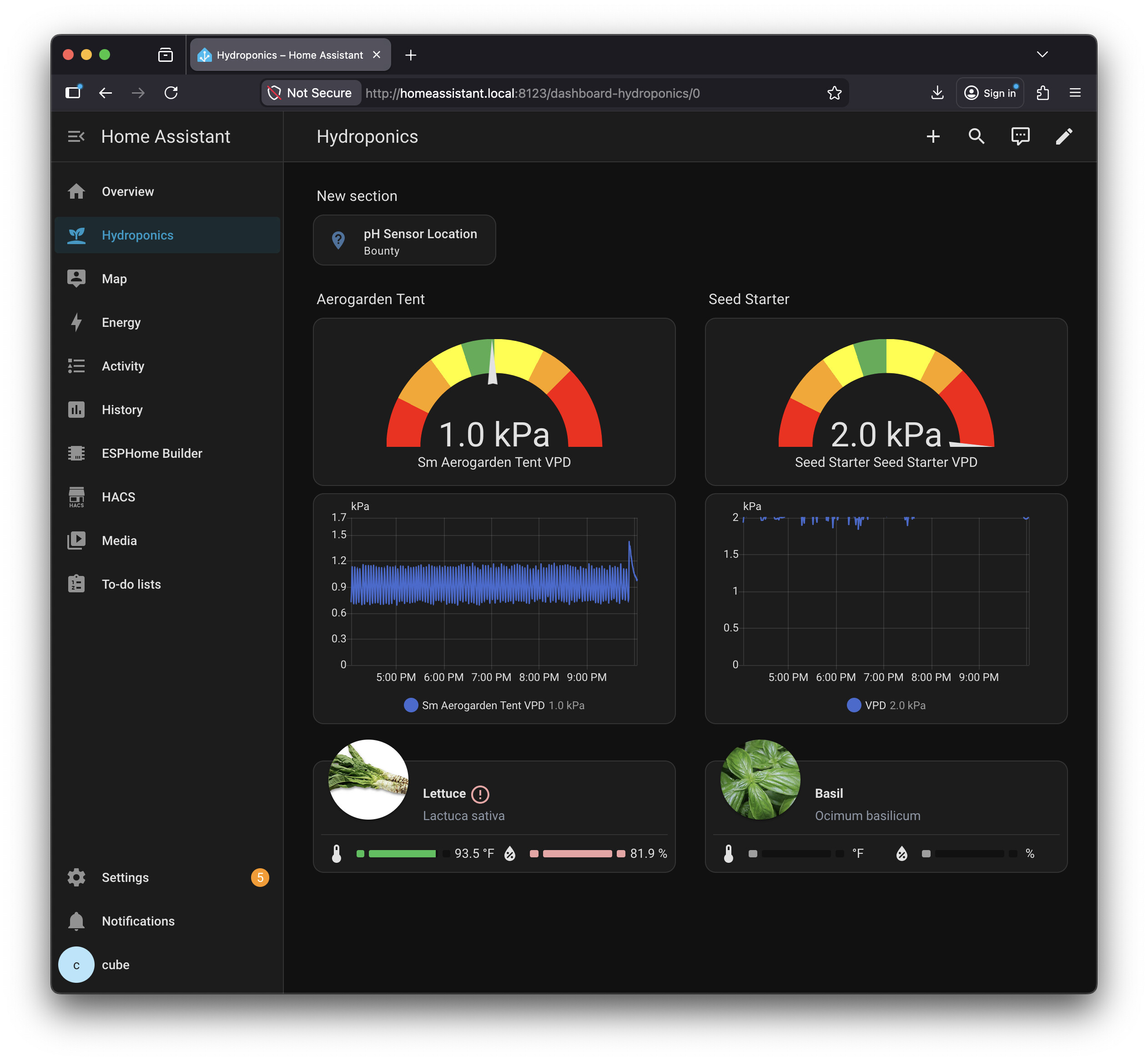

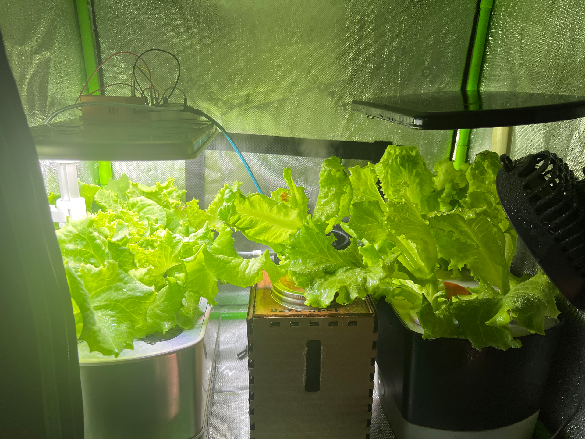

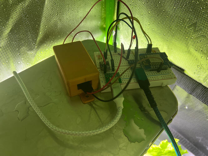

It’s unfortunate that last month I made the mistake of not updating the secrets file to be configured for the Asmbly wifi instead of my home wifi. I was hoping to show how to use a humidity sensor and voltage relay to control a humidifier. Below I’ve attached photos of the current state of my ESP8266 powered grow tent humidity controller, the Home Assistant integration, and the ESPHome YAML used.

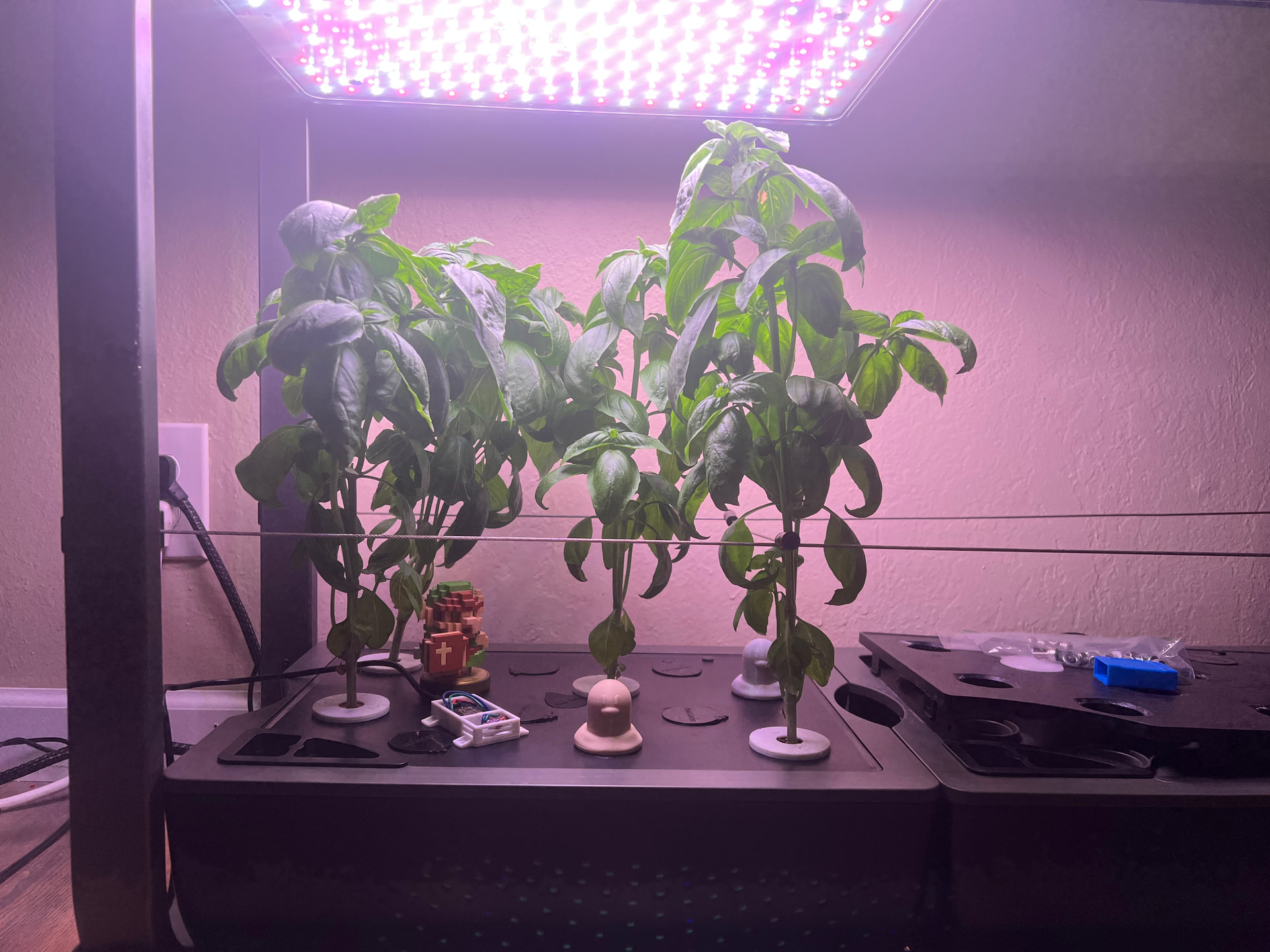

The basil VPD is high because it’s no longer in a grow tent, you can see the ESP8266 here infront of Link. Amiibos make good Aerogarden hole covers, 3D printed diglets are also good
