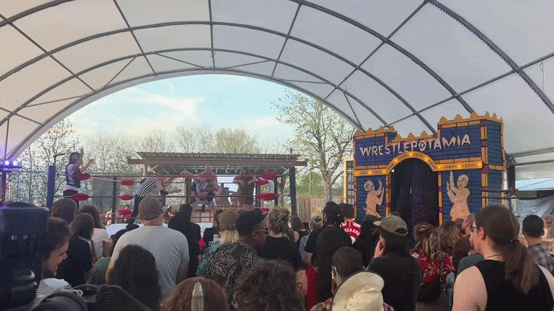

IMG_2311
If you make it you can see an ESP8266 used on our entrance arch to achieve the light chase animation
Did I invert the circuit? Yes. It should be five lights on one off, but the effect still works.
Did anybody other than you know the circuit was inverted?
A handful of Fight Opera staff and people within talking distance as I did the final wiring, so not really
