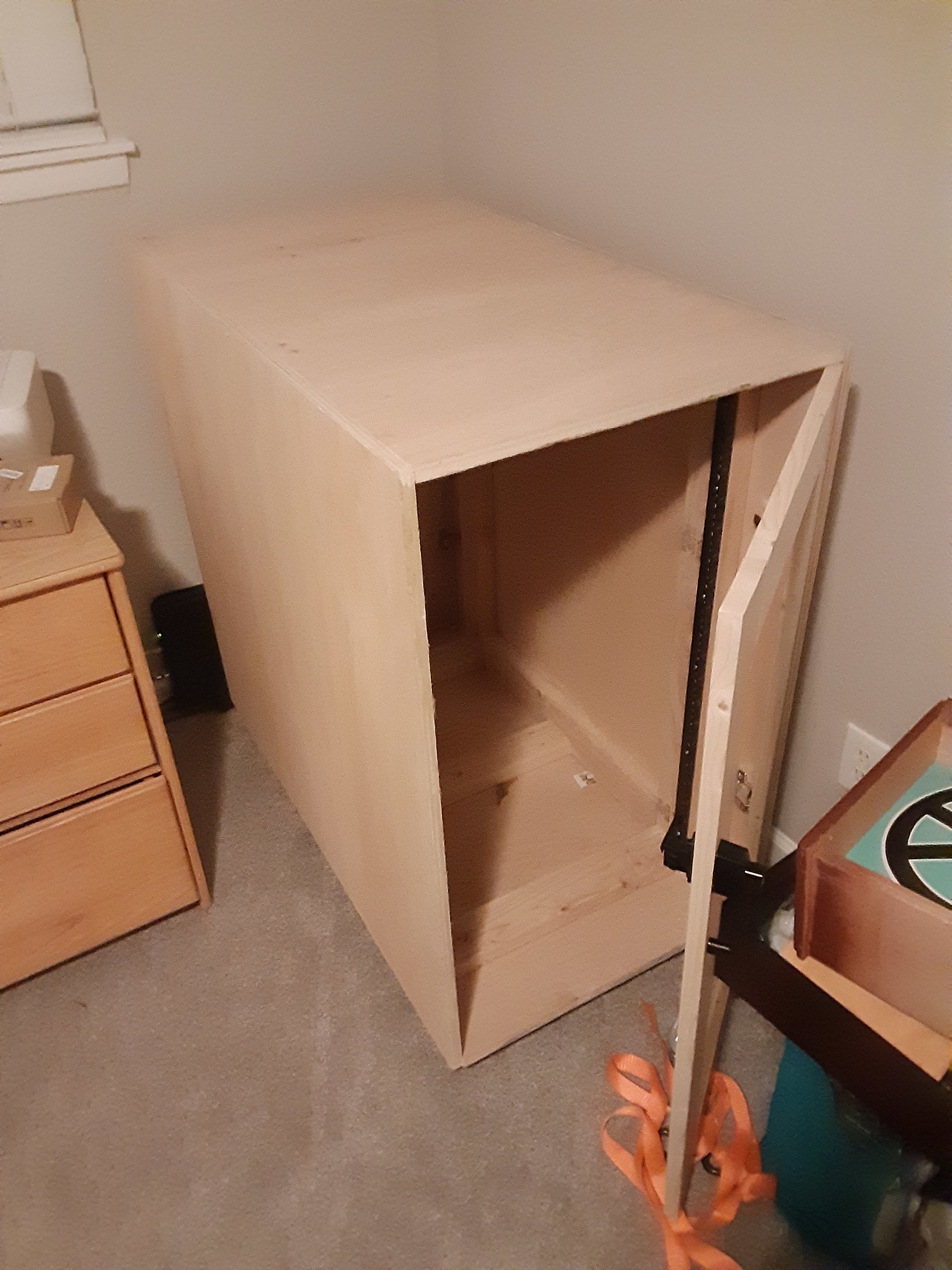

Thank you everybody for your help and offers to help with this project it is very much appreciated and helped this project go very smoothly.
Still need to add some clear panels for the doors but it’s done enough to start installing equipment.
More than enough room for my 1 dozen pi’s lol
@Tookys I was looking at the picture above and your other post about the Pi’s and started thinking that is a huge rack for those small servers.
Yes it is a comically huge rack. May add more to it in the future.
Thinking to add another computer in there while I’m at it, along with a router and a UPS
