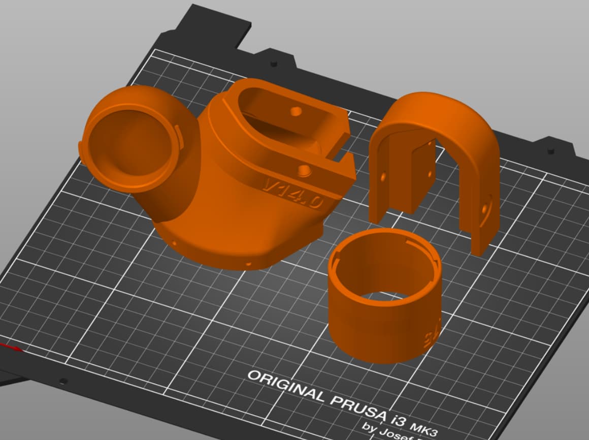

I don’t know anything about 3D Printing. So of course I purchased the 3D models for the improved dust collection from Shop Nation for my miter saw.
I’m looking for some help with printing them, but to be honest I don’t even know what kind of help I’m asking for. Not sure if the files need to be manipulated, or if they can be printed as is…
Help me Obi-Wan Kenobi.
Hi! I’m sure there are much more experienced people who will comment and offer to help but I’ve gotten into the 3d printing recently and I think we could figure this out!
They look like they may be designed to print without support which would make it a lot easier to make, but I’m not certain of that. Might want to tree support it.
Are you asking for help printing them? If you want to send me the files I can print them for you.
Do you have heat/material requirements? Do they need to survive a few light slams?
I question the print orientation of the horseshoe shaped part, though I can’t see the back side.

@dannym the guy says that he prints them on a Prusa MK3 without supports. But other printers may require some additional support.

I looked through the print settings and they don’t mean much to me, but perhaps someone familiar with the process can pick it apart easily:
All parts were printed at a 0.30mm layer height, with 20% infill, and a 0.6mm nozzle. These print just as well (even better) with a standard 0.4mm nozzle and a layer height of 0.20mm. You can of course experiment as you see fit – I’d maybe recommend printing with an extra wall perimeter or increasing the infill. I successfully printed all parts in both PLA and PETG – but PETG is recommended for this part.
Full documentation bellow

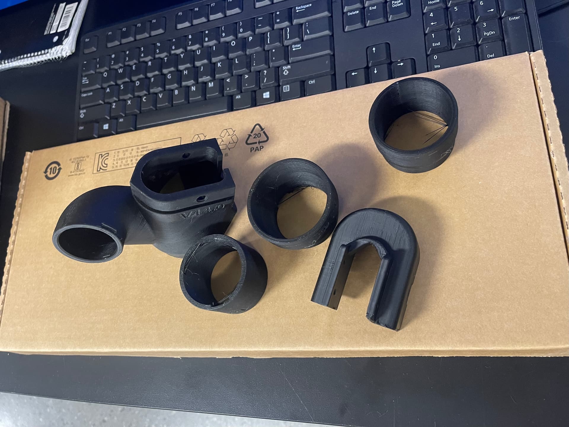

I printed a set. @CLeininger I’m jealous.
You’re a true gentleman @JoeN

I took a family trip for a week and then got the flu for a week. I’m just now getting around to finishing this whole thing.
I think I’ll buy some TPU and give that a try. And @JoeN was a true gentleman for helping me print a set of these. I’ll need to come by whenever is convenient to you.
