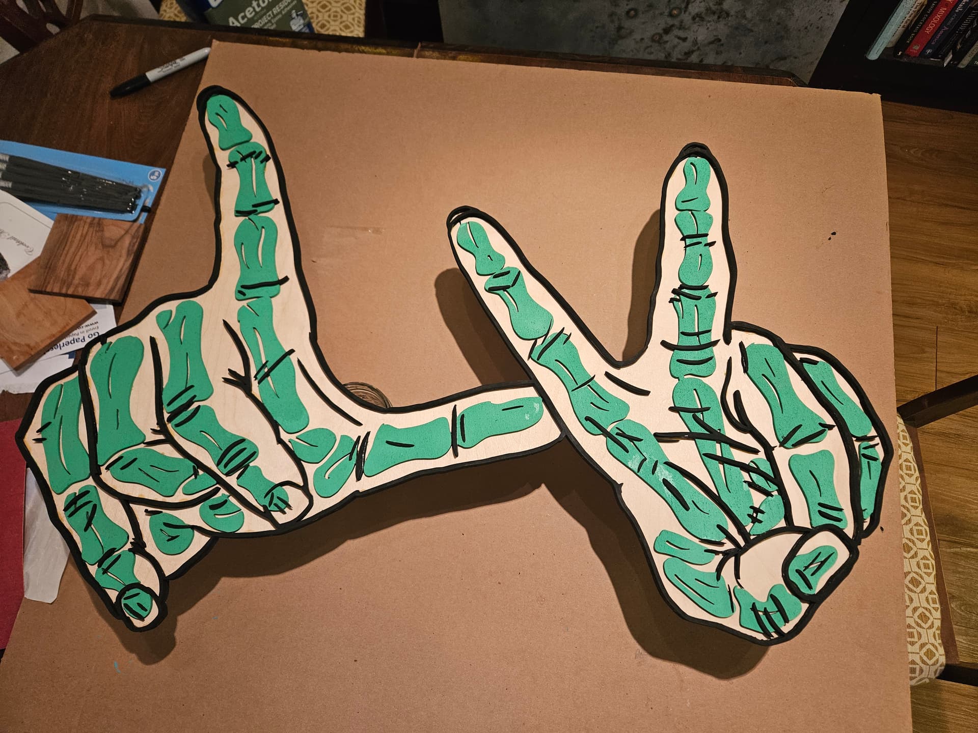

For my first laser project, I decided to recreate the Los Verdes logo for them to hang in their merch tent.
I made it out of 3 layers of 1/8" ply since I had a lot (and it’s cheap since I’m donating it). But I’m struggling to figure out how to hang it, since the only full layer is the backing and most hardware is thicker than that 1/8". It’s only like 1.5lbs, so I’m not too worried about strength.
I can cut an additional backing layer to give a screw more purchase if necessary, but I’m curious if there’s a better option.
I would probably use wood glue to attach some additional pieces that are thick enough to screw some hanging hardware onto.

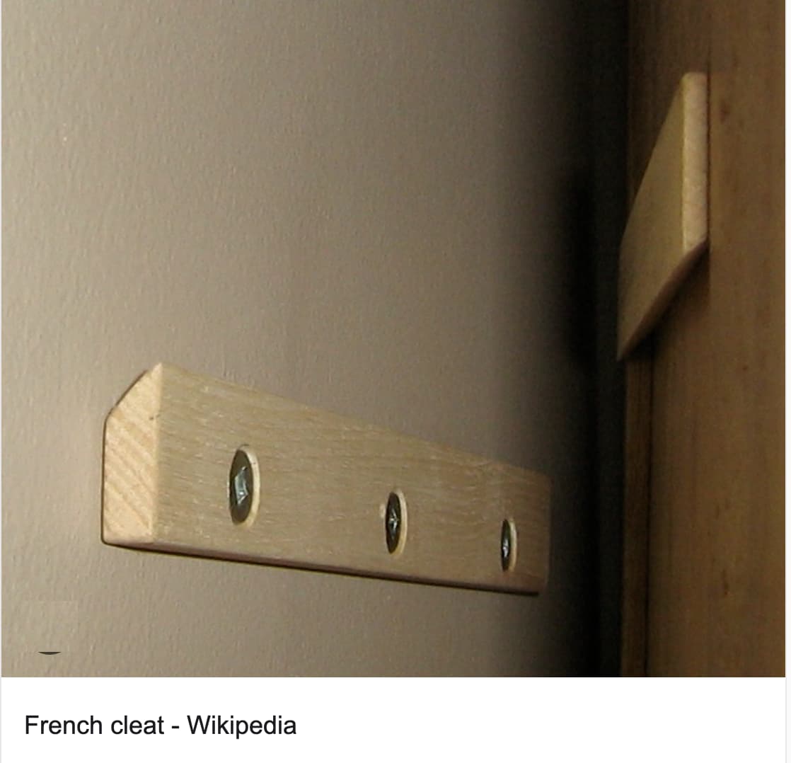

How about glueing a french cleat on the back of each hand about 1/3 from the top. And then screwing the other cleat on the wall. If necessary glue another cleat-thickness piece at the bottom to make it lay flat against the wall.
Yeah, a French cleat would be my preferred method if it had a permanent home, but this will probably be moved around a bunch, so I’ll need some flexibility. I think adding material to the back is the most viable.

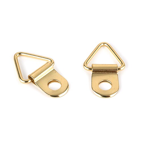

Picture hanging d rings will give a lot of flexibility for hanging it in a tent because they can suspend it from anywhere, and they don’t need very long screws so if you place them right (like at the finger tips where you have 2 layers) you probably won’t need to add additional layers.

Thanks y’all! I ended up adding a 1/4" strip to the back and used some D-ring picture hangers with 3/8" screws. In addition to providing some extra purchase, it also eliminated a bit of flex, so win/win!
