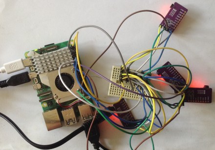

I have one location in the house (before I bought it) that has 3 sets of house speaker inputs. So instead of using three Pis. I will use one and three dacs ala this RPi 5 Quad Stereo Sound with PCM5102A – Simple DIY Electronic Music Projects
