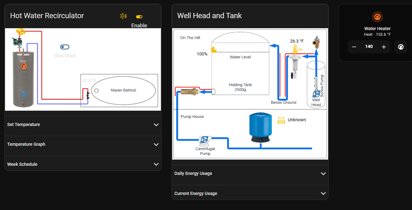

Example: hot water recirculator
My hot water recirculator will happily pump in a loop all day long if left alone. That behavior is built into the device itself.
Home Assistant doesn’t run the pump, it optimizes it:
  • disable when no one is home
  • disable during low-use hours (10am–5pm)
  • enable only when it makes sense
If HA goes down, the pump reverts to its basic behavior and continues working. Efficiency is lost but functionality is not.

Example: “Home Stance” and freeze protection
I maintain a set of Home Stances in Home Assistant. One of them is Freeze Warning.
The Freeze Warning binary turns on when:
  • a forecast predicts freezing temperatures within the next 8 hours
  • or any temperature sensor on the property reports near-freezing conditions
This acts as a central “bat signal.”
ESPHome devices capable of heating:
  • monitor the Freeze Warning binary
  • preemptively turn on heating when it’s active
  • do this regardless of whether they have their own temperature sensor
If HA is up, devices coordinate intelligently.
If HA is down, devices fall back to their own local logic.
The result is centralized awareness with decentralized action.

My temperature sensor in the pump house failed, however the heater still turned on because the Home Stance told it to.
