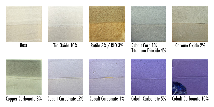

I figured I would get us started by sharing some results from a project I started working on a couple of weeks ago. I started experimenting with creating my own glaze! We don’t have any matte options in our current lineup and I thought that would be a fun place to start.
I mixed up 1KG of dry ingredients for my base glaze and then split that up into 10 separate test containers, I added a variety of colorants to each test container, and added water, mixed them all up, and adjusted the water until I reached my desired specific gravity.
I let those test batches hydrate for a day or two and came back and dipped my test tiles-- one dip for the bottom and two dips for the top (long dips for this test-- about 3 seconds each). Results below:
Wow-- I never expected to get purple! I was expecting the cobalt carbonate to go from a powdery blue to an almost black at 10% (if I’m being honest, 10% was a mistake on my part-- never meant to go that heavy).
Most of these tiles are chalky to the touch-- not my intended result. A few of them do have a smooth matte finish to them. I am not sure if the colorants could be the root cause of this difference in finish or if it could be something else like not mixing some samples well enough or perhaps a different specific gravity is required. I’m thinking I need to add more frit to my base recipe to help it melt. Further investigation and testing is required. :slight_smile:

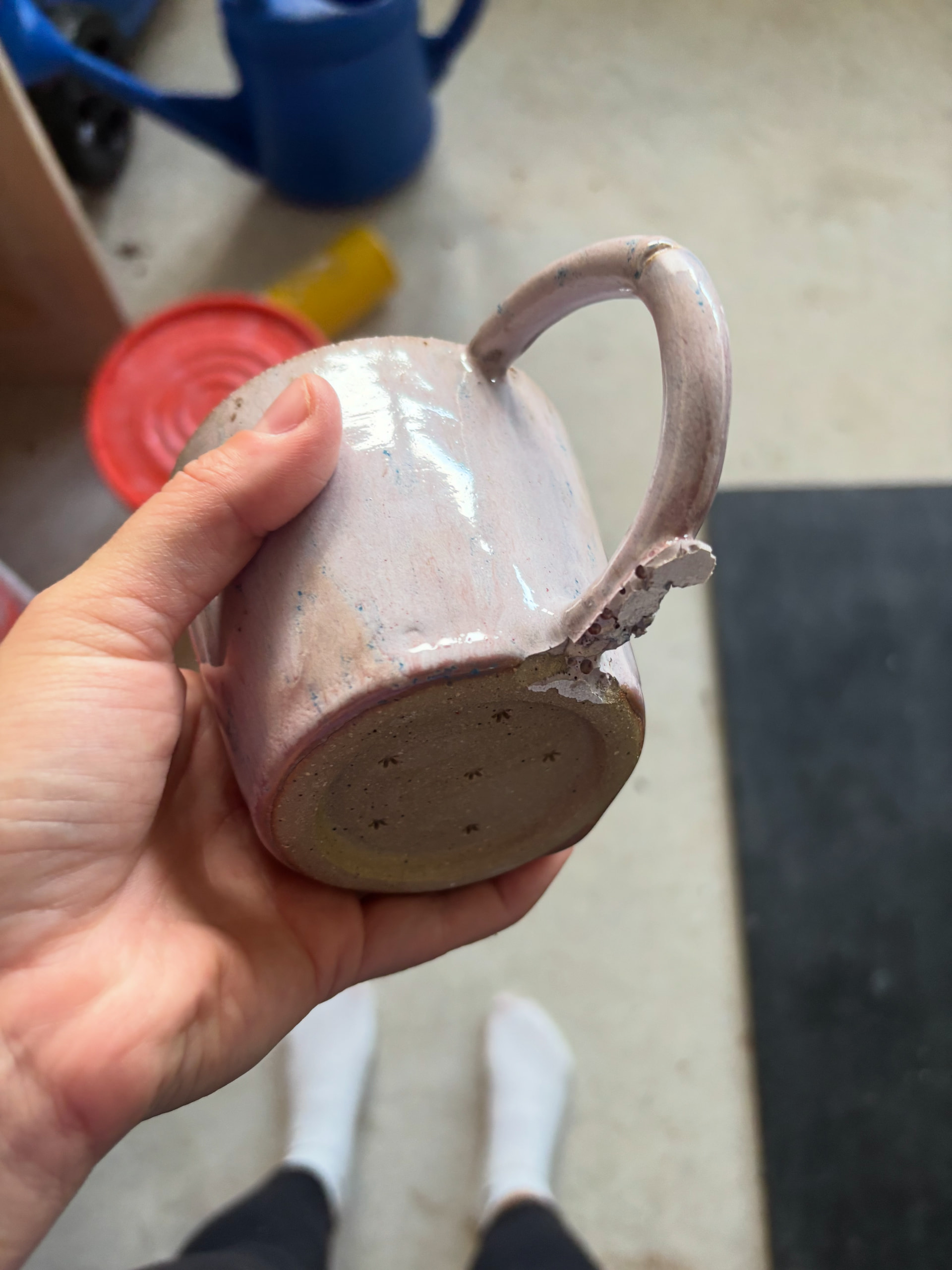

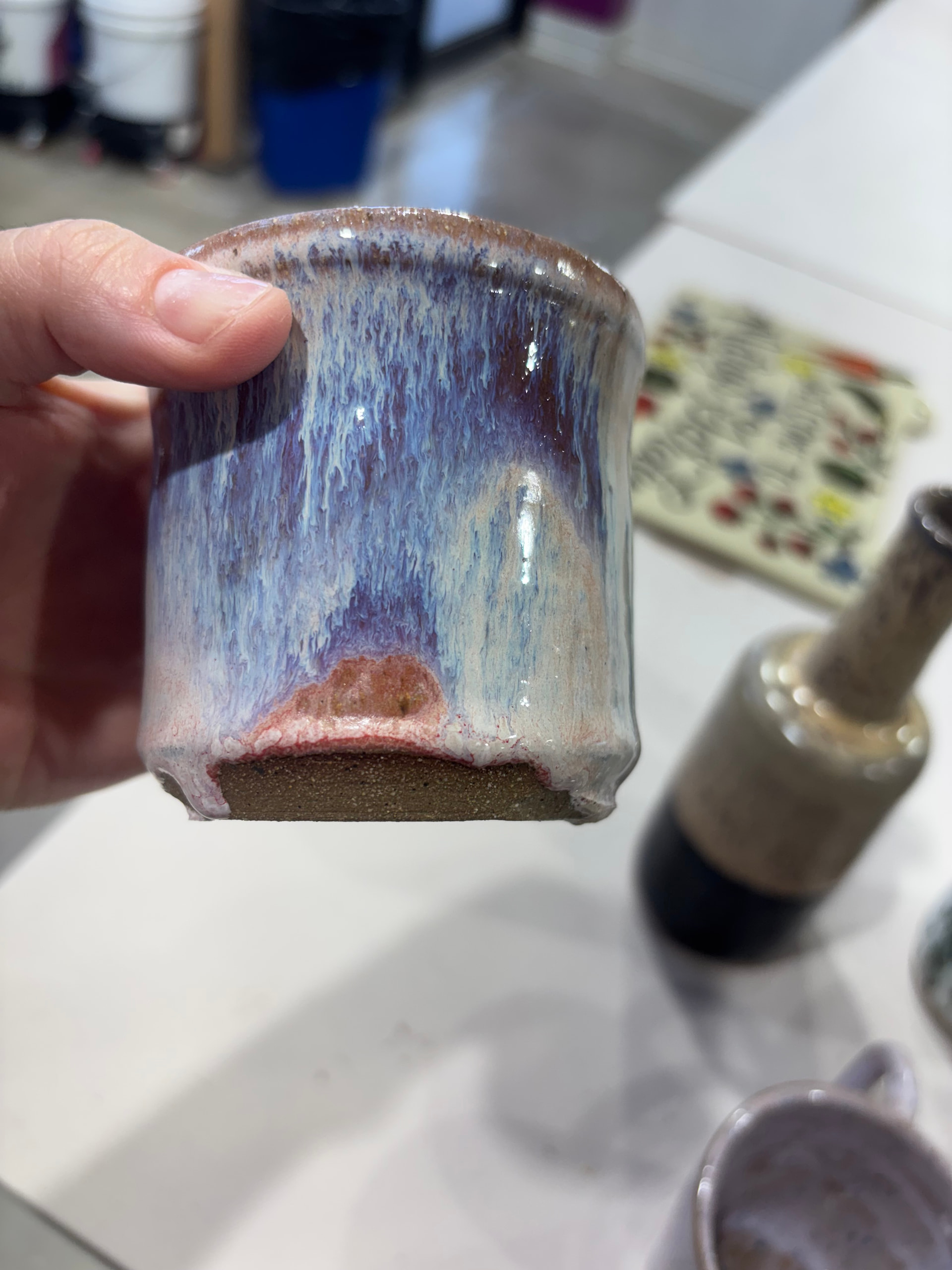

I had a TON of runny glazes this week, so much so that nasty shards were left at the bottom, I have never had this so far at asbmly which bummed me out and also makes me have to apologize - SOOOOOO sorry kiln operators!!! All of the glazes that this happened to were from commercial bottle glazes which i found interesting - rose quartz (2 coats with dipping clear over), purple aster (3 coats which I just hate the color of and cannot for the life of me find any good combos i like using it) & canary yellow (in donation pile that I thought I would try out). I was especially surprised that rose quartz and canary yellow ran so much since i left over a half inch of space as I really like the natural speckled look of this reclaim clay I had been working with and wanted the colorful contrast to come through. oh well!

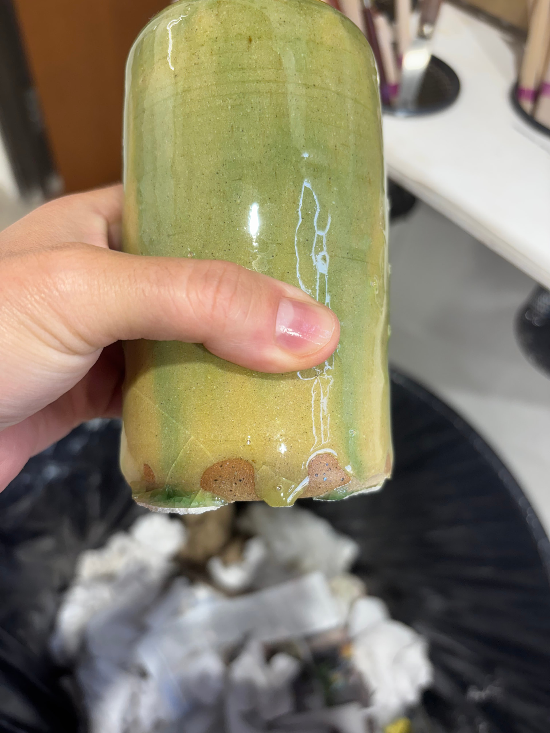

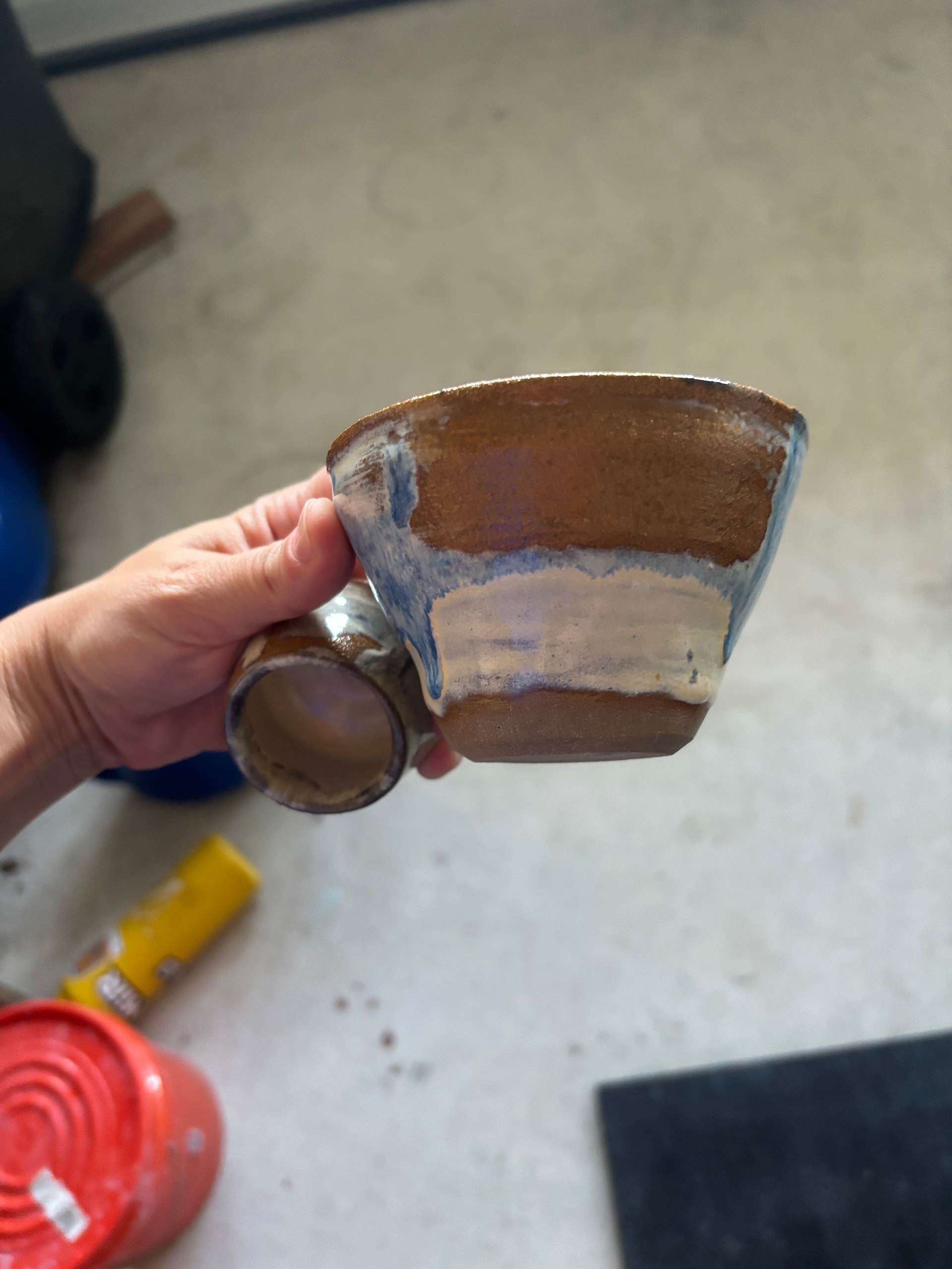

Secondly - has anyone been having trouble with the gloss white? For some reason each time I try it it is so splotchy and refuses to stick fully to the pieces. I’ve tested multiple times and these are the examples from this unload - it’s so strange! And yes before anyone asks - the clay is always dust free and dry after a wipe down!! Any thoughts & comments??

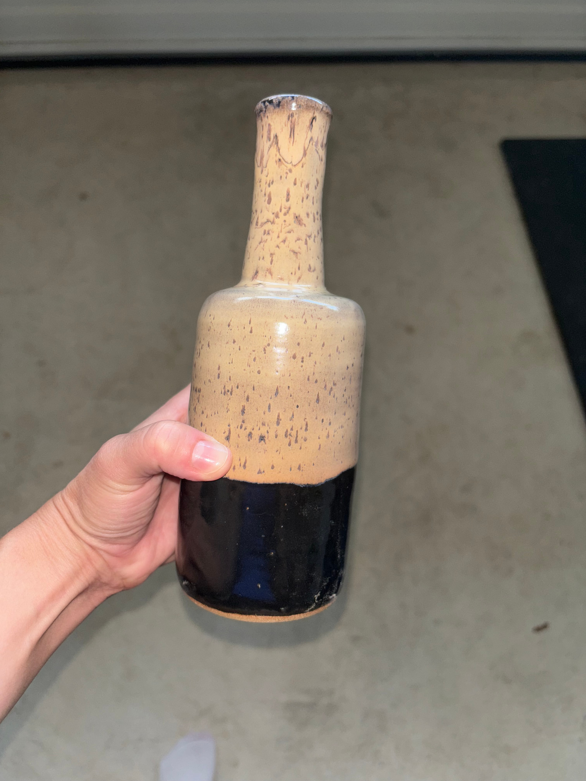

But on the plus side I am really loving Rutile over gloss black from the dipping glazes!!! It’s a beautiful combo and leaves almost a light lavender/ blue hue where the material breaks and colors come together and is beautifully spotted! (might be my piece that is crazing, something keeps dinging but i can’t narrow it down just yet!) And as per usual underglazes are POPPIN!!!

I’ve also had crazy issues with our gloss white and our floating pink :frowning: you’re not alone!

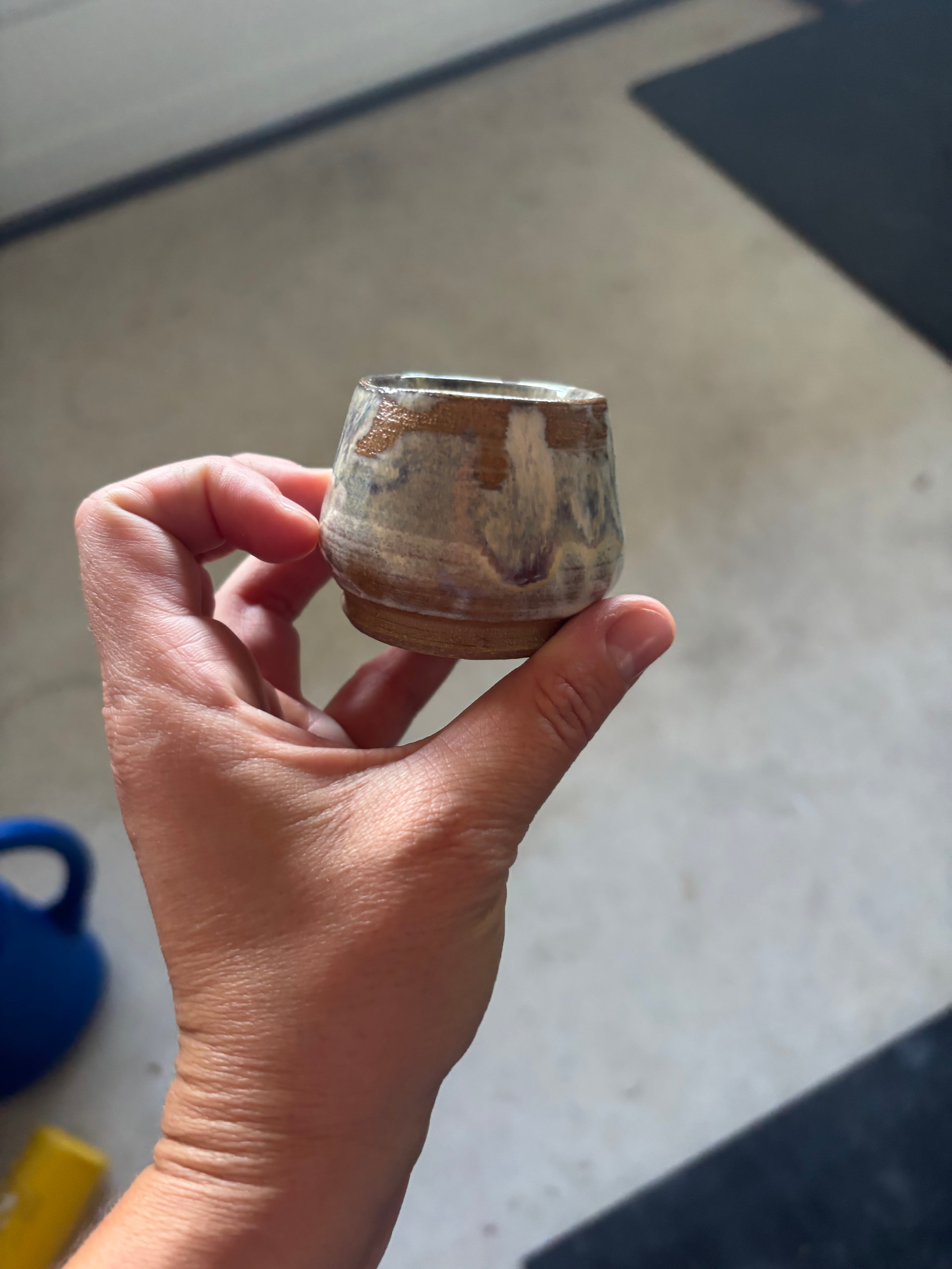

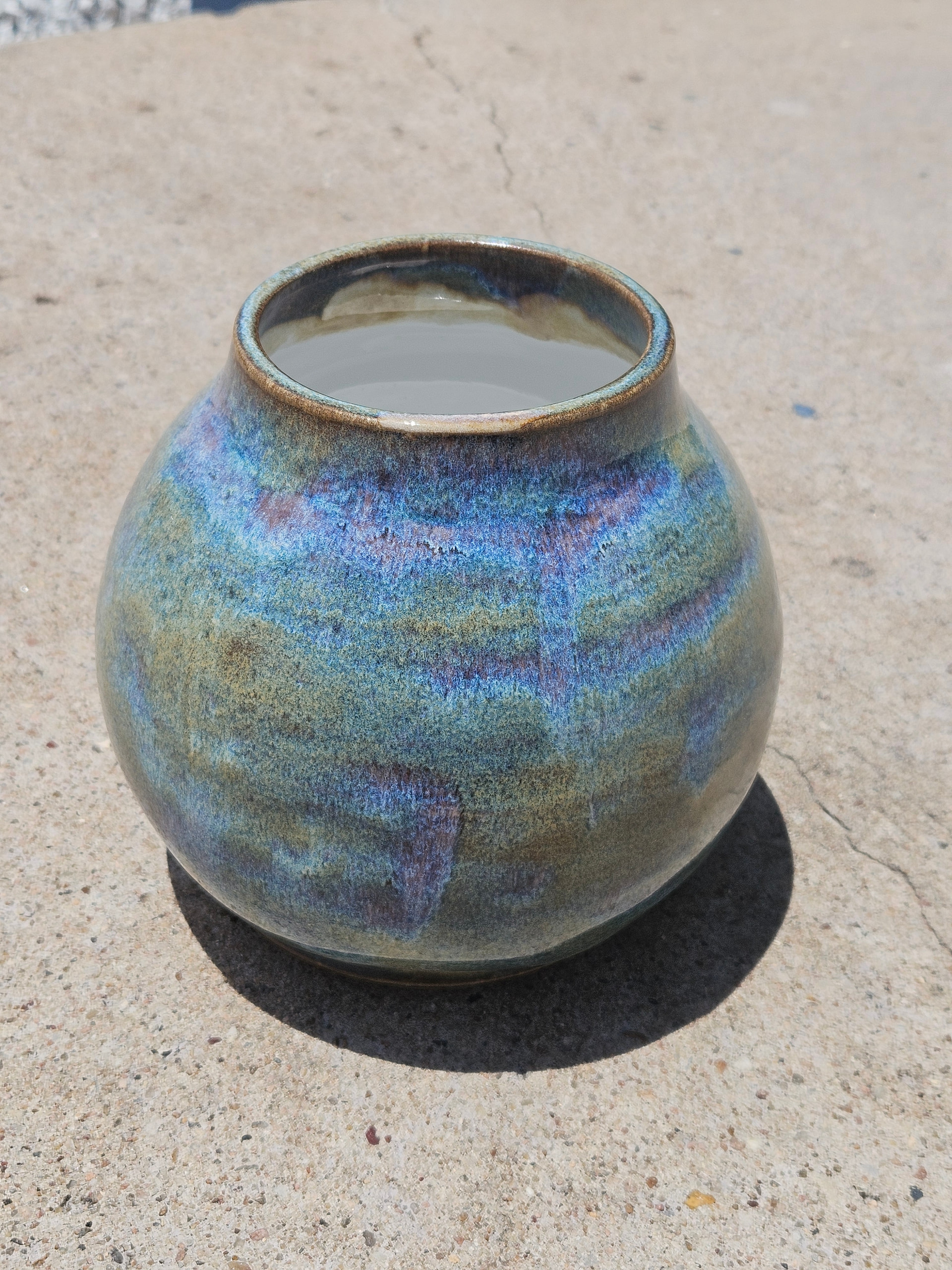

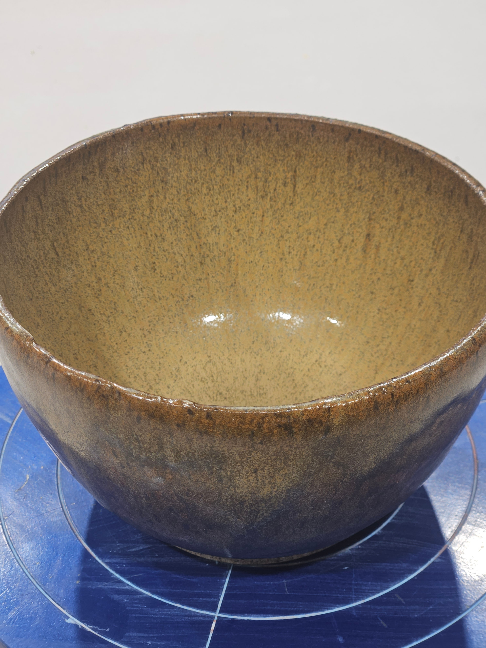

I recently had a very unexpected results using Iron Lustre. Not at all what I was expecting, but it definitely looks amazing so I’ll take it! Here’s 3x coats on top of Laguna speckled buff

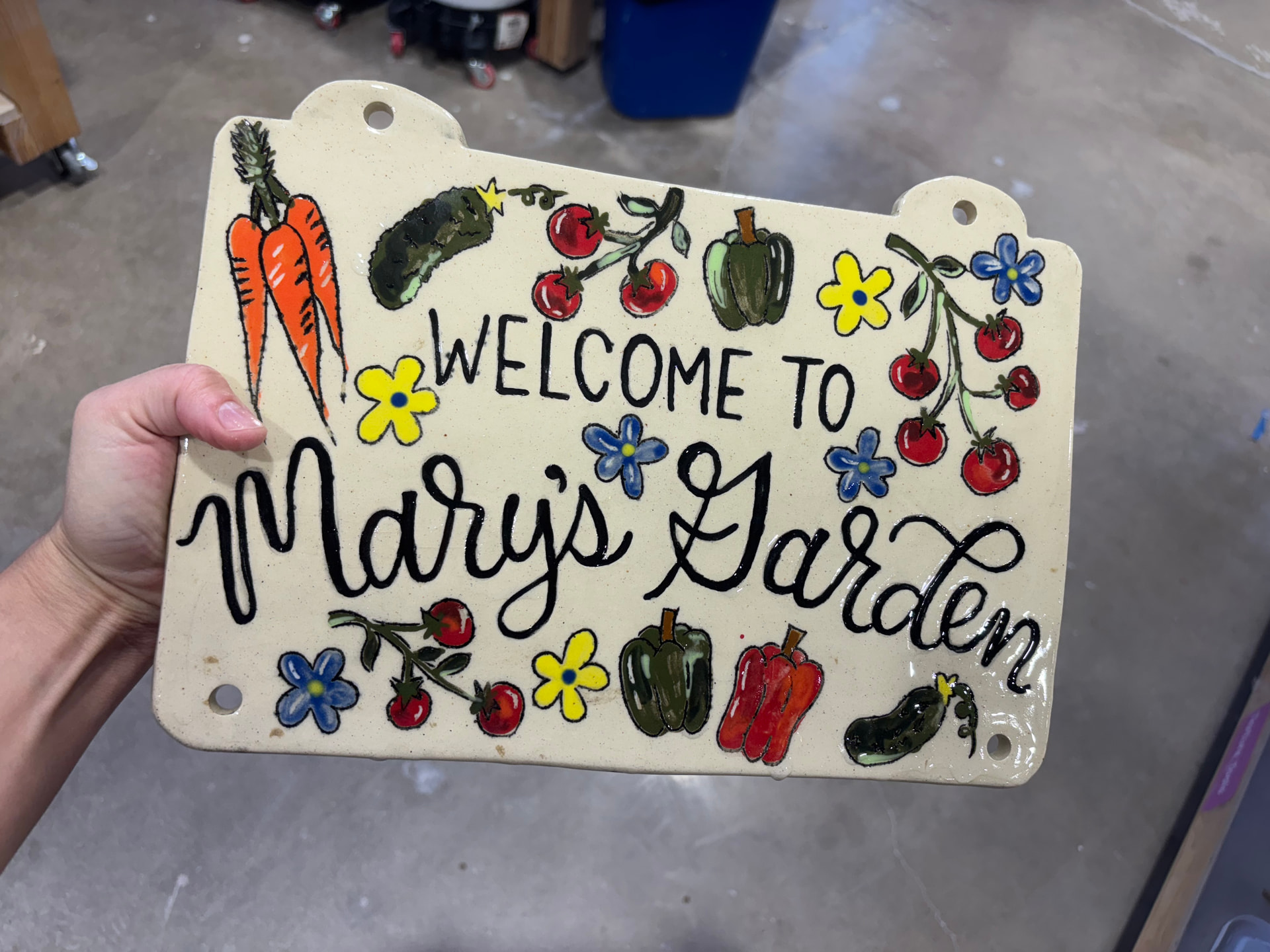

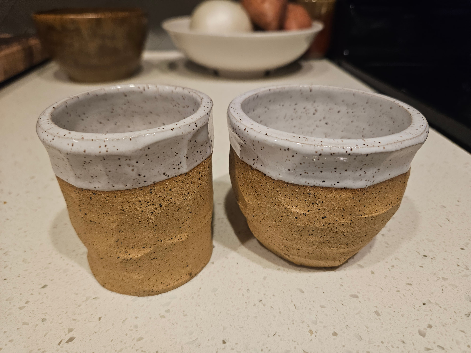

If you have the patience for brushing glazes, the celadon snow works very nicely as a super stable white option (also on speckled buff)

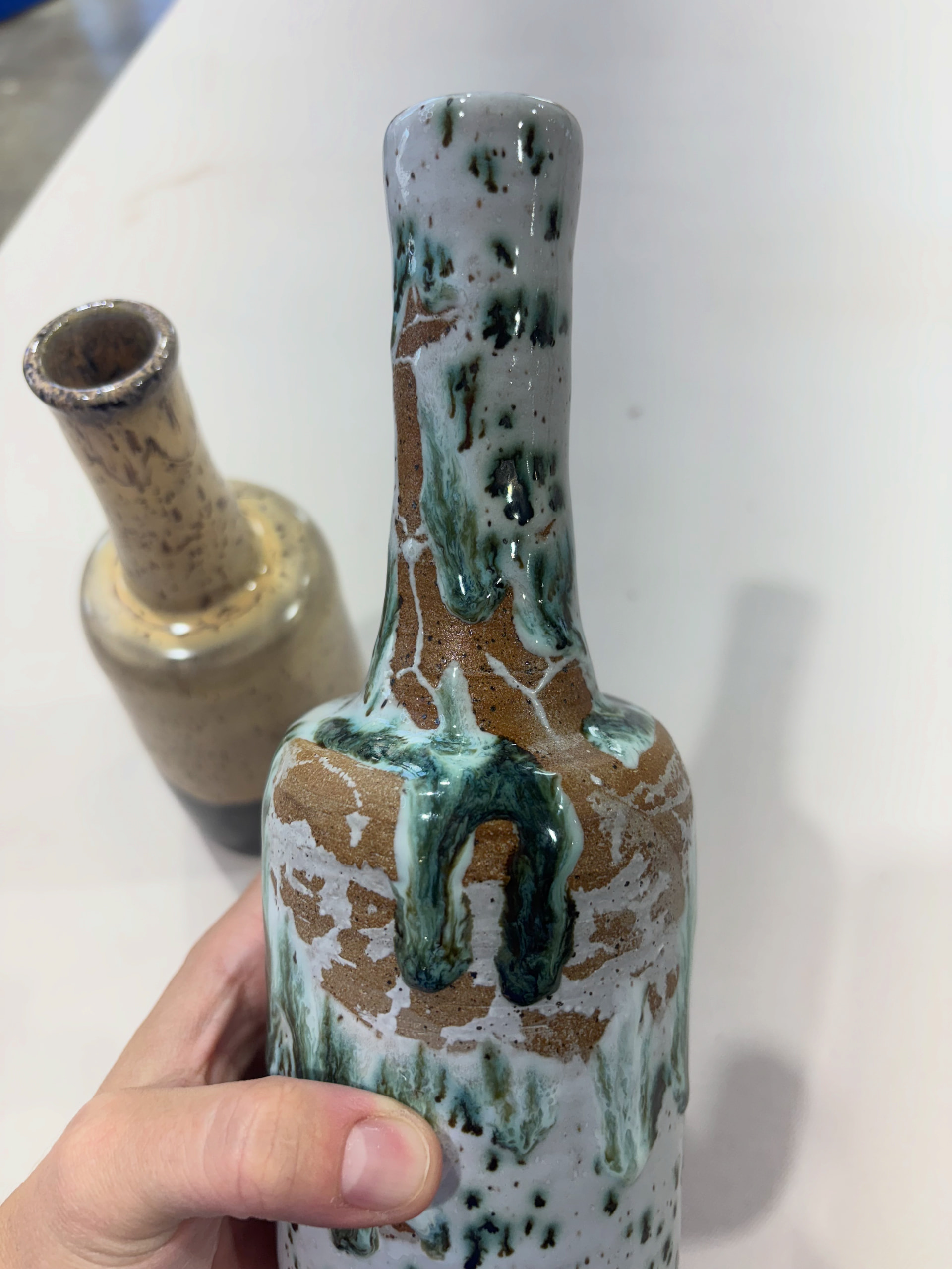

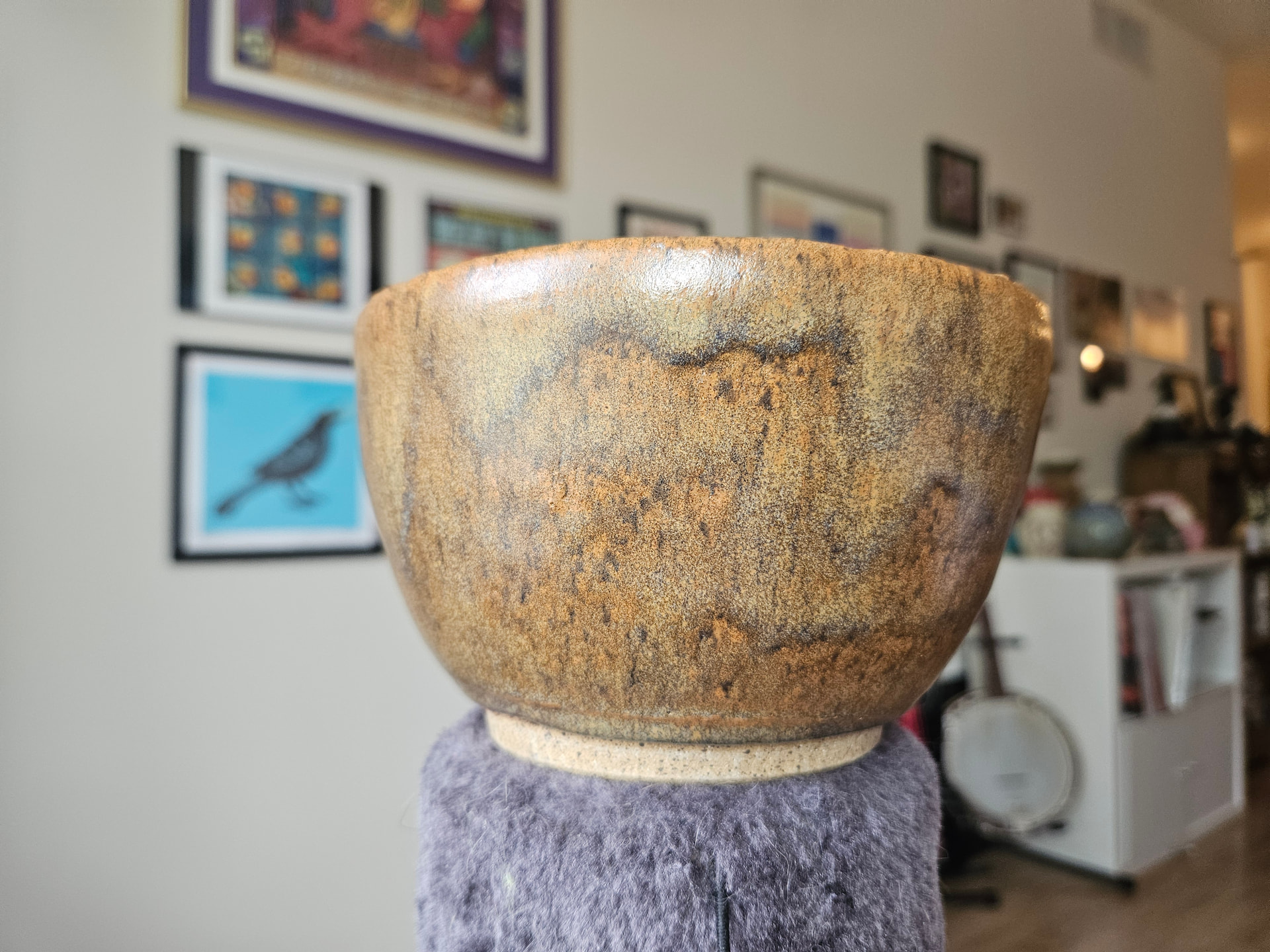

This is Oatmeal over Iron Lustre on Buffalo Wallow. I think I needed more Oatmeal to get the blue+purple reaction all over

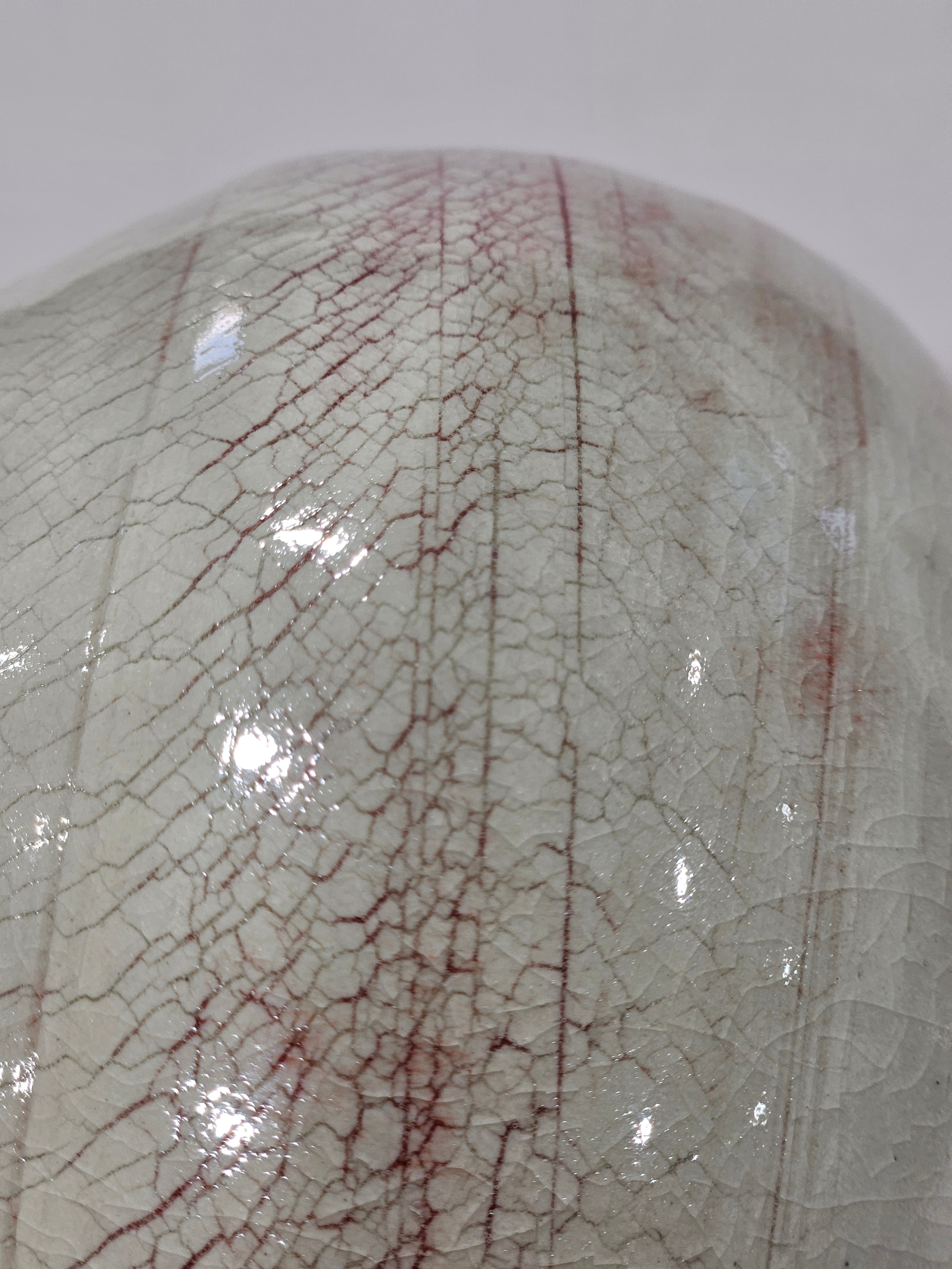

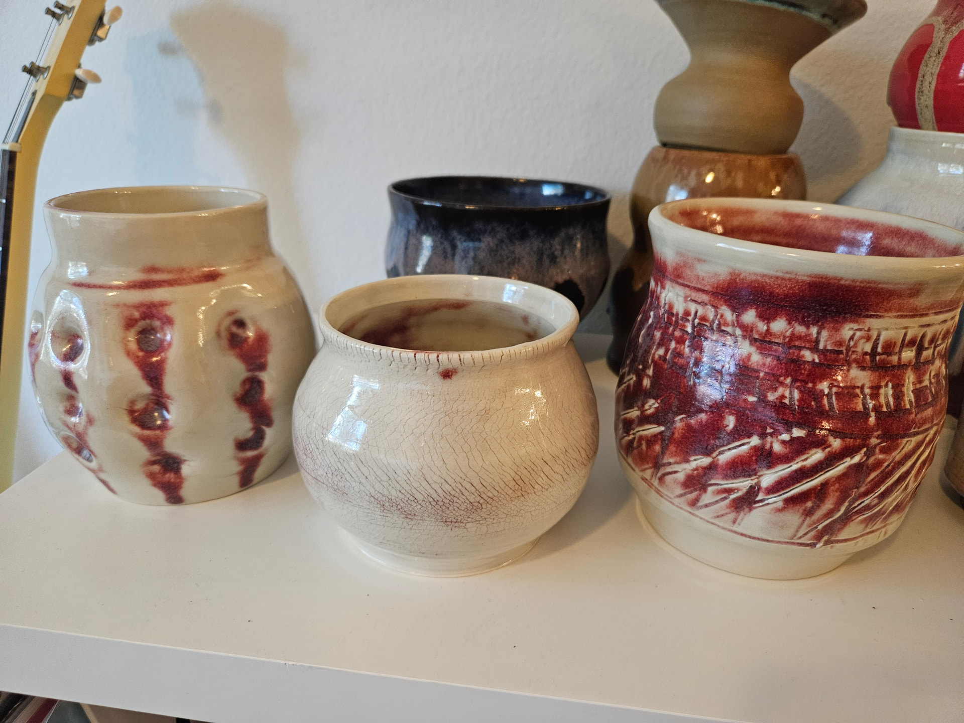

And finally here’s Oxblood (oxidation) on a porcelain clay I textured with sodium silicate. I was hoping it would come out really exaggerated like it’s sibling pieces, but is rather muted in comparison. I might have needed another coat, or just larger cracks in the surface. Will probably attempt this one again
I’m catching up a little bit here, but we are working on the white gloss and did make an adjustment a couple of weeks ago - it was definitely not playing well with the other glazes.
