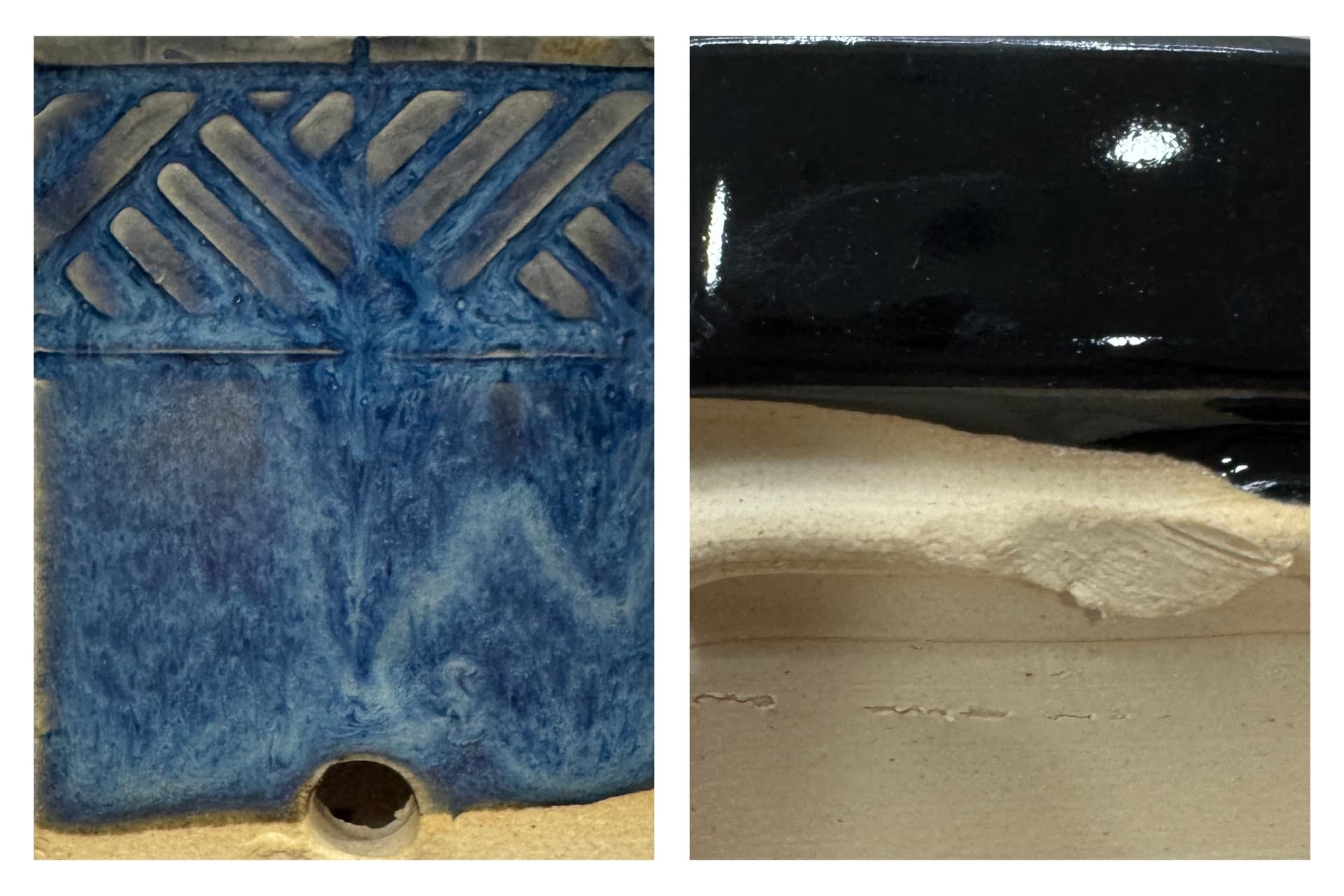

I wanted to share an update on what we’ve been working on in the glaze lab. Next week, we’ll be rolling out two new dipping glazes for member use:
Floating Blue
Floating Blue fires to a dynamic, layered blue with soft movement and natural variation, ranging from bright sky blue to deeper denim tones. The color breaks lighter over texture and edges while pooling richer in recesses, giving the surface a sense of depth and motion. Because the color comes from raw oxides, it actively interacts with other glazes—blending, bleeding, and shifting at overlaps—making it great for layering and surface experimentation.
Dipping recommendation: Apply two short dips for a full Floating Blue effect. Applications that are too thin may fire greenish rather than blue.
Floating Blue is meant as a replacement for the Mayco Stoned Denim we currently offer.
Glossy Black
Glossy Black is a smooth, opaque true black with consistent coverage and a clean, even finish. It fires reliably at cone 5–6 with minimal running, making it a dependable studio black. Because the color comes from a ceramic stain rather than raw oxides, it remains stable in firing and layers cleanly with other glazes without bleeding, breaking, or unexpected color shifts (similar to the celadons).
Dipping recommendation: Apply one to two short (~3 second) dips.
Test tiles fired in the Asmbly kilns:

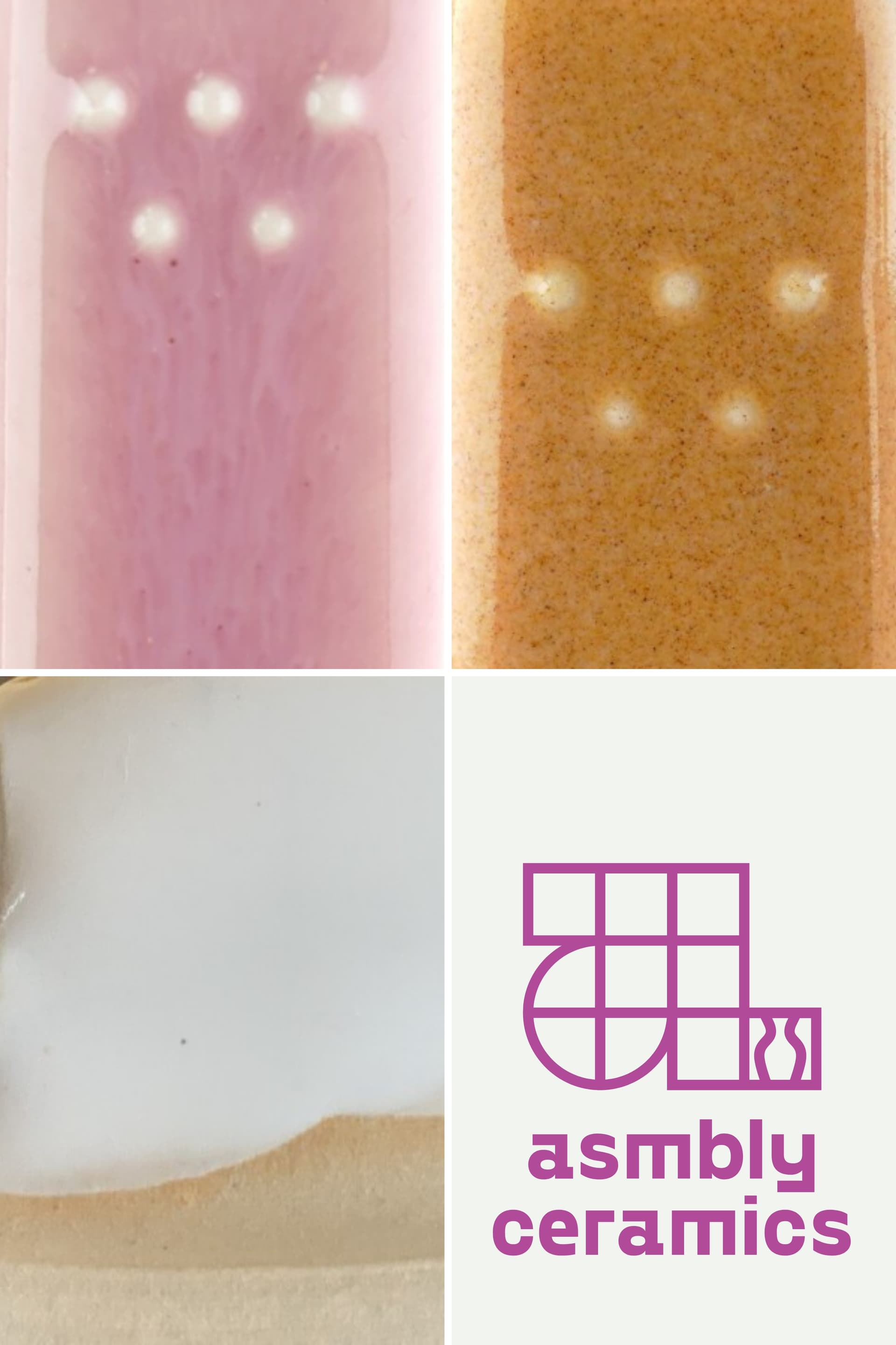

I’m also excited to share that @NickE mixed up the next three additions to our glaze lineup today. We’ll be testing and fine-tuning these over the next couple of weeks ahead of their rollout:
  • Floating Pink
  • Floating Rutile
  • Glossy White
Example intended results:
A note on Glossy White vs. Ivory
We currently offer Ivory as our studio glossy white, but we’ve heard feedback that a more opaque “liner white” may be preferred. Since we only have capacity for a limited number of glazes, we’re hesitant to permanently carry two whites. Our plan is to release Glossy White, allow time for use and testing, then solicit feedback to decide which glaze to keep long-term.
