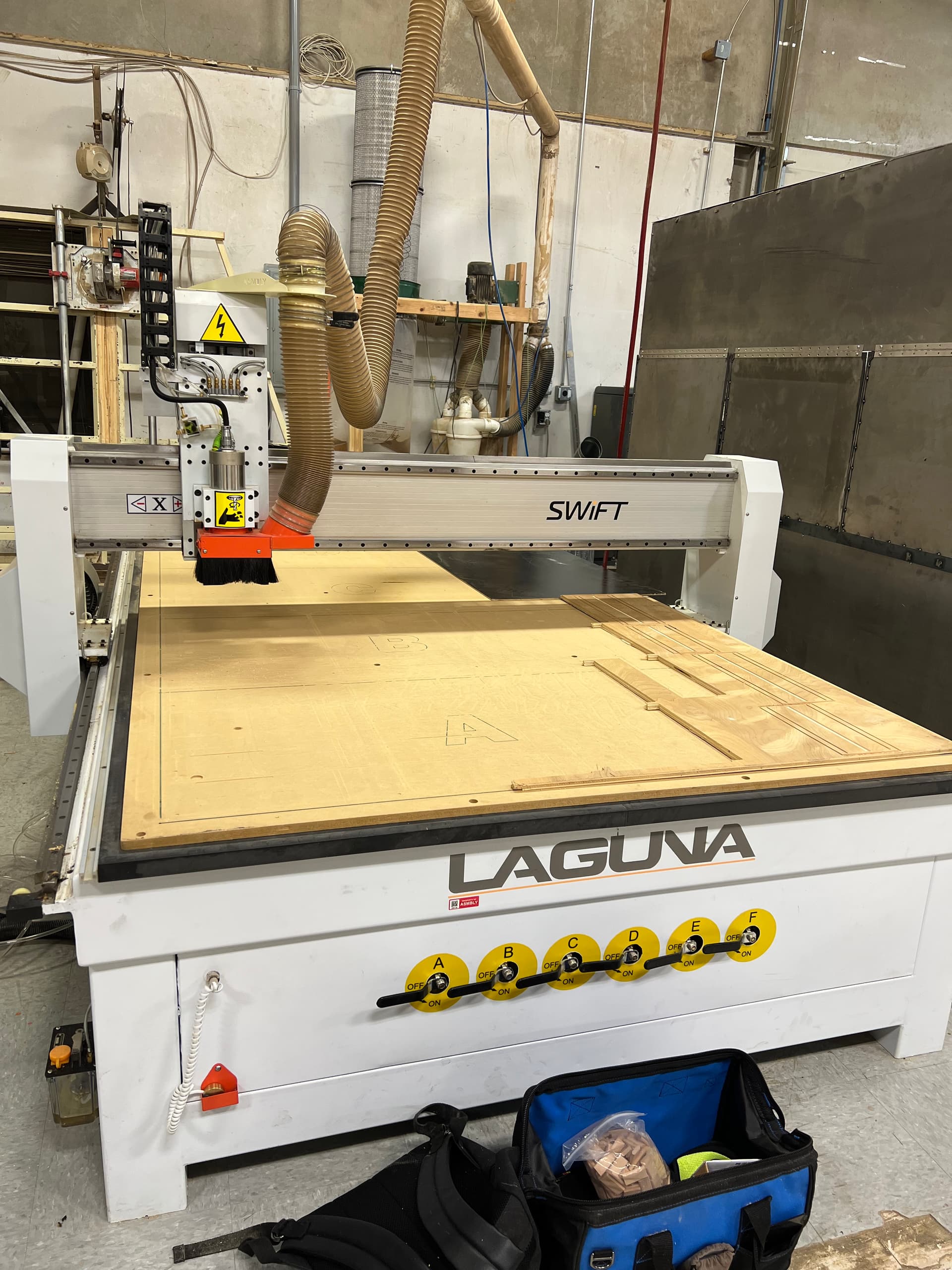

I’ll post again tomorrow or Tuesday with details on my first 4’x8’ project on the new Laguna Swift CNC. For now, here’s some details on my very first project:

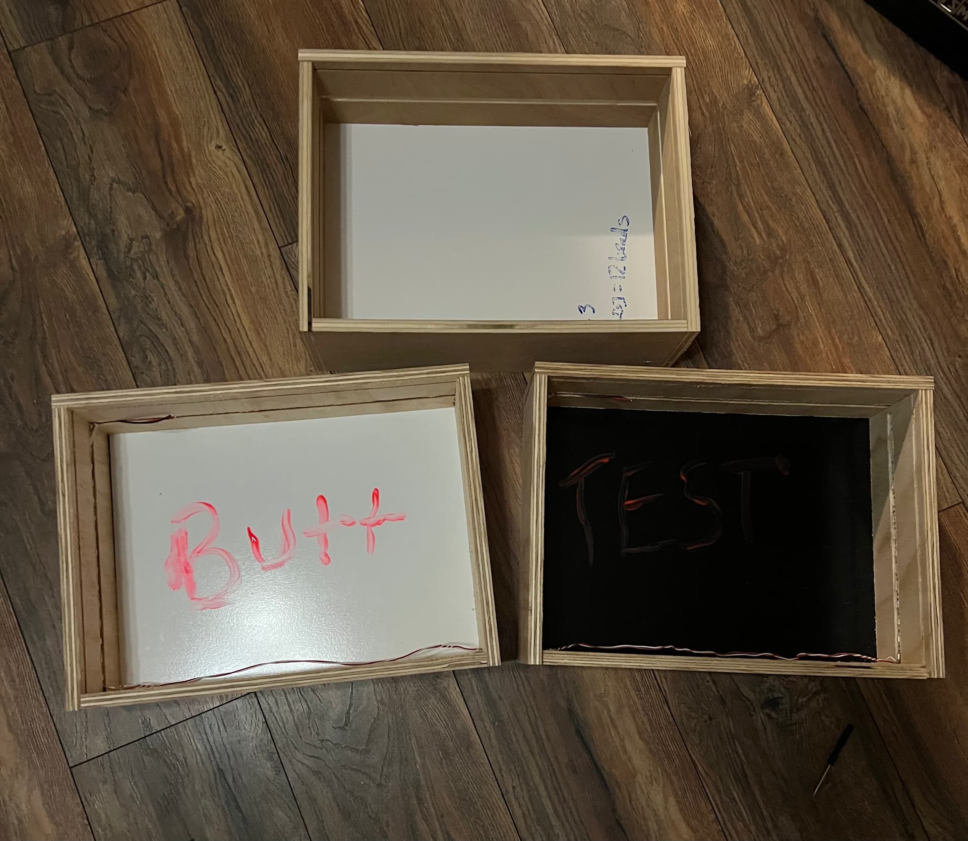

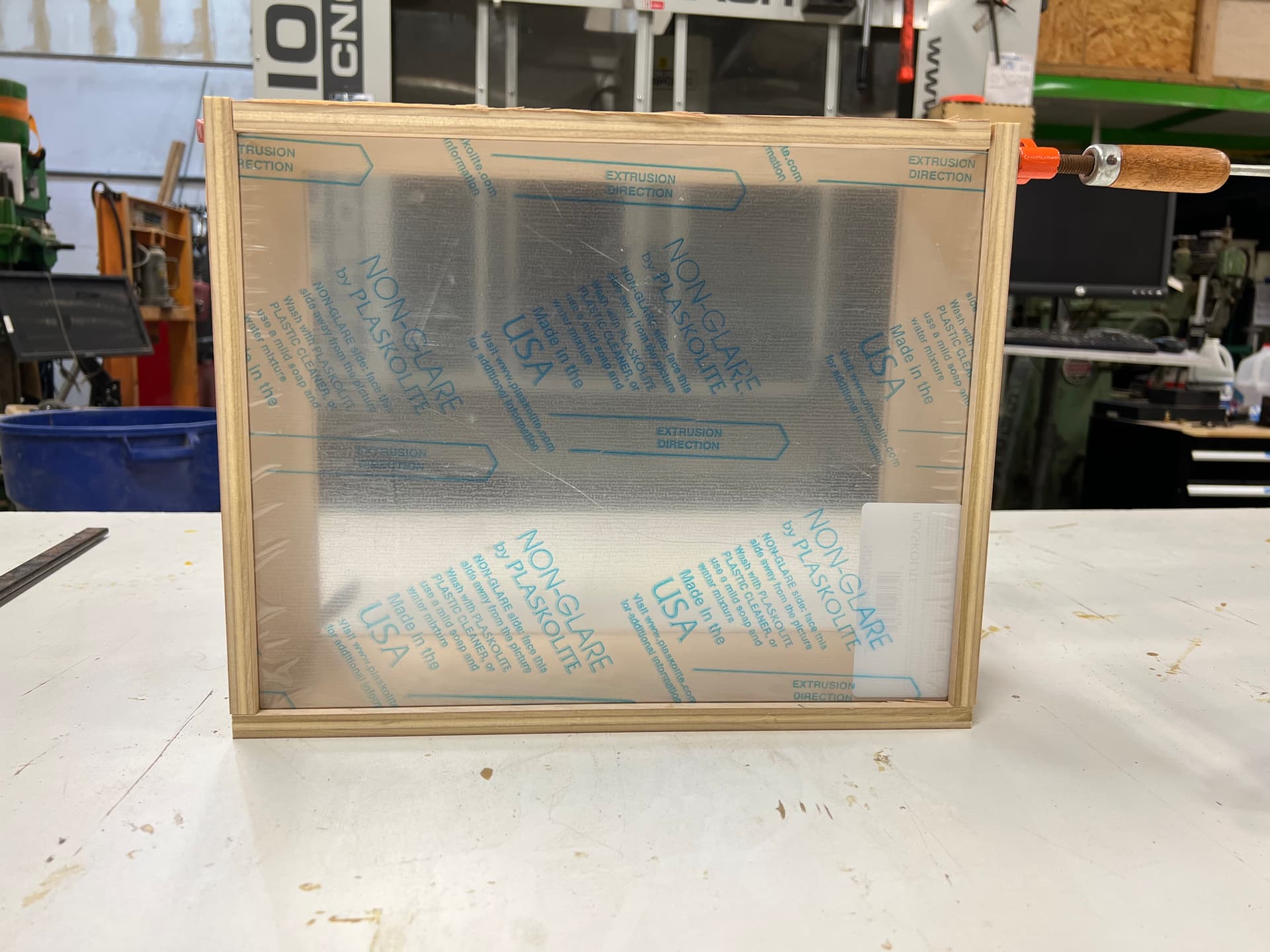

I contribute to Austin’s comedy wrestling scene. Last night was the first ever* Fight Opera show. We needed some light boxes for our announcer’s table:

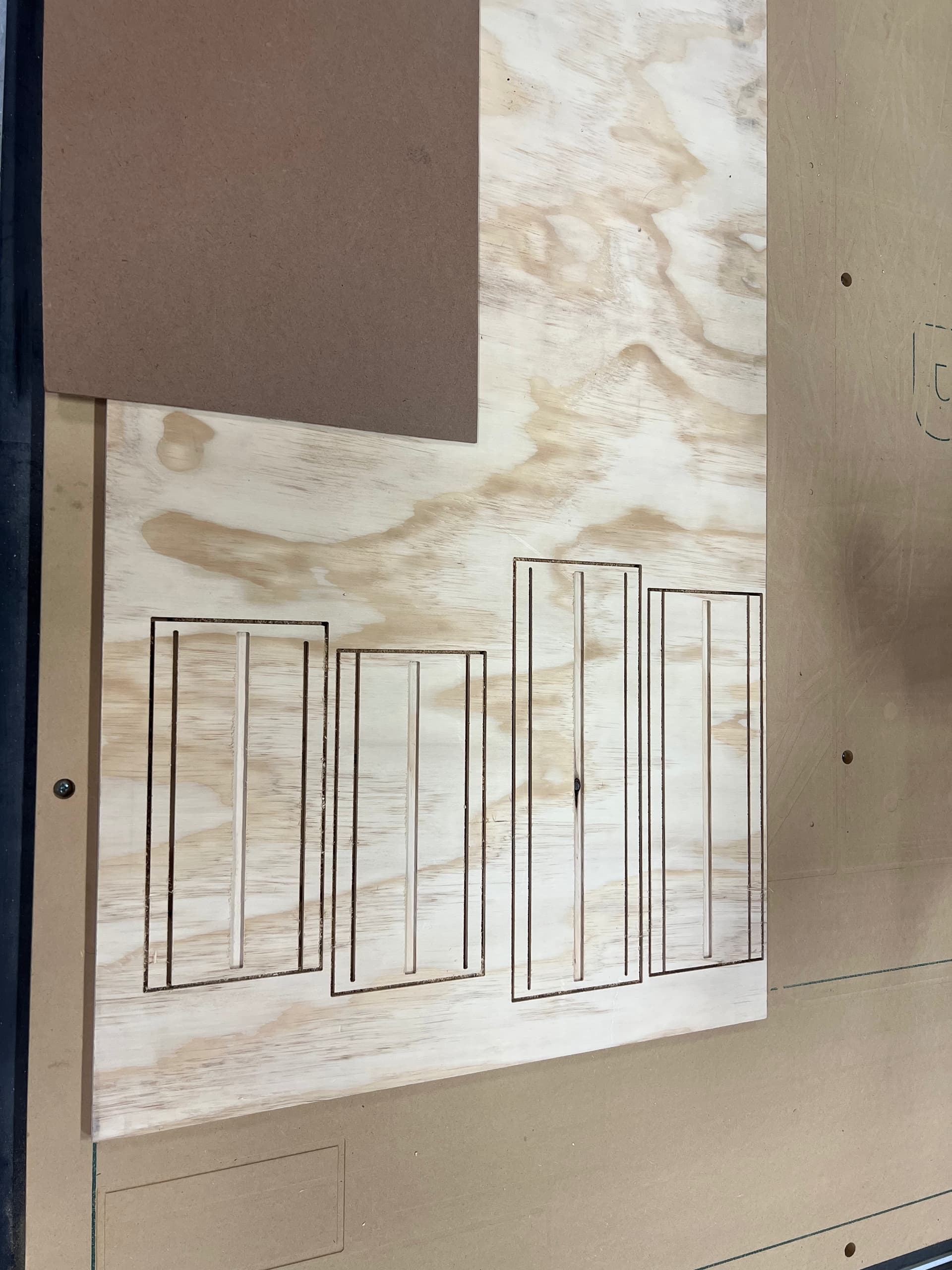

The design I came up with was not well thought out, structurally. My plan to use LED strips in the dados was abandoned due to time.

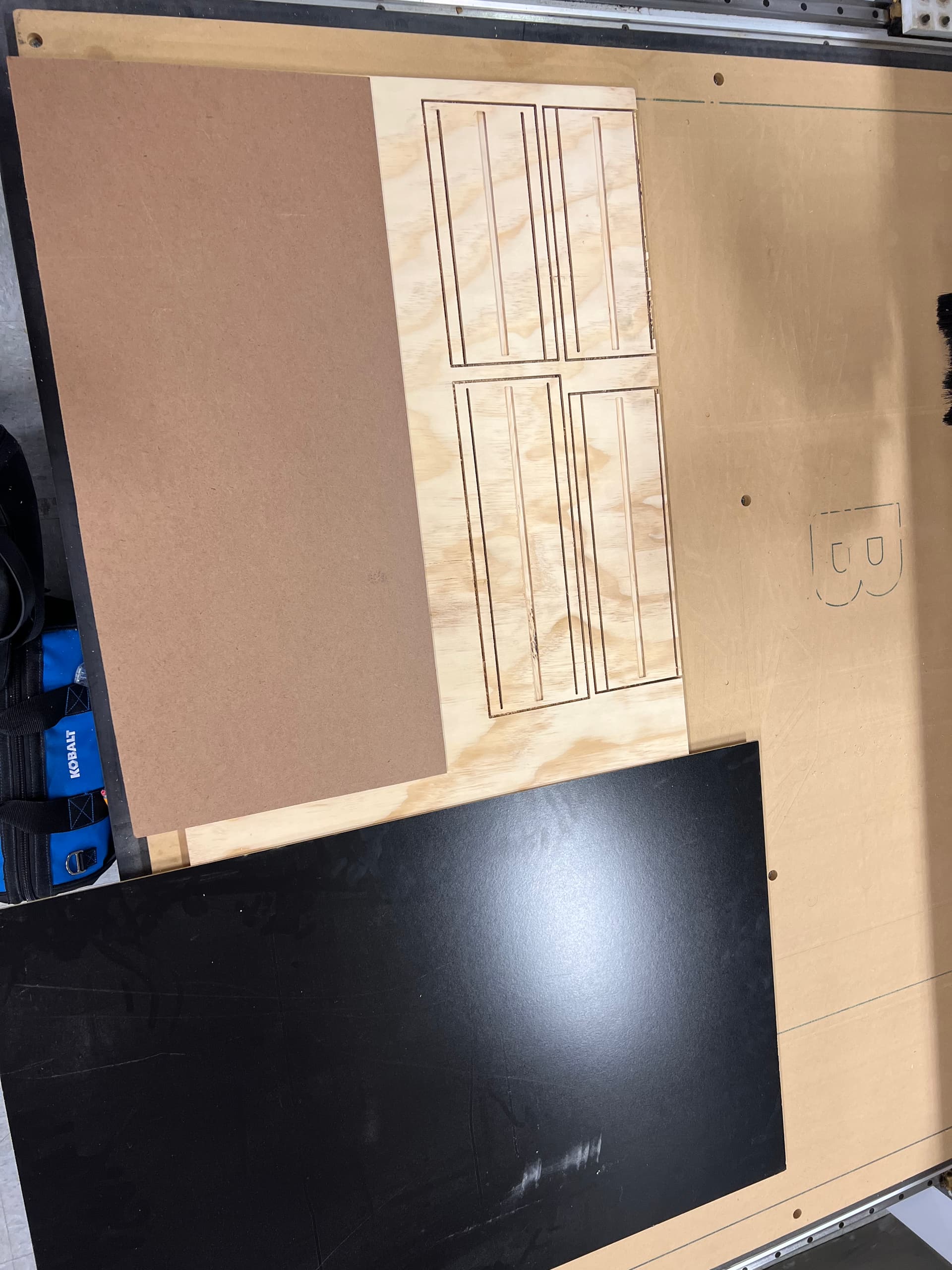

The Swift, on the other hand, was a big success. I had a 2’x4’ sheet. When I cut and removed the four sides of each box I covered the empty space with hardboard*(?) to keep suction from the vacuum bed strong and had no problem with parts shifting.
