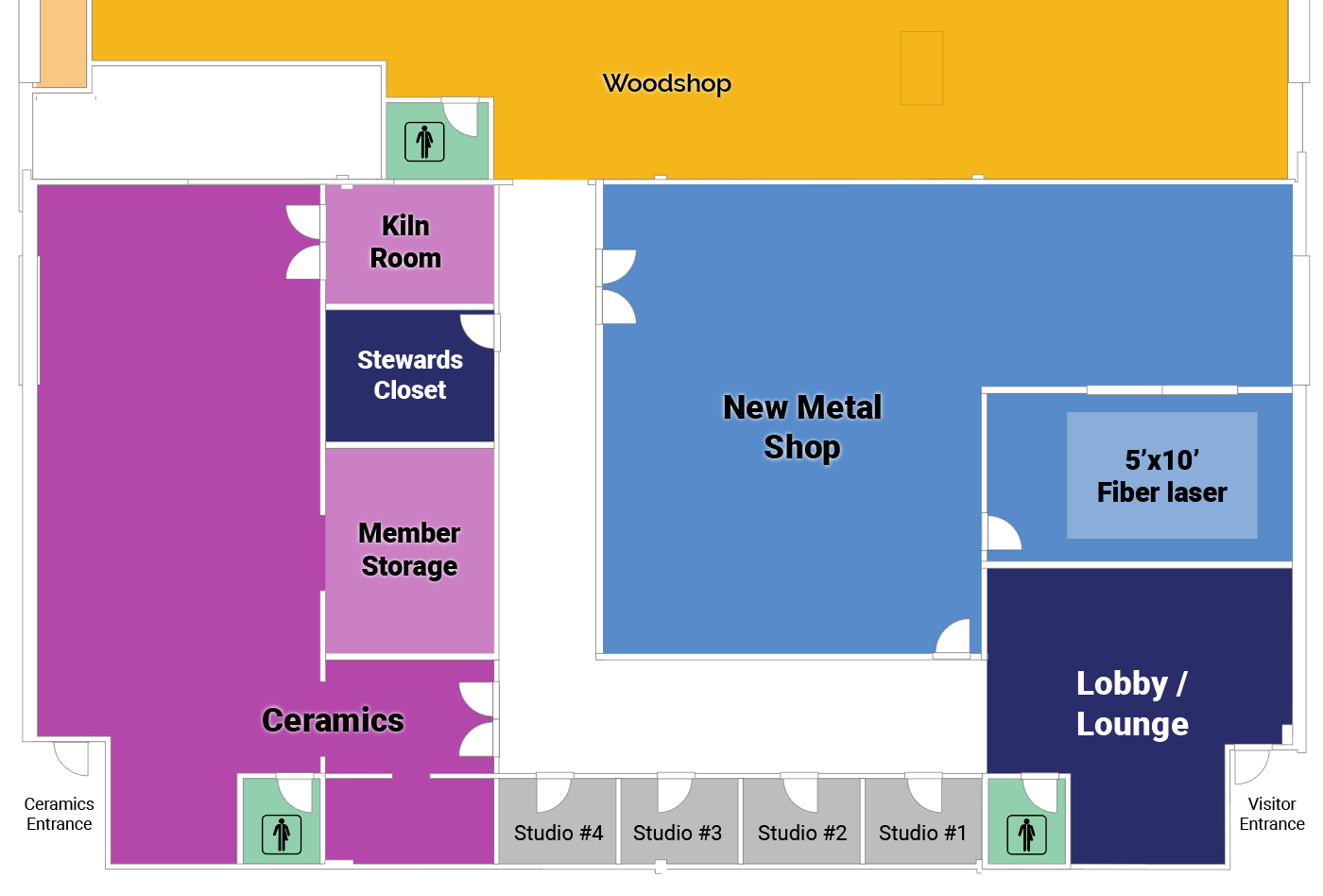

The fiber laser will be positioned next to the garage door in the new metal shop. This will be on the Alta Open/OpenPath system to allow members to open the garage door from outside for easy load in.

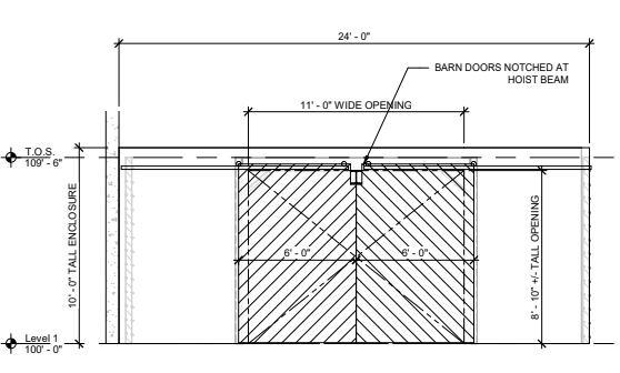

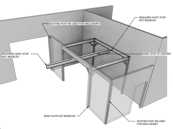

To ensure safety for all members in the shop, the fiber laser will be fully enclosed with multiple openings for optimal functionality. This enclosure will ensure that members in other areas of the metal shop are not exposed to the laser without proper safety glasses (similar to the need for eye safety with welding). The enclosure will have a steel frame designed and signed off by structural engineers. The frame also includes a material hoist that will extend out of the enclosure into the loading zone.
This hoist will assist members in safely moving heavy materials from vehicles directly onto the laser bed through the side barn doors that will run along the long edge of the machine with an 11’ opening to easily accept the largest size materials the bed can accomodate.

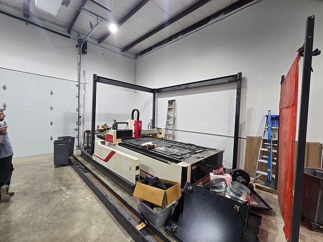

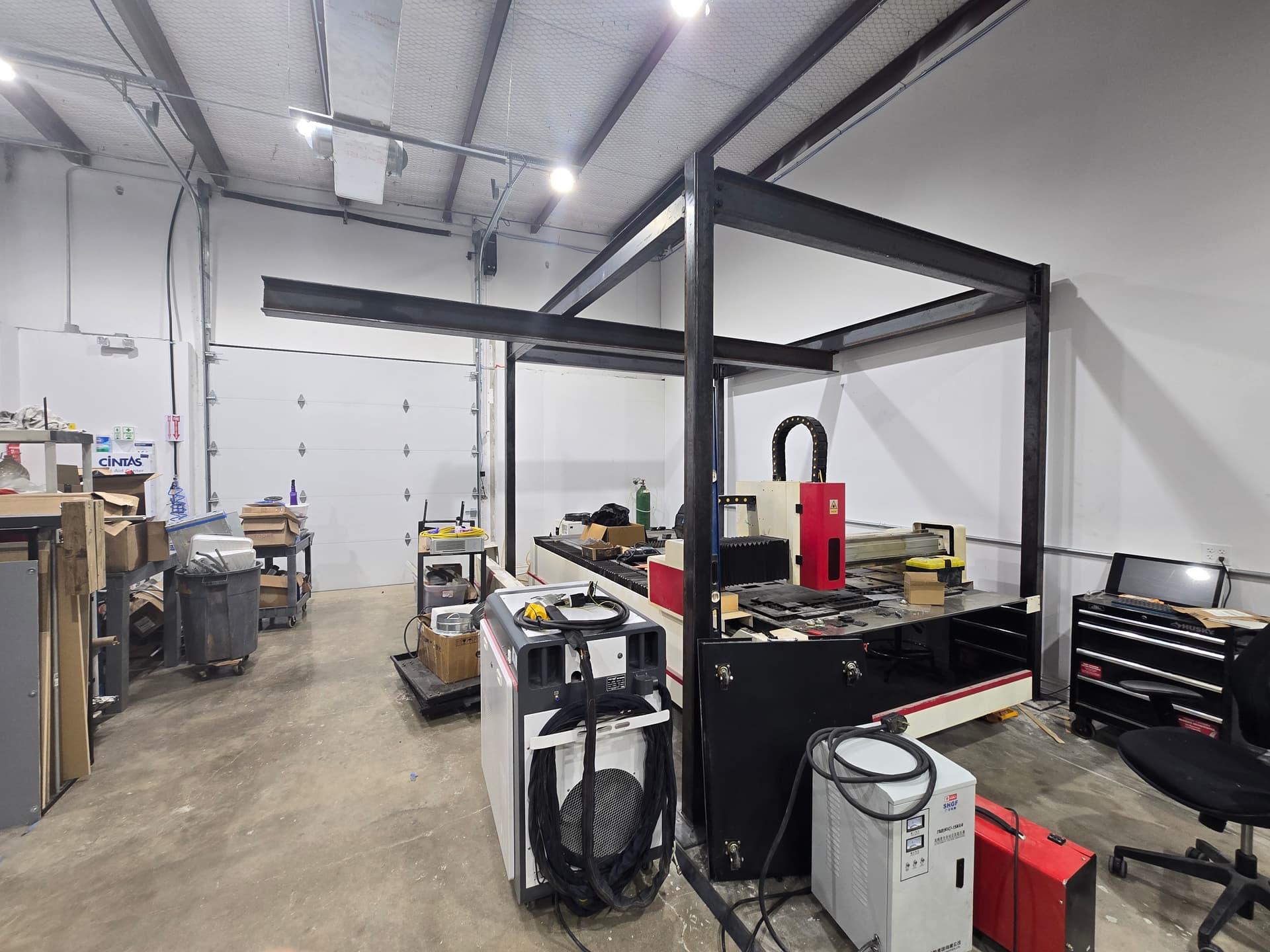

Post and beams are taking shape.

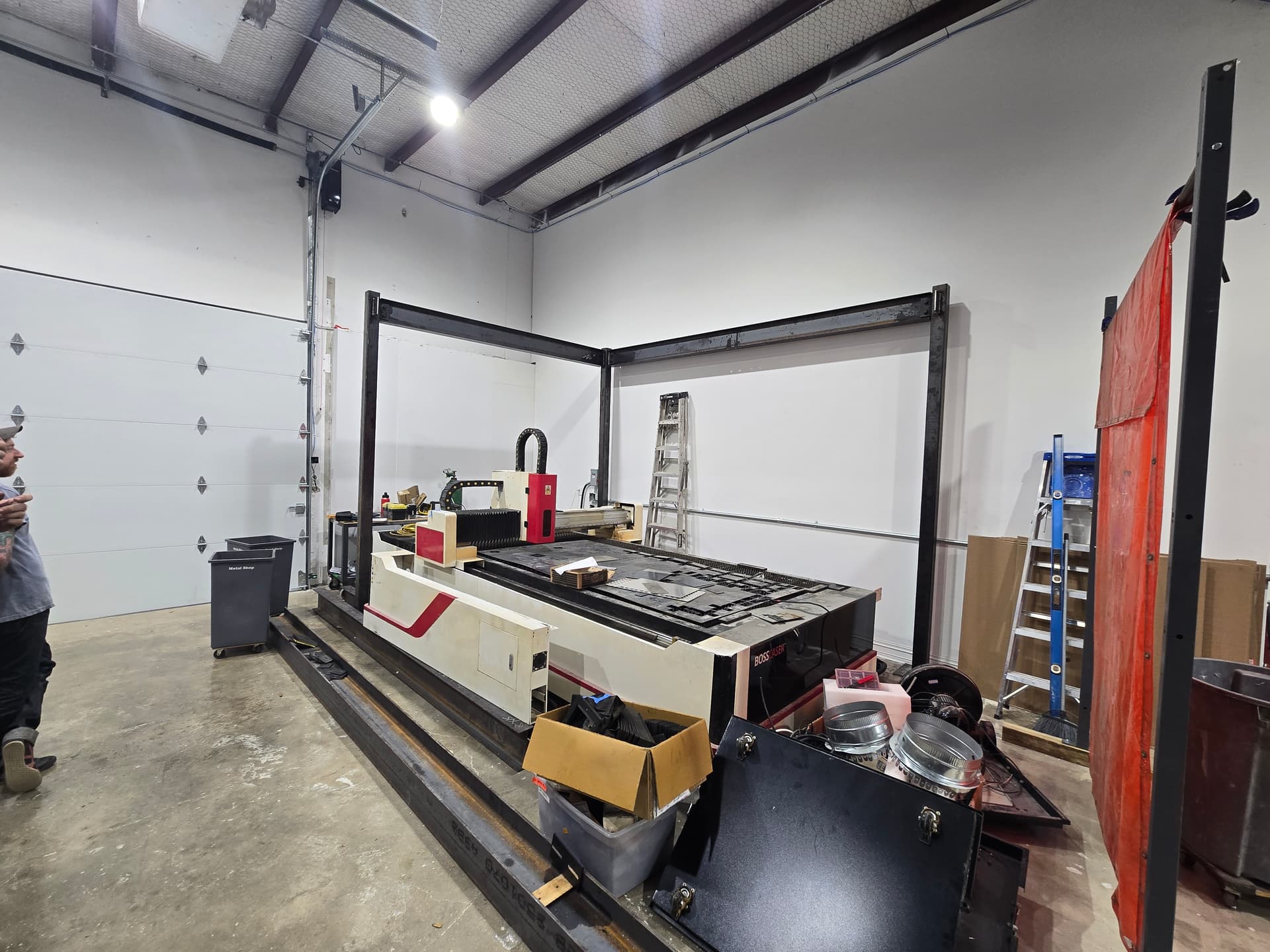

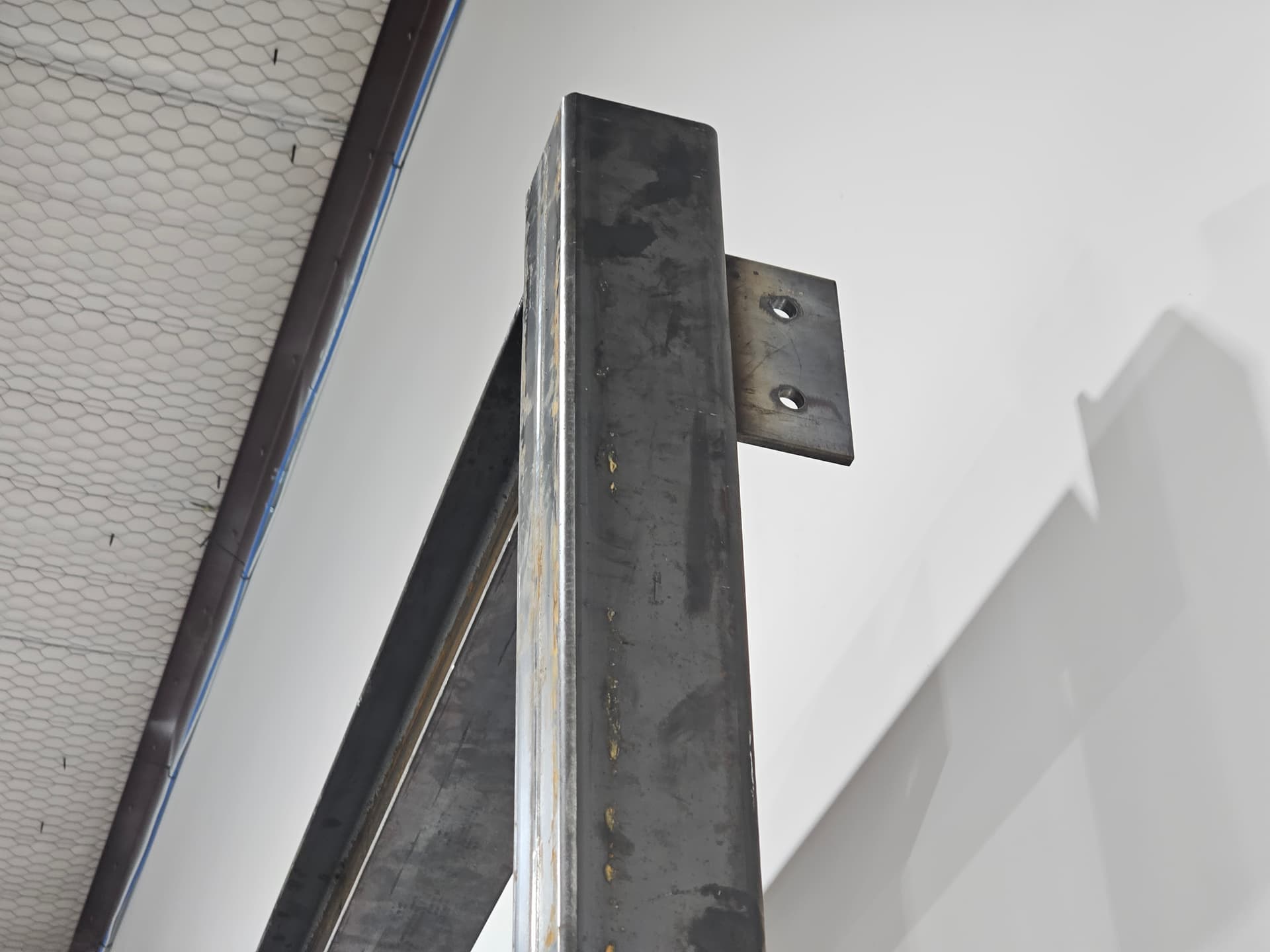

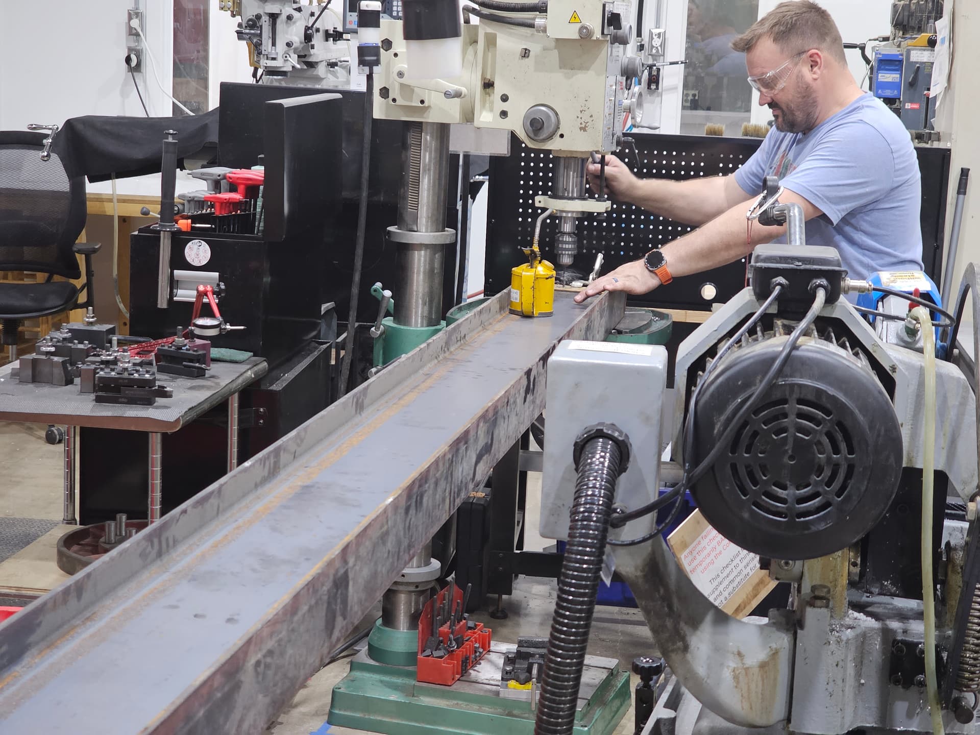

Made some good progress today on the enclosure, thanks to James, Jason, and Kevin for helping to make this possible!
We spent about 10-15 minutes talking over the safest way to lift this stuff up, making sure everyone had their jobs ready and understood, and about 10-15 seconds making sure the bracket went to the proper side. Easy to fix, but I think we’ve all felt the feeling of the second image.

This is an unfortunate setback and something we hope to rectify as quick as possible. During this time we will continue working on the enclosure. The steel gantry frame is up and has minor build left on it. We will begin framing out the rest of the enclosure soon.
Thank you all for your continued patience and we hope to have good news soon.
The gantry is 95% completed including getting the ginormous beam in place.
