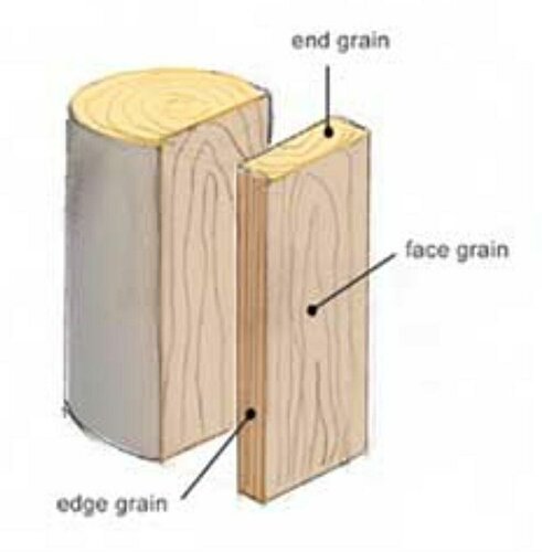

If we compare wood’s structure to a “bundle of straws”, the ends of a board are end grain while the long grain sides are either face or edge grain. The long grain glued to long grain is strong. The end grain glued to anything is weaker. That’s why in joinery we’ll do such things as box joints or mortise and tenon joints if we want strength. End grain to end grain is just plain weak.
