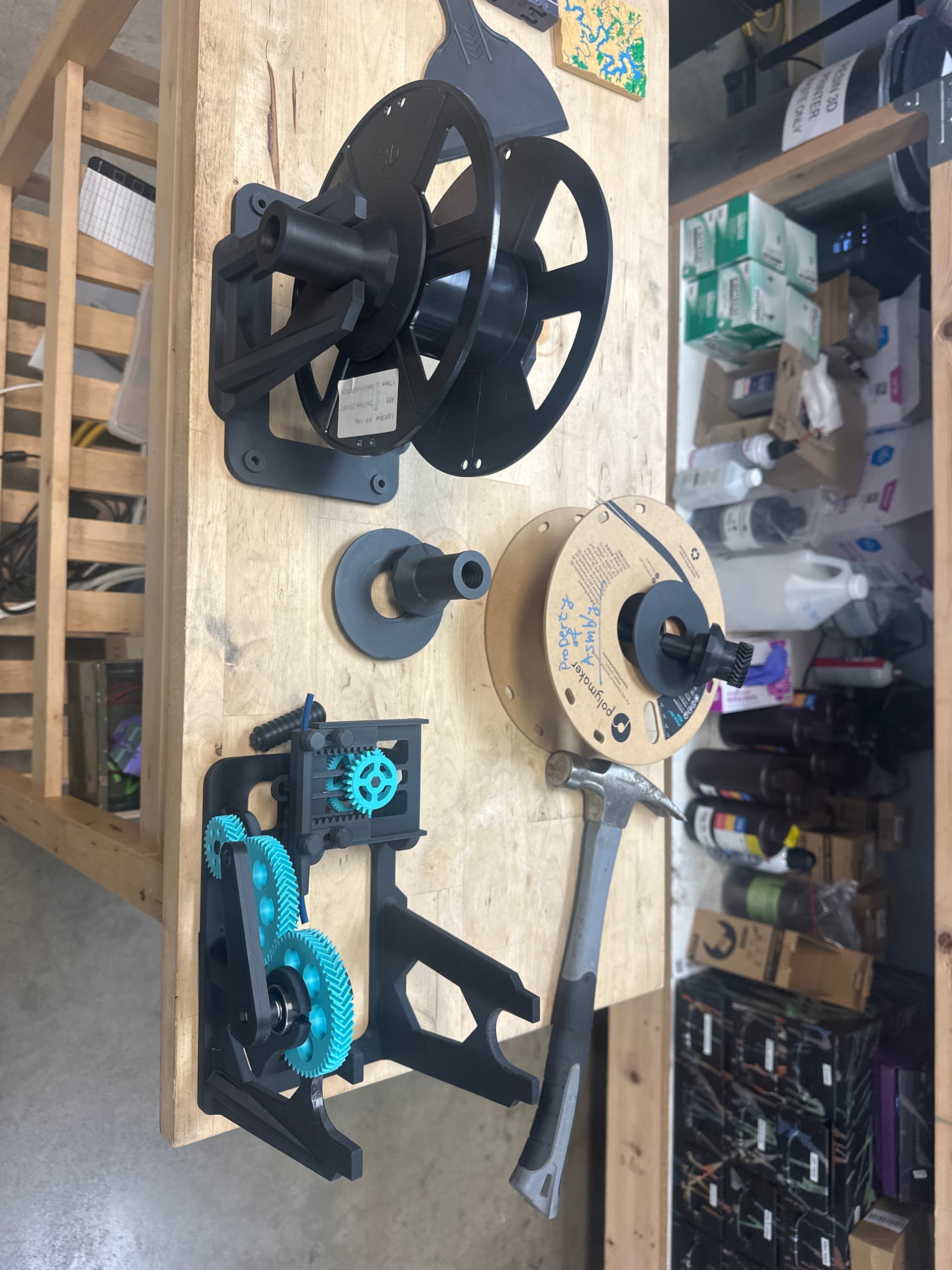

I’ve printed a respooler (and am now printing some ASA parts to replace the PLA parts that I’ve broken), which lets us transfer filament from one spool to another.

Sadly, the respooler is not ready for use yet. I’m going to have to print the carriage in something stronger than PLA.
