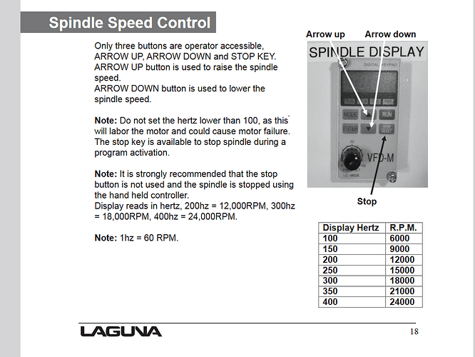

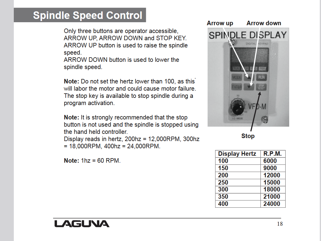

The other important thing I think people forget is that the spindle speeds that you set in VCarve have no effect on our CNCs, so people will design their toolpaths and setup their cuts thinking they’re using a low RPM, but the spindle is actually spinning at 21,000rpm.
From the IQ manual, you must set the spindle speed on the VFD itself. 100hz/6000rpm is the lowest it should go, according to the manual. Perhaps 6000rpm would be slow enough to get decent results, not sure about that.
Please correct me if I’m wrong and you can set it in software, but this is what I remember from class a few years ago. @jamesfreeman or do you know @Rolo ?
