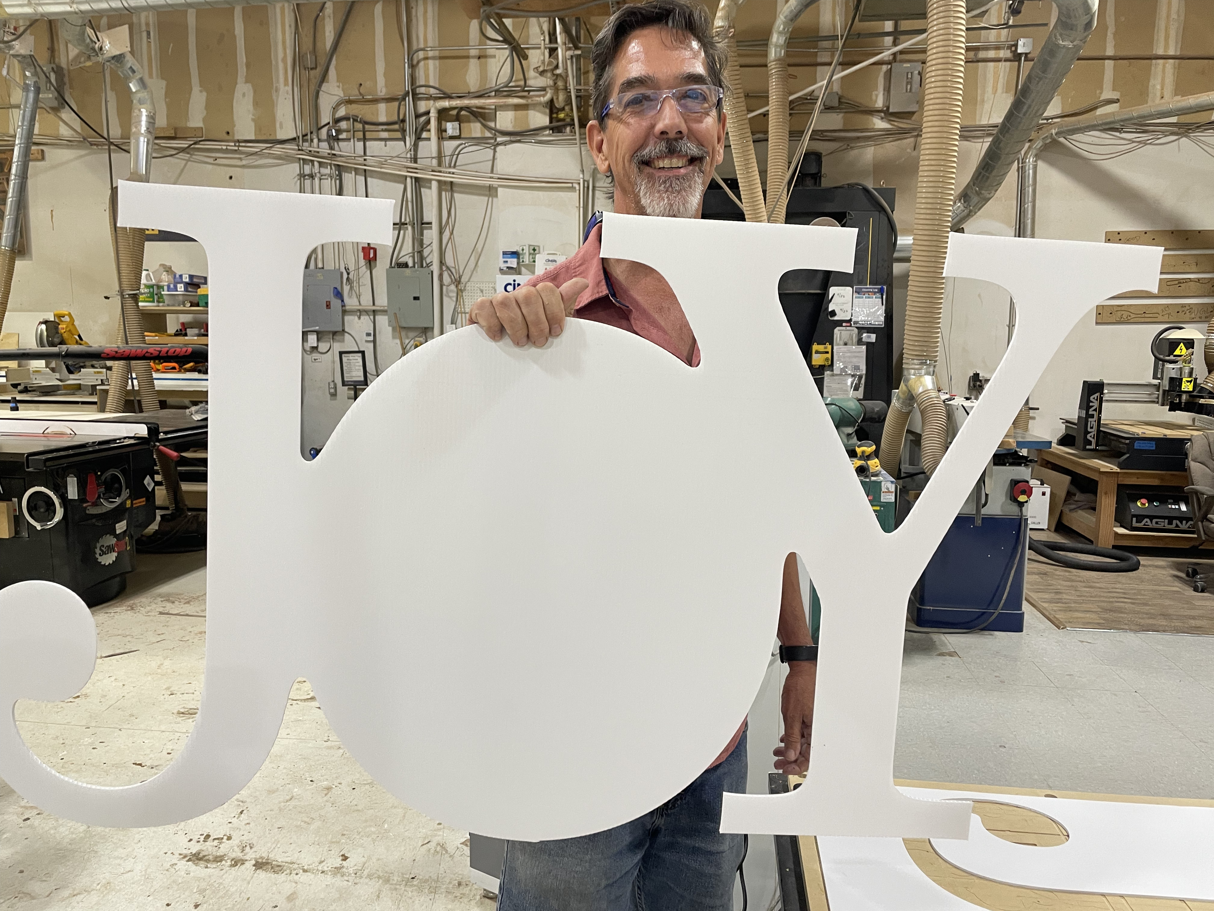

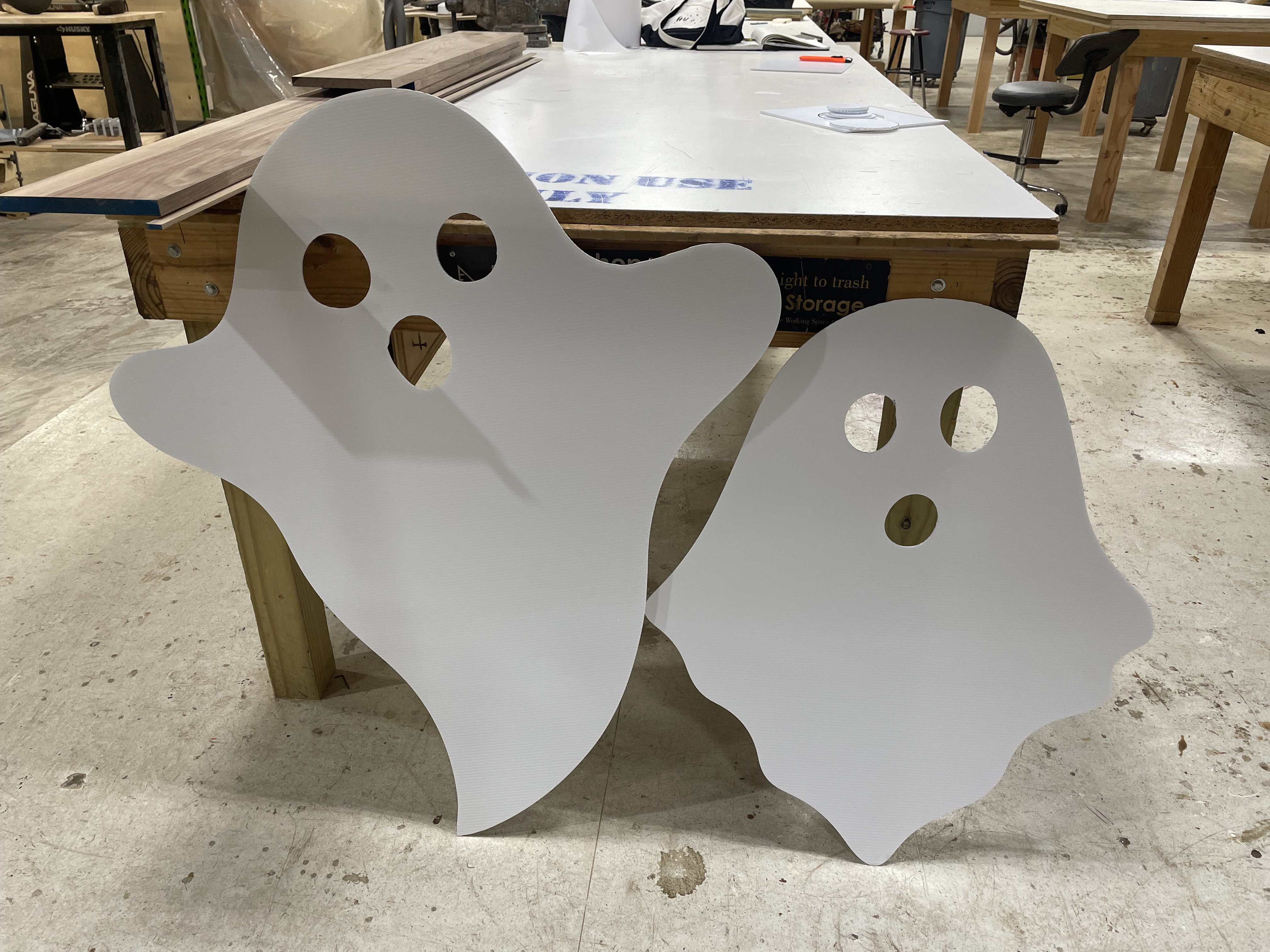

Fun was had by all who attended, @clayD@Kasper and @bwatt. When I arrived Clay had already put down his 4x8’ sheet of coroplast on the large CNC. First Clay brought a custom pen attachment which we used to test out the CNC path. Clay had already created a toolpath using the VCarve drag knife gadget so he tried that first successfully. Next he cut out two ghosts also using the gadget generated toolpath too. Finally on “JOY” he shifted to a standard VCarve profile with ramped lead ins, and drag-knife corners. Both approaches worked just fine, yet some small places had to be hand cut afterwards. We were cleaned up and done by 9:00 PM. P.S. We might have left the spindle speed set to 0.0 instead of its normal 300.0 - if you in early on Saturday and could check and adjust it that would be helpful.
