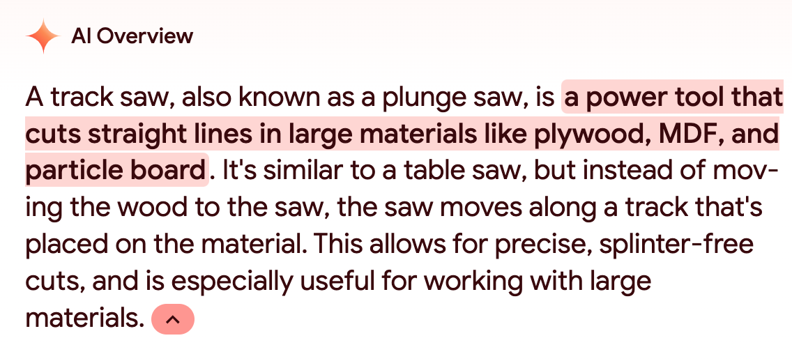

Adam has provided many great answers. The panel saw would be excellent to cut down panels to a rough size before proceeding. Then table saw or track saw would be the next best choice. I’m leaning towards the track saw being the best option. Easy to use and best for angles on plywood.
