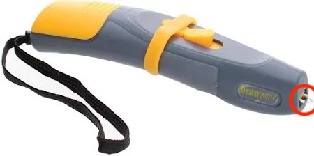

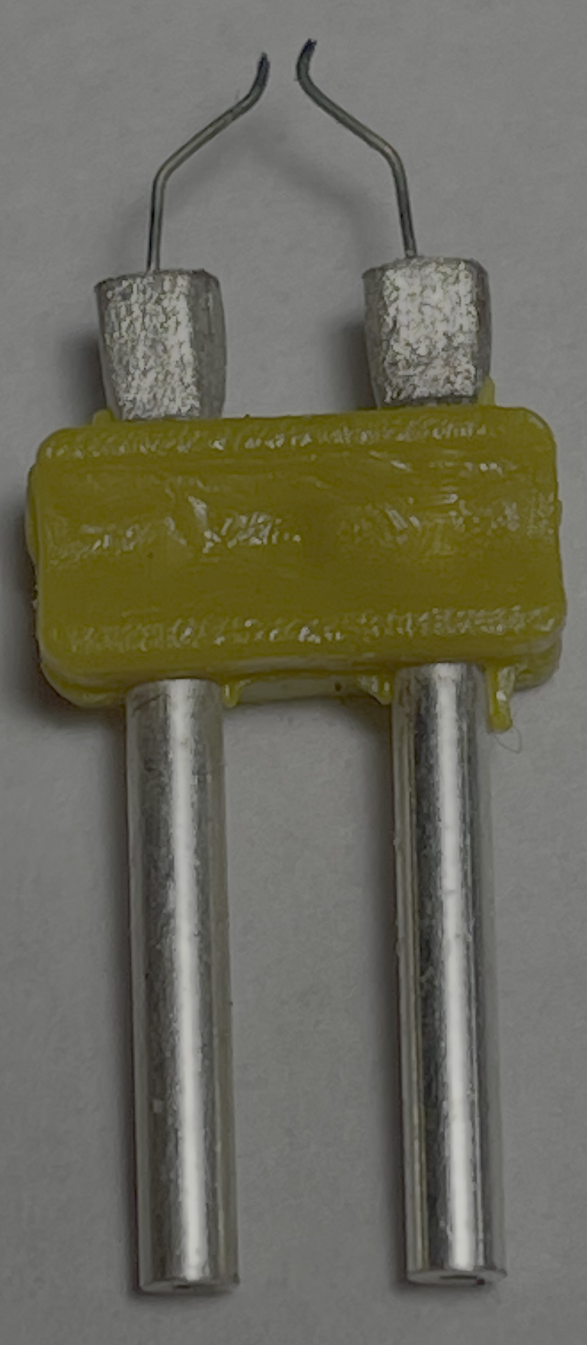

I’m trying to make a bunch of tips for a BeadSmith Thread Zap for melting bead filament. Note the broken nichrome wire in the bottom pict.

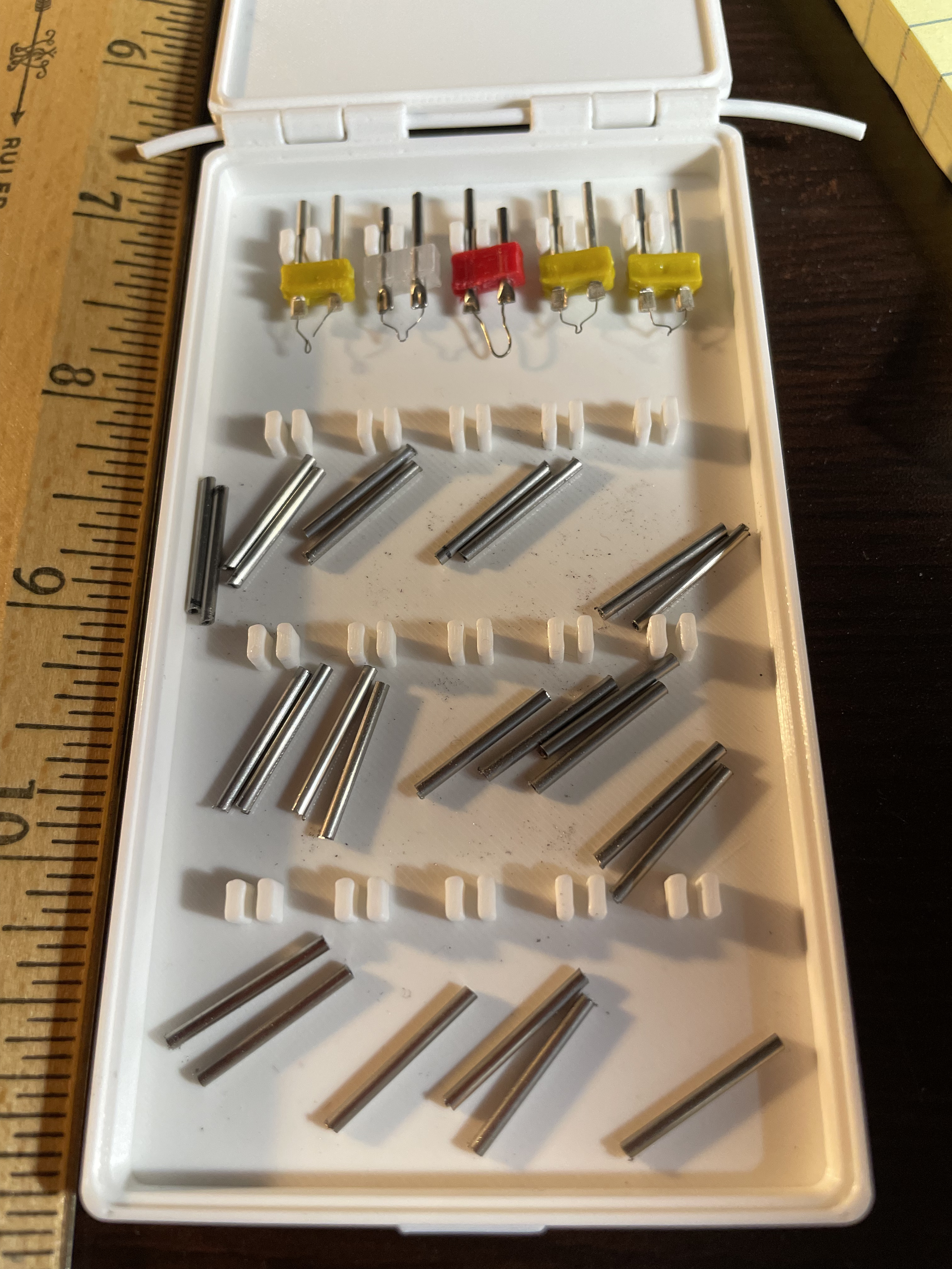

Evan (@ewei), Thank you for loaning me your jewelers saw. It made easy work of cutting twenty-six 1.5mm diameter by 16mm long stainless steel capillary tubes. However, I did break two of your 2/0 saw blades. So I’ve ordered you some more as replacements and they’ll be arriving in nine days from Amazon. I’ll be putting your saw and its blades today on the lost & found shelf in the your original red-orange bag. When the replacement blades arrive I’ll contact you again and set up the transfer at Asmbly. Now I’m on to making some Thread Zapper tips with them. Thanks again, Bri
I’m so glad it worked Brian, and I’m impressed you only broke two blades. They’re so delicate—I feel like I usually go through two per minute
Thank you for generously replacing them as well, please keep us posted about the finished products!
