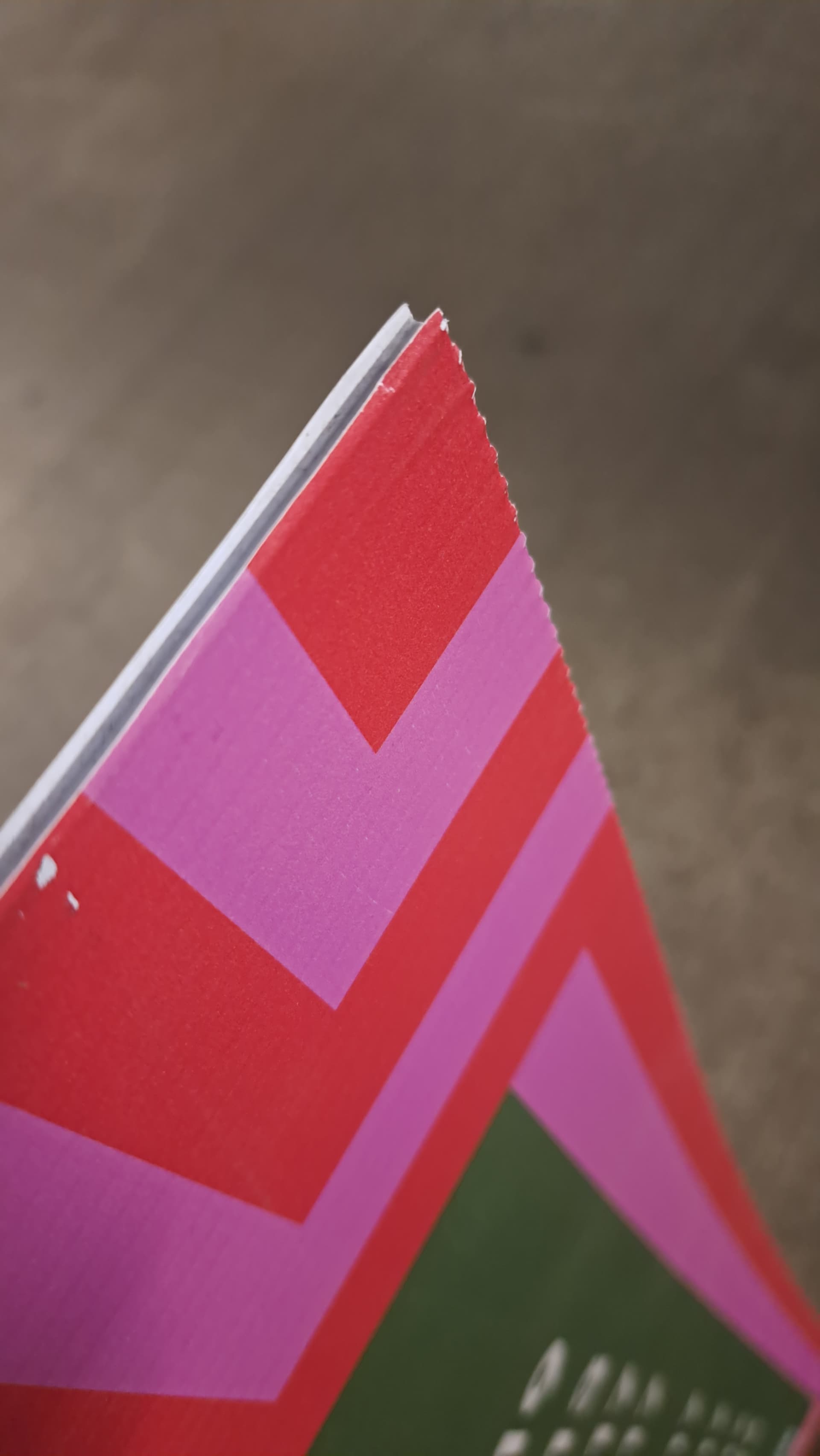

Hi all,

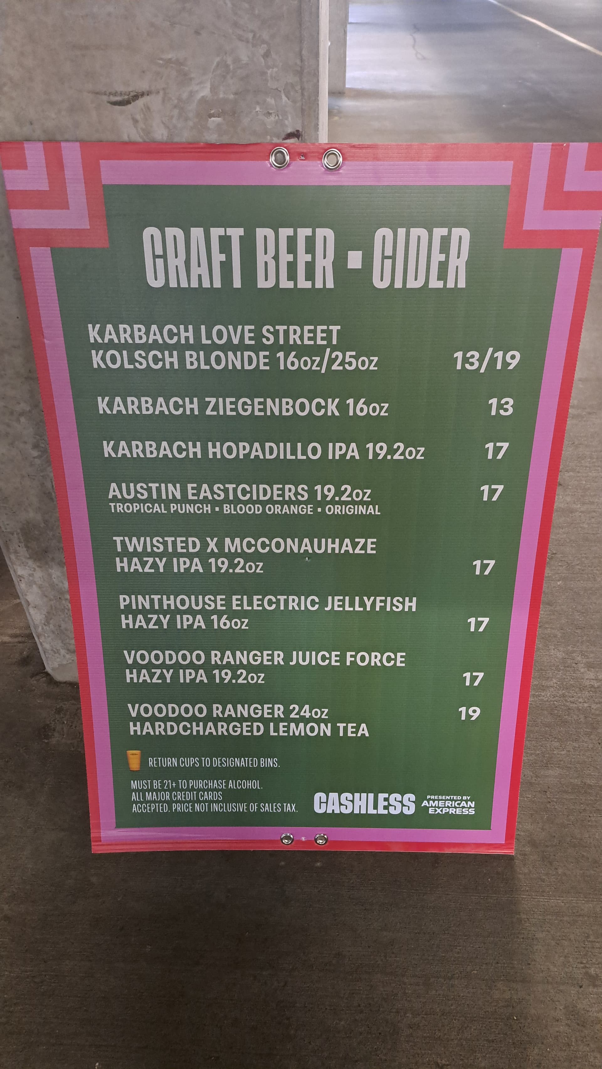

I’m helping a friend in reusing a number of corrugated plastic signs as material stock for public artwork. Think yard signs, although these were salvaged from ACL, which are typically made of polypropylene. I thought about putting it on Tarkin but given that I don’t know the exact composition, I thought I’d ask if anyone has tried anything similar – you can see images of it below.
I imagine the general rule is “if it’s a mystery material, don’t risk bad fumes” but thought I’d check. And if you have ideas on how else I could cut it efficiently, I’m all ears (and not CNC certified, unfortunately).

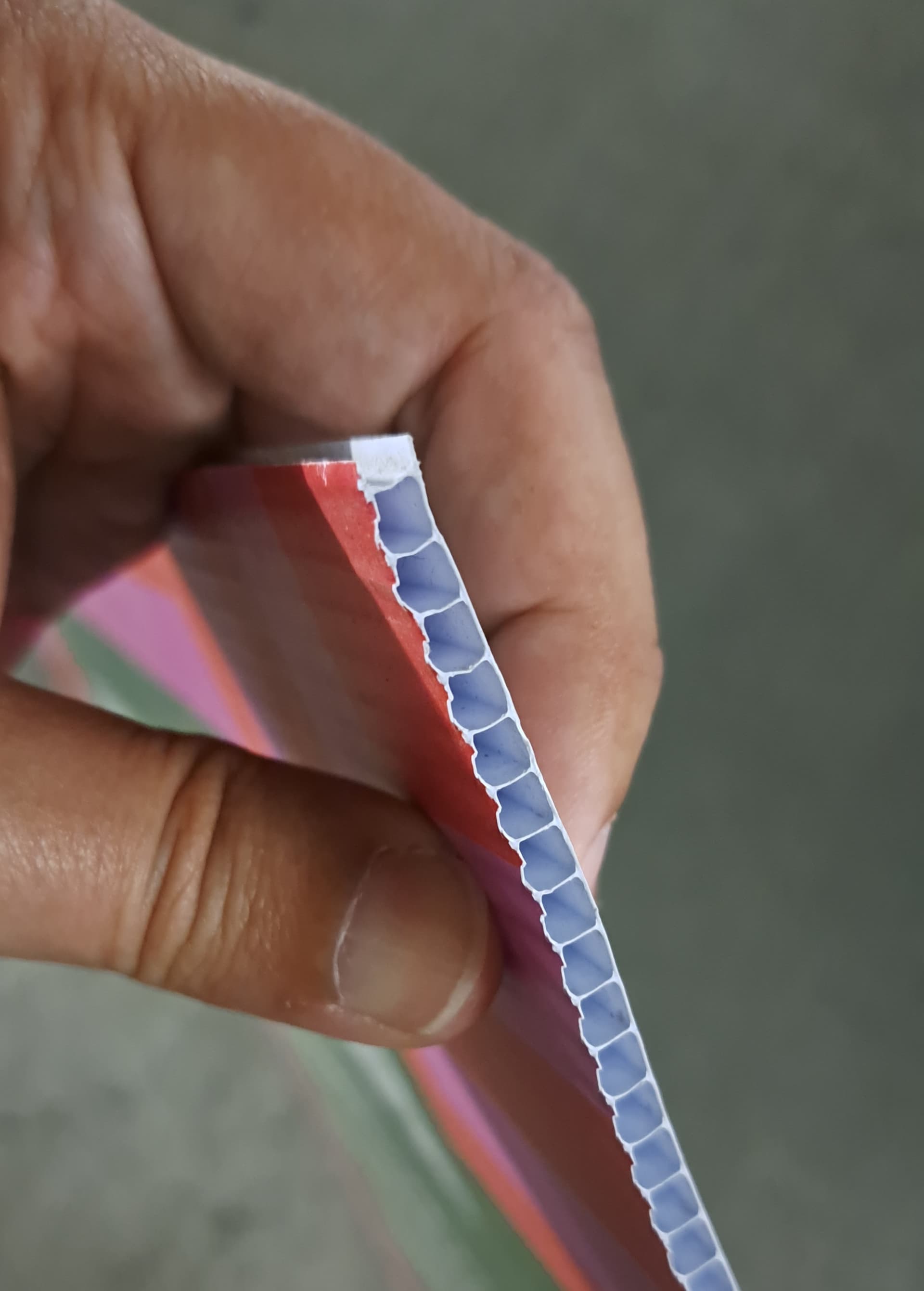

It’s ok to cut, but it doesn’t cut all that easily. The air gap inside means it can’t form a channel that captures the beam. So it won’t be in good focus for the bottom surface.

I say “reasonably well” because I had to try gluing together edges and that was… tricky. The plastic is 99% air in the cross-section so relying on the tiny surface area was extremely optimistic. If I were gluing together flat surfaces I’m sure it would’ve worked even better. It’s just expensive :upside_down_face:
