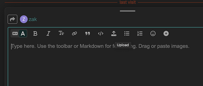

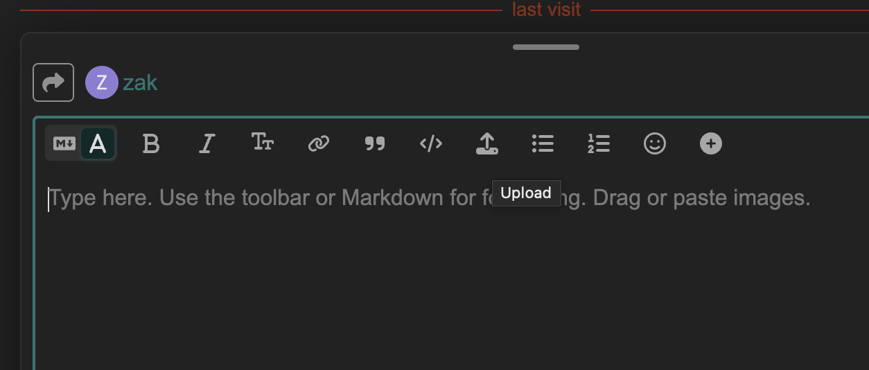

There should be an upload button between the code block and the list. Yes please send a photo. I’m not sure what’s wrong with it. We get a large number of problem reports across the building but all of them don’t actually get reported. Not saying either is the case, but at the moment I’m having trouble seeing details on it.
Yup when I press that button it successfully uploads but won’t let me send. I didn’t inspect it to see what was wrong, but it was red tagged and it said broken. If you’re going to be in the shop today or tomorrow, It is on the bottom rack of the left tool shelf (assuming your back is to the garage door) near where the sanders are kept on the tool rack.

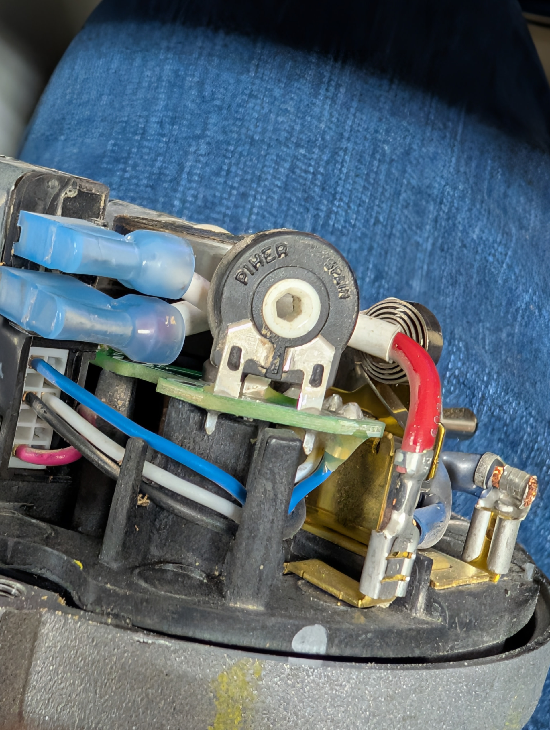

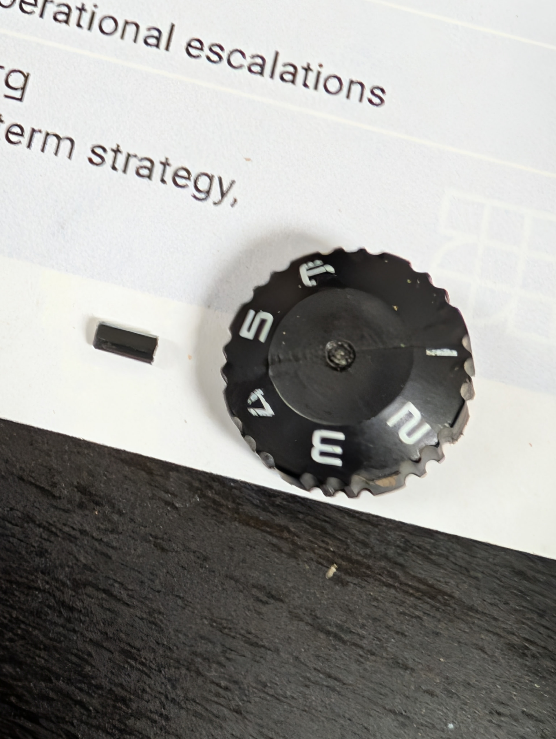

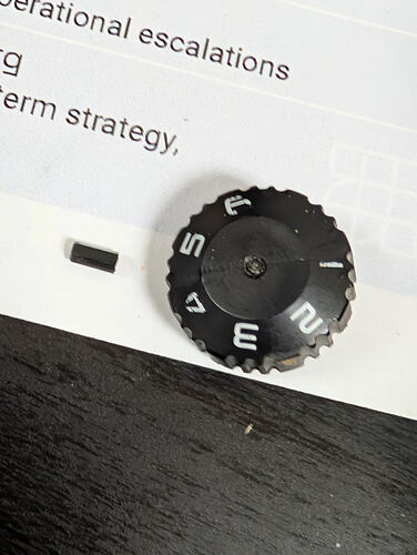

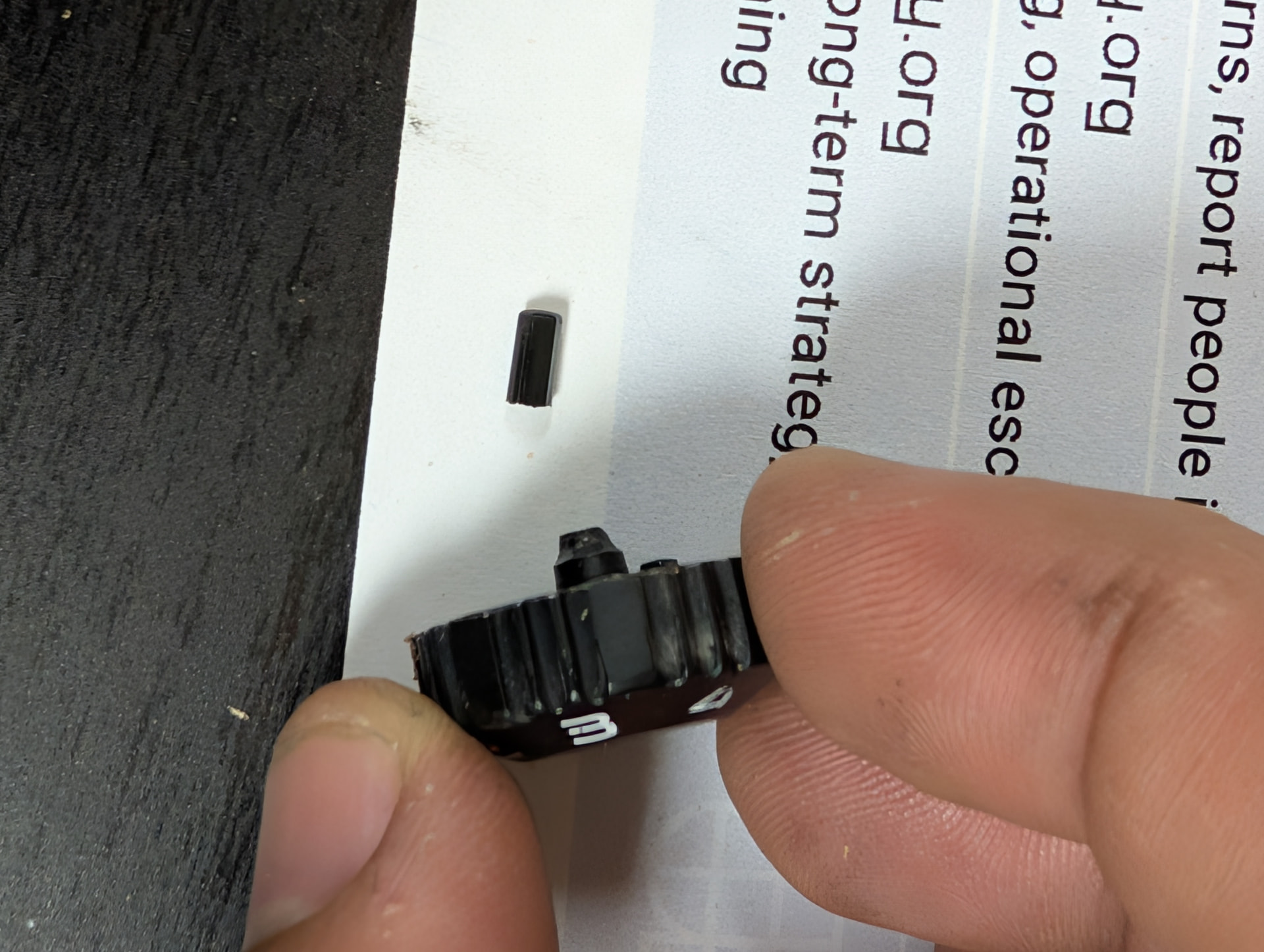

Onto our larger, corded DW618 with the plunge router base. The base is fine, and I got the router to turn on, however the dial is broken and the speed can’t be adjusted. I’m having trouble finding this exact part to order for replacement. It would be a shame to recycle this whole tool just because of that dial. If anyone with a 3D printer skill wants to give it a go, I’m happy to hold on to this for a bit in the gray stewards cabinet (by the office).

Couldn’t you just superglue that speed dial?
Considering a few other plastic pieces I “really” made sure was super-glue secure all eventually broke anyways, I’m a little reluctant to try that. Maybe I’m a bit paranoid; I envision someone turning it just a bit too hard and then mildly panicking when they can’t turn it down.
I’ll see if I can create a model for it
@Rolo Amazon’s price for the same unit is $100 cheaper.
I’ve had a hard time with printed shafts like that breaking. One trick that I’ve recently figured out is using a screw as a reinforcement. I have just been printing the thread, not bothering with heat set inserts or anything. As an extra bonus, you can print the round part flat and the shaft flat as well, getting the better orientation for both.
Like this: Angle Grinder Disc Holder - Reinforced by aneel | Download free STL model | Printables.com
